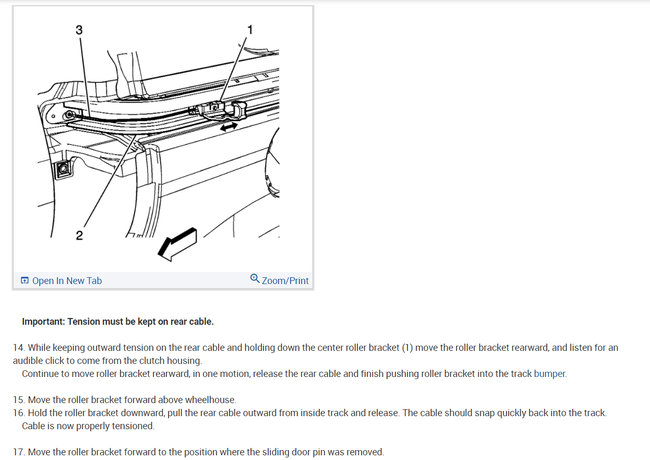

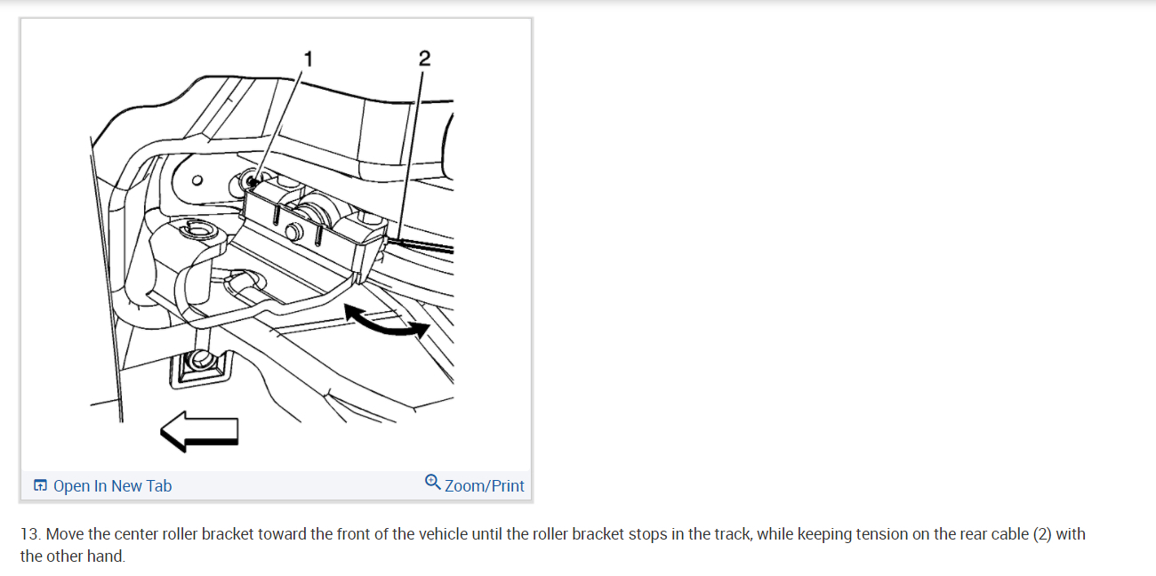

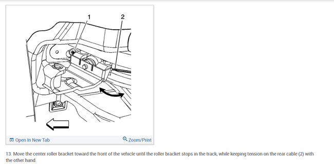

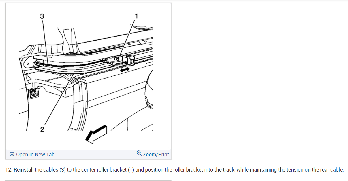

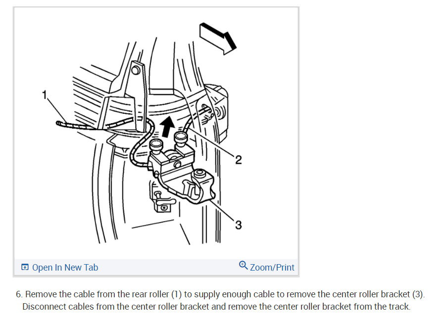

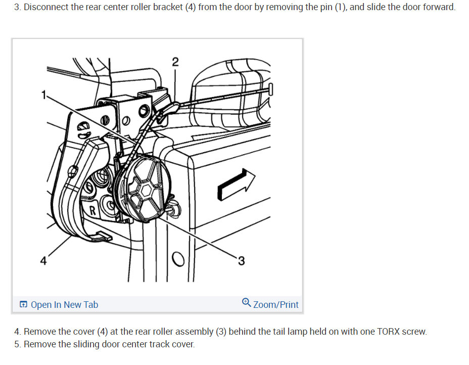

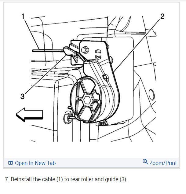

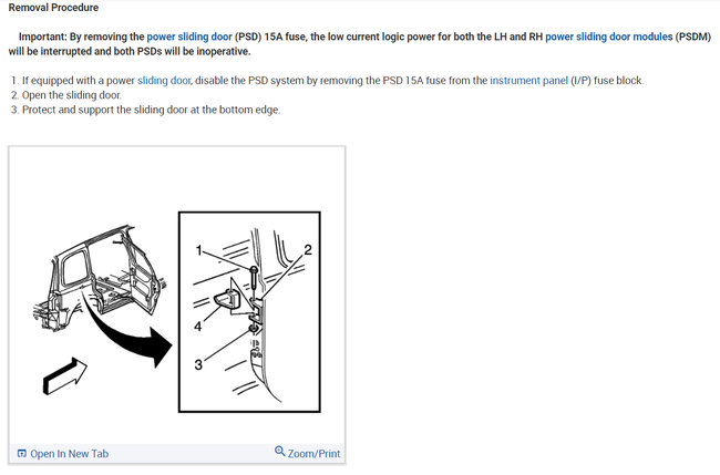

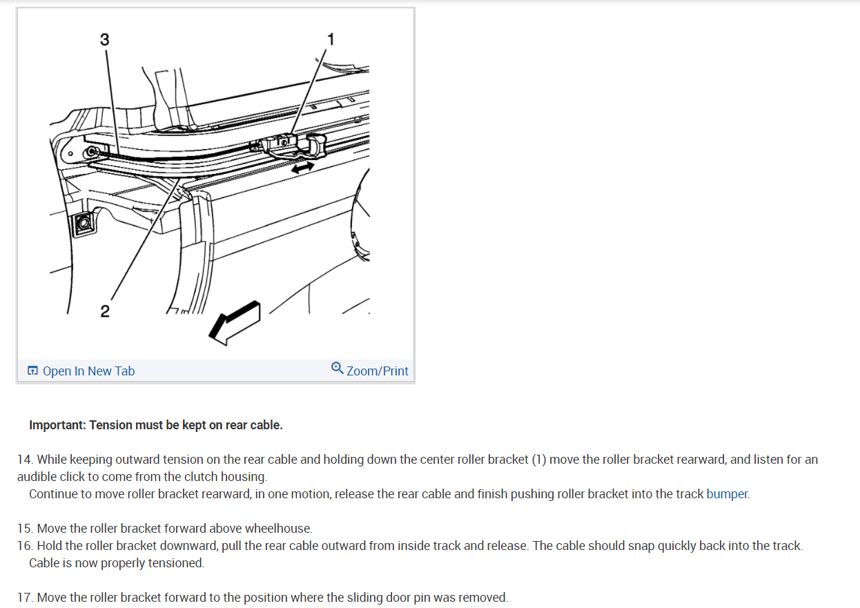

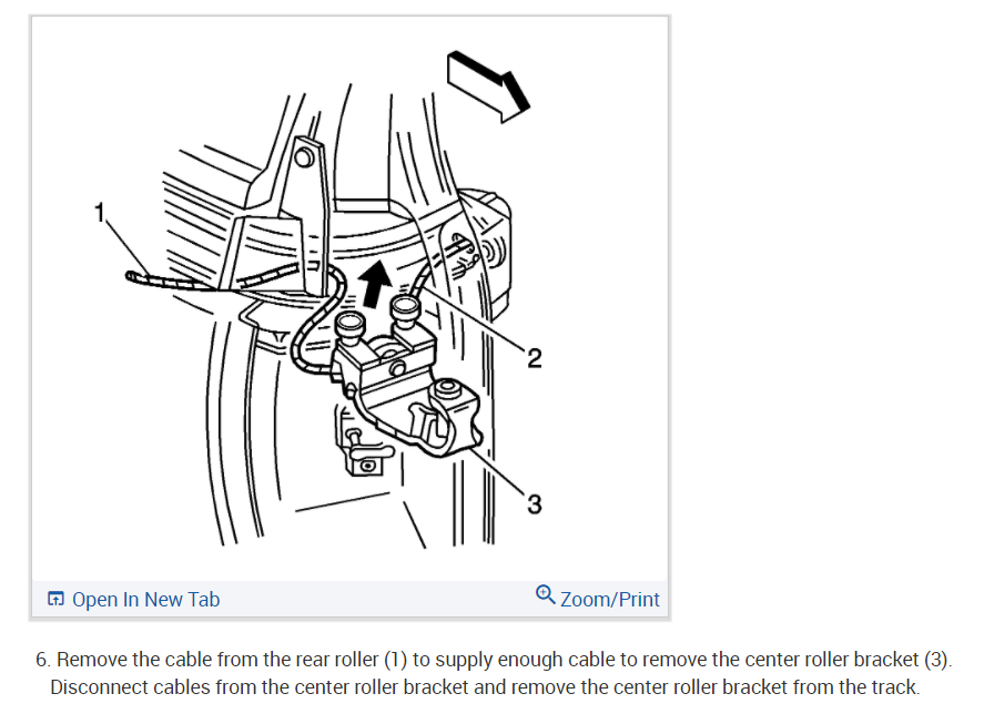

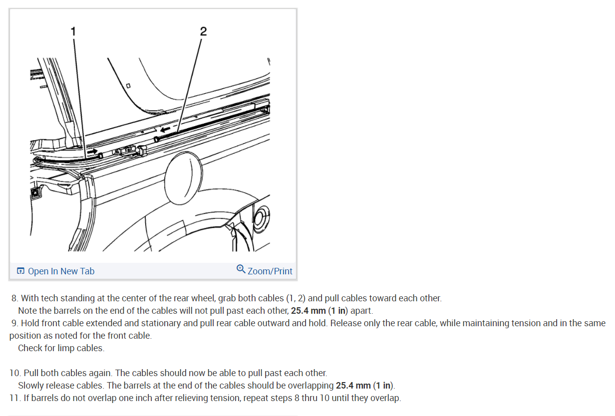

DENNYP
  • 1,824 POSTS
First, reset the cable tension for the power door actuator. Also, check the center roller assembly on the door to make sure it's not bent. If it's slightly bent, replace it.
