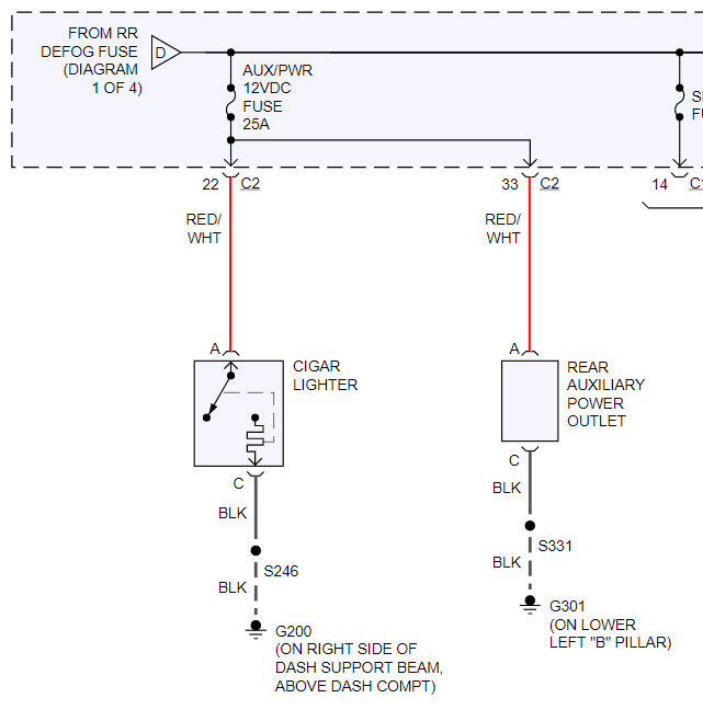

We have had constant electrical problems with this van. Currently the battery will drain down if the van is not run for 10-12 hours. I have found that if I pull the Auxiliary Power Fuse (Fuse 23 in the under hood fuse box) this does not happen. What is connected to this fuse and is it okay to drive the vehicle without it? I am currently replacing the fuse every morning and would like to leave it out until we can track down the problem.

Is sounds like you have a bad lighter feel the unit to see if it is hot? There is only two sockets this fuse powers see below. Check out the diagrams (Below). Please let us know what you find. We are interested to see what it is.
Feb 4, 2008 at 7:51 PM
BROOKE163
Thank you for this post, I had this problem and the lighter was HOT had to get a new one cost me $34.00 all fixed! I love this site.
