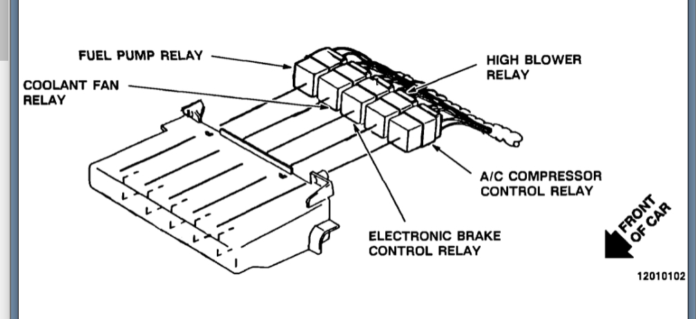

engine turn but not stat. no fuel in the injectors line. I think it's the relay ,i don't know the location. Please help. thanks'.
May 23, 2009 at 7:42 AM
CERTIFIED EXPERT
18,907 POSTS
You may be correct and that is a great place to start. Here is a guide that will help with testing the relay:
Also, to confirm this is a fuel issue you could check the fuel pressure as well.
Here is a guide that will help with this as well:

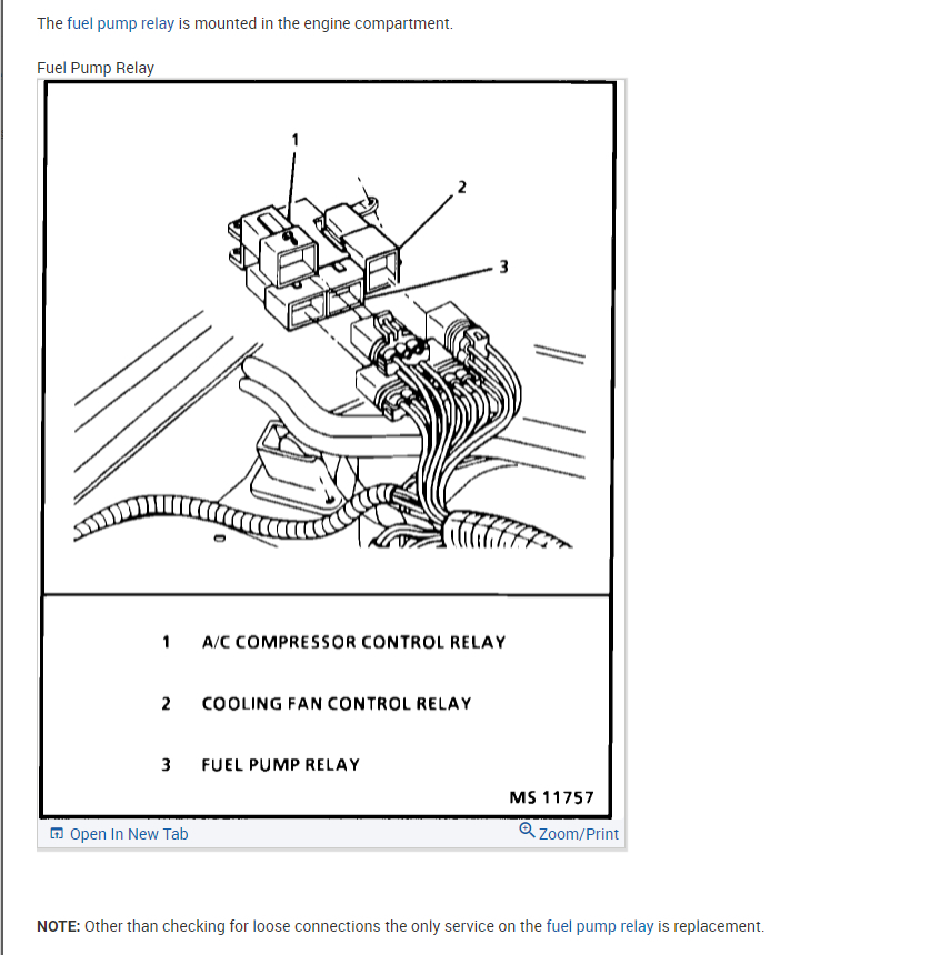

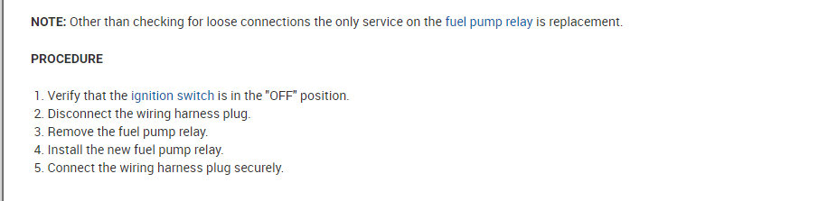

Below you will find the location and process on how to replace the relay. Please run through this and let us know what you find. Thanks
