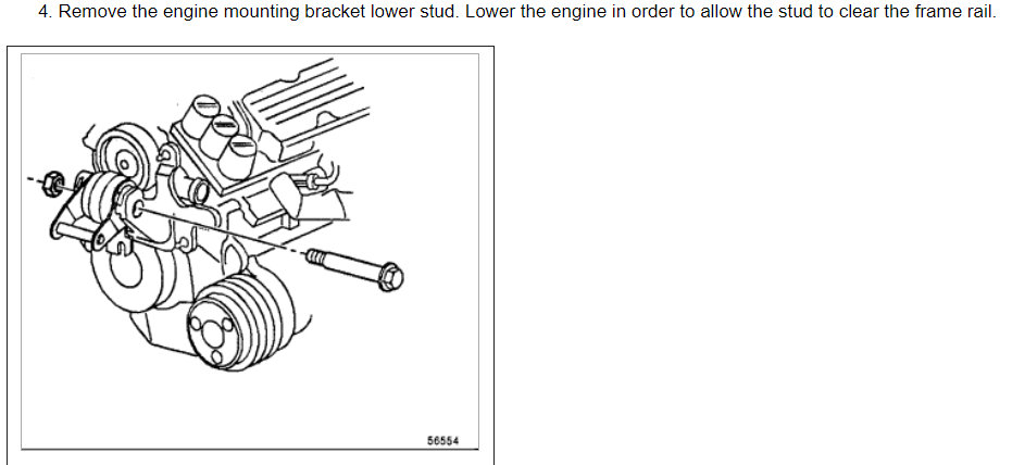

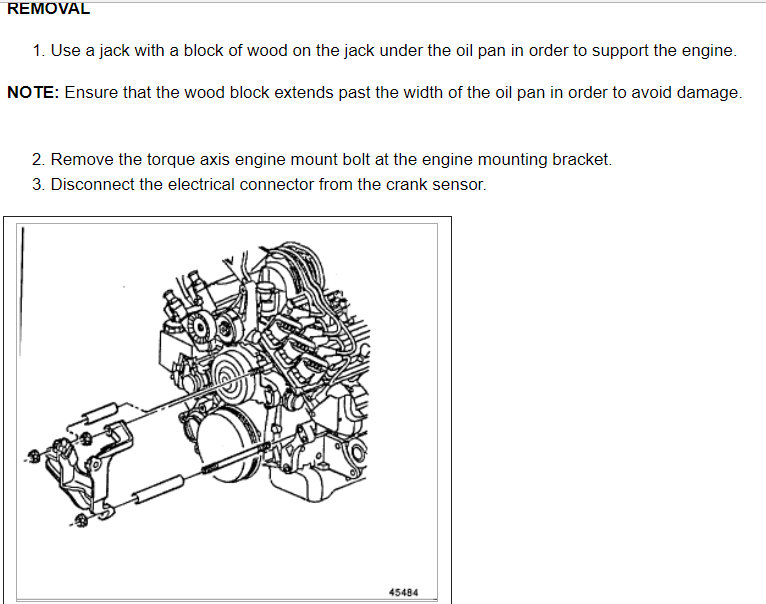

1. Use a jack with a block of wood on the jack under the oil pan in order to support the engine. NOTE: Ensure that the wood block extends past the width of the oil pan in order to avoid damage.
2. Remove the torque axis engine mount bolt at the engine mounting bracket.
3. Disconnect the electrical connector from the crank sensor.
4. Remove the engine mounting bracket lower stud. Lower the engine in order to allow the stud to clear the frame rail.

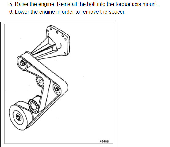

5. Raise the engine. Reinstall the bolt into the torque axis mount.
6. Lower the engine in order to remove the spacer.

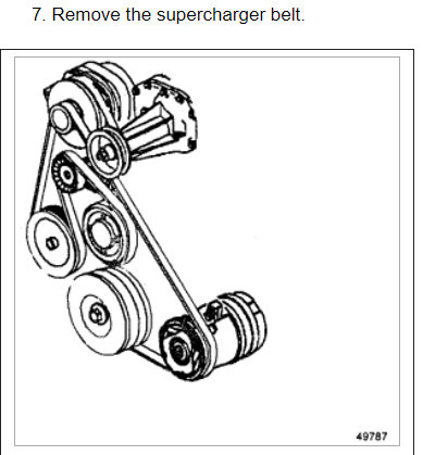

7. Remove the supercharger belt.

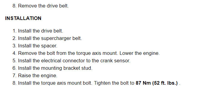

8. Remove the drive belt.

So it is not a factor of lowering the engine then? I have already removed the damaged belt by cutting it and am all set to lower the engine. I have loosened the stud and just need to lower the engine a bit to get it out so I can remove the sleeve and install the new belt. I do not understand steps 5 and 6 at all but think I know what do do. I plan to remove the bolt through the motor mount and lower the engine, remove the stud and sleeve and install the belt. Then reinstall the sleeve and stud, raise the engine and reassemble the engine mount. Thx again.

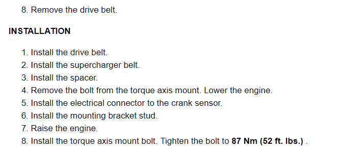

Here are diagrams and instructions form the book so you can see how they do it.
