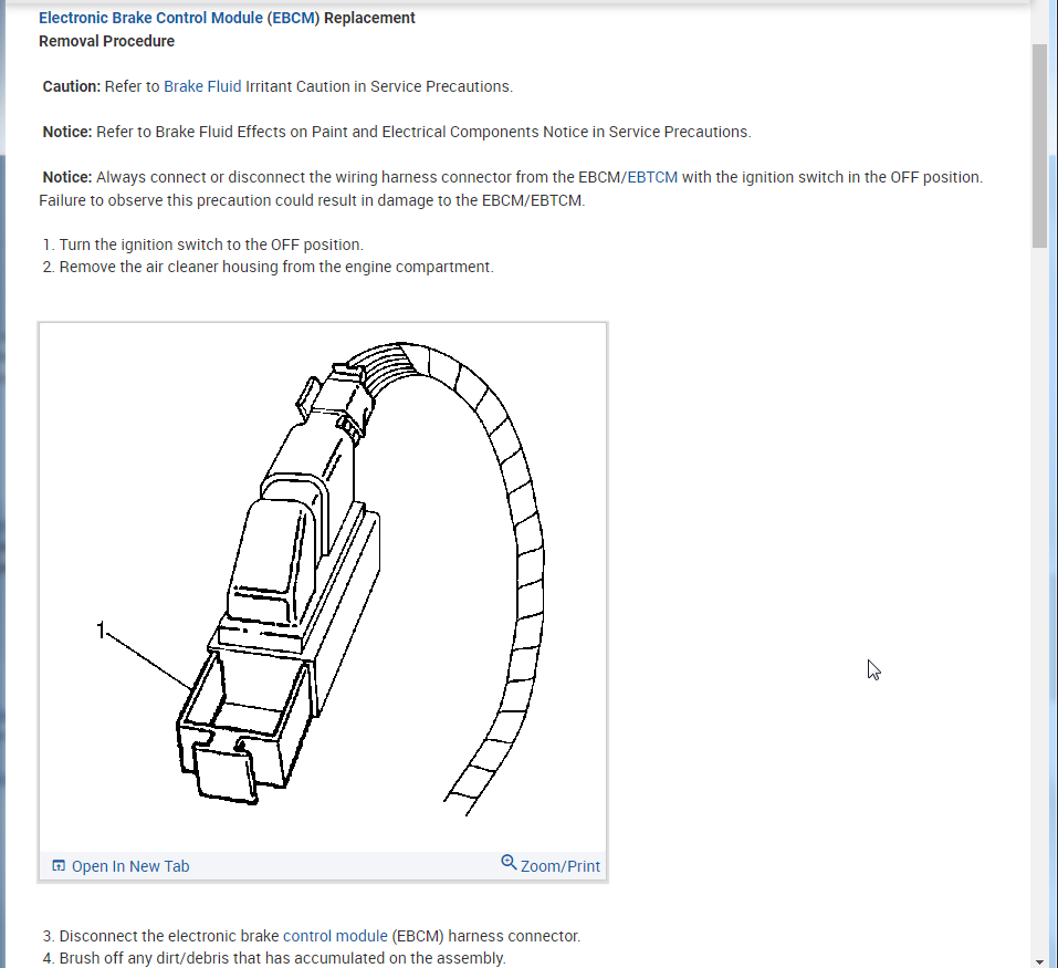

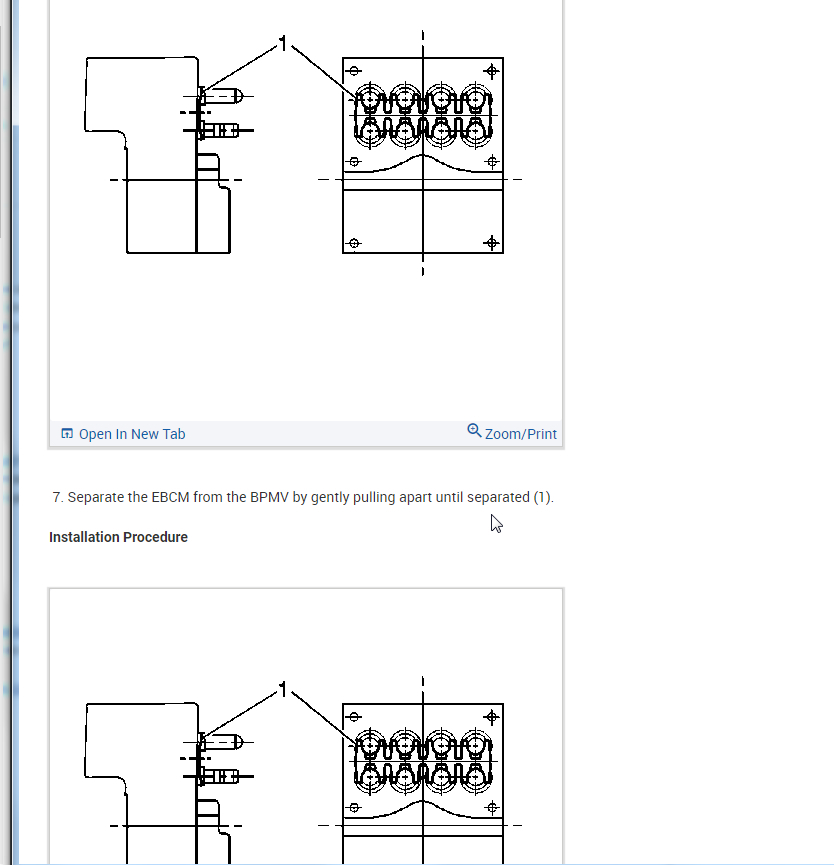

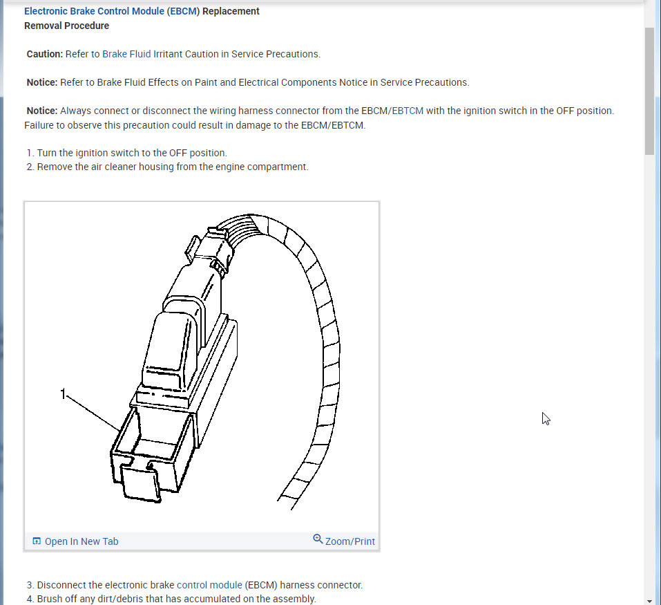

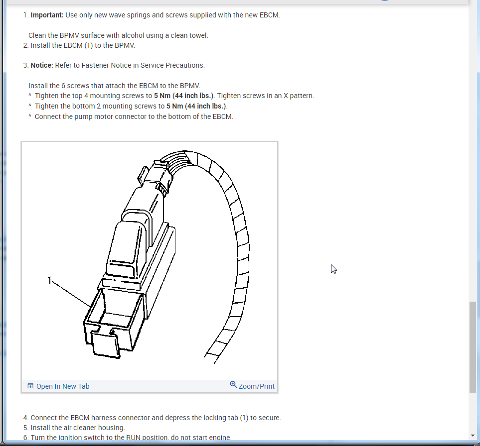

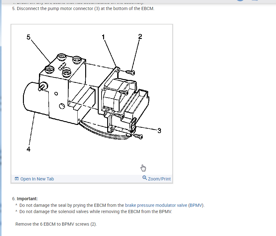

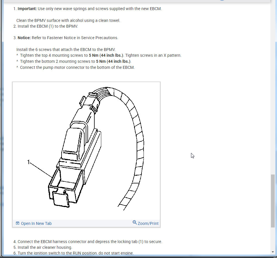

Depending on the codes we will have a better idea but the most likely cause of this is either a speed sensor issue or an ABS module issue.
I attached the info below on this but let's start with the codes and go from there. Thanks
