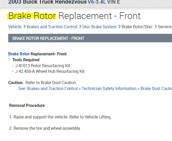

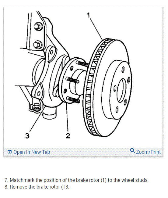

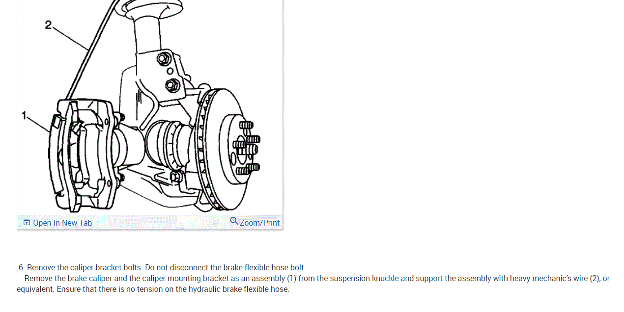

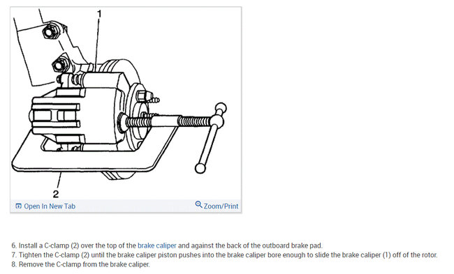

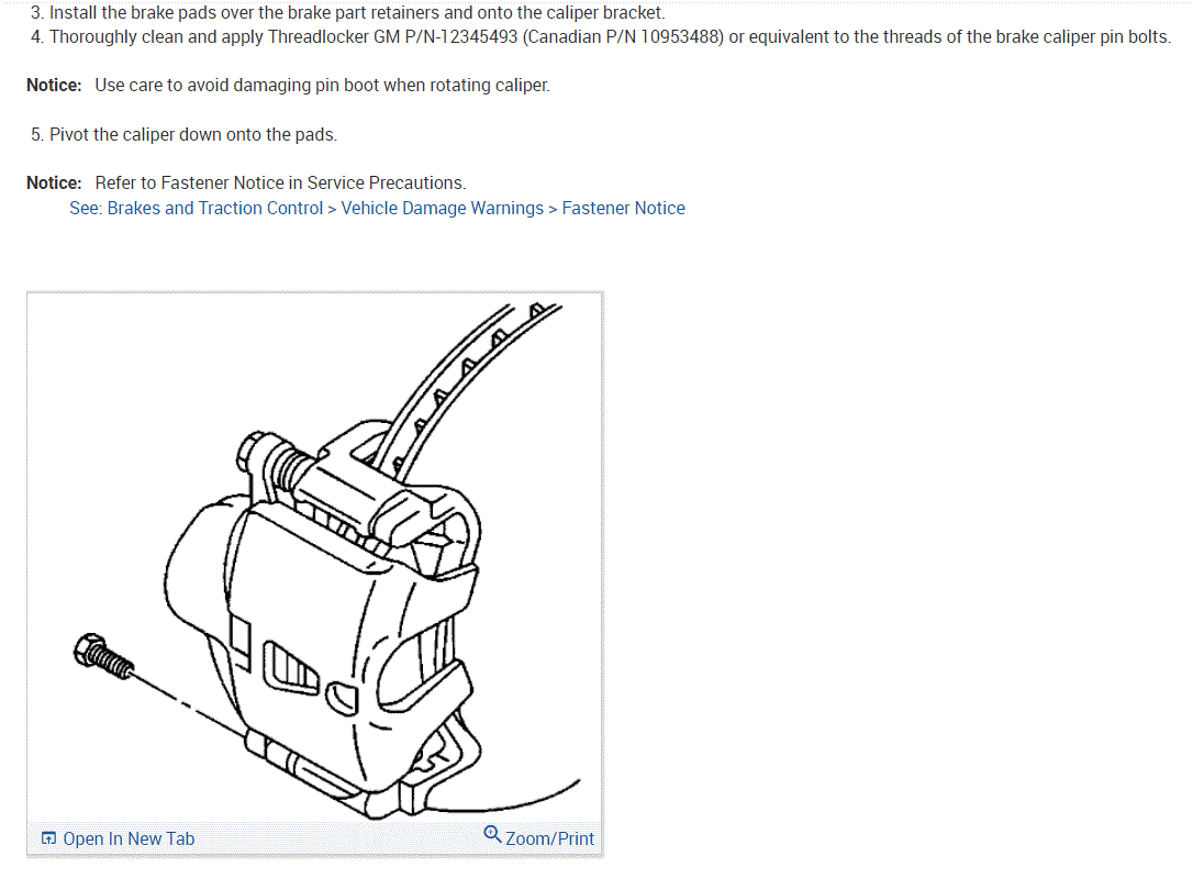

To get you started, here is a link that explains how in general to replace brake pads and rotors. You can use this as a guide.
I hope this helps. Let me know if you have other questions.

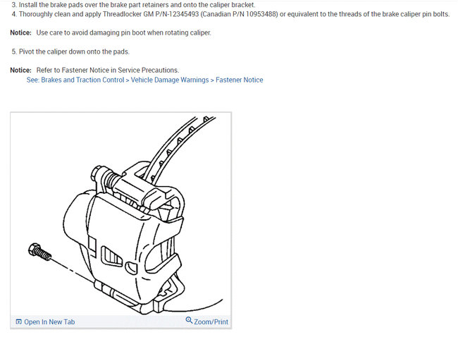

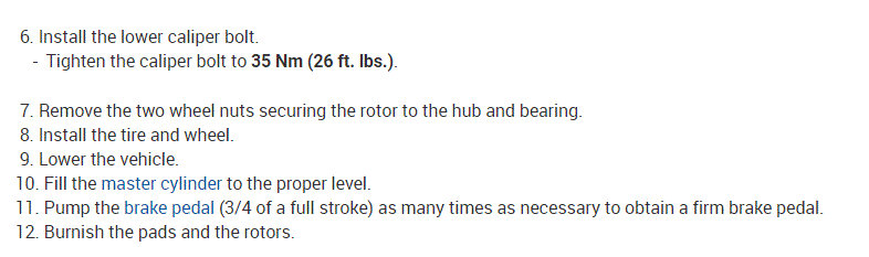

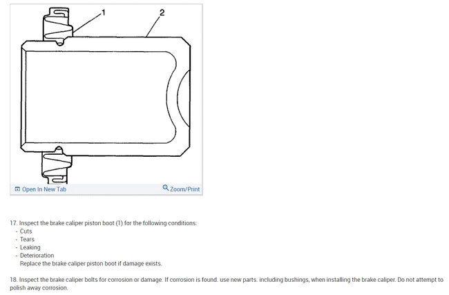

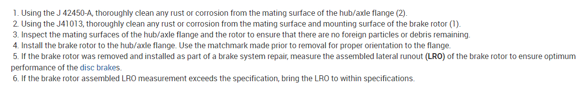

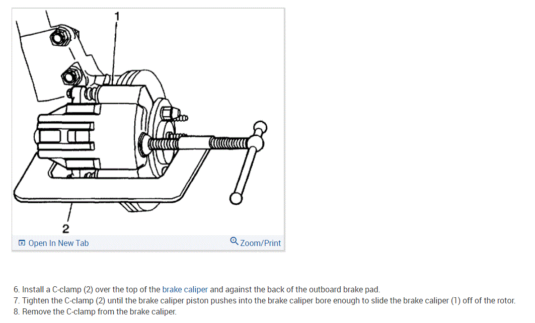

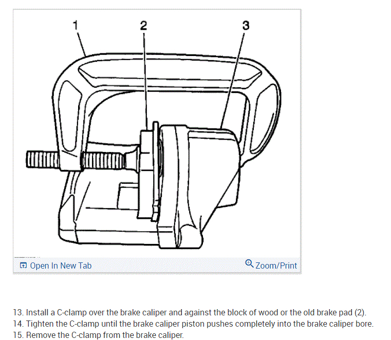

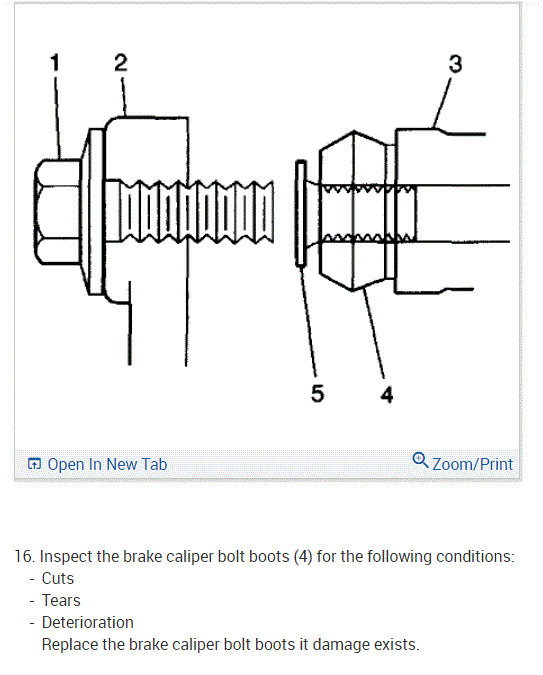

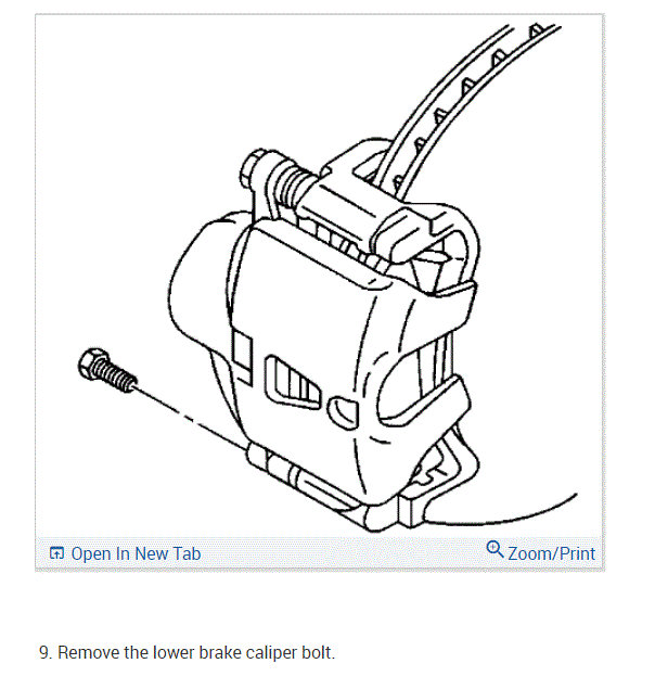

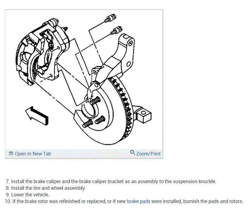

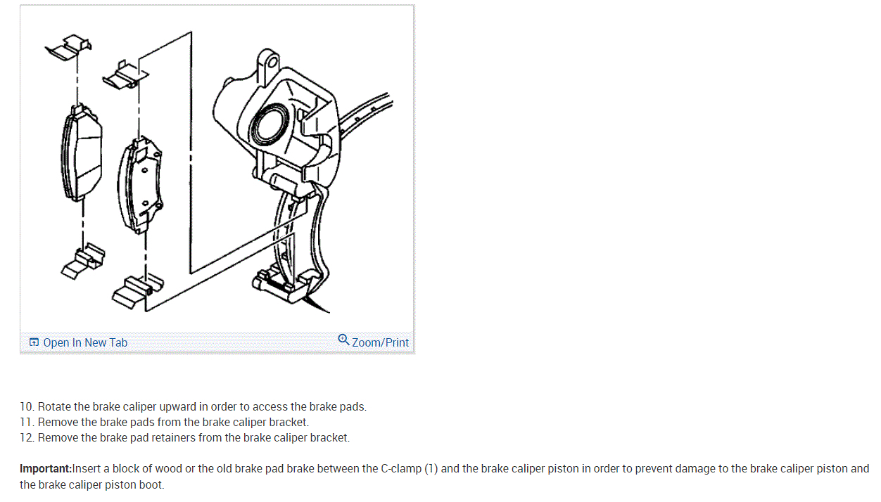

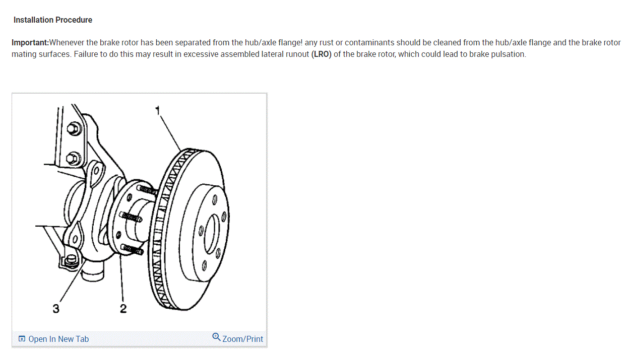

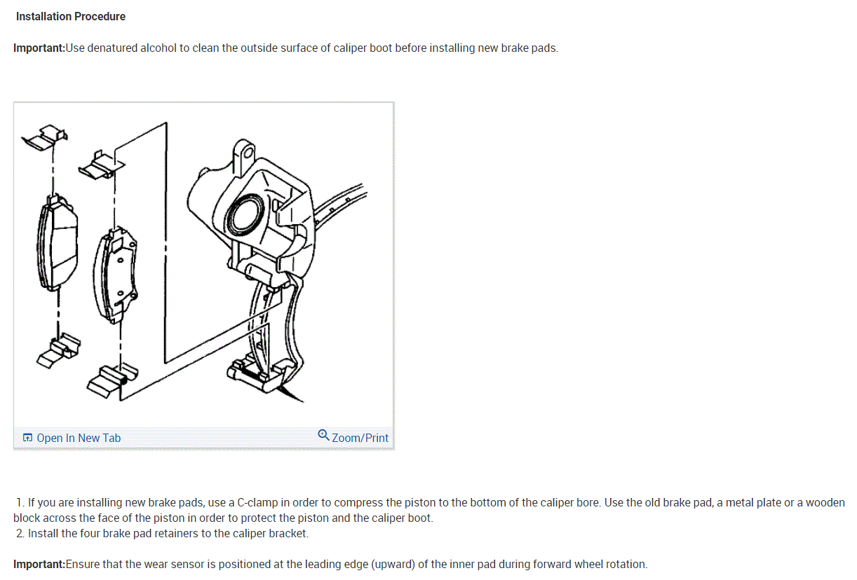

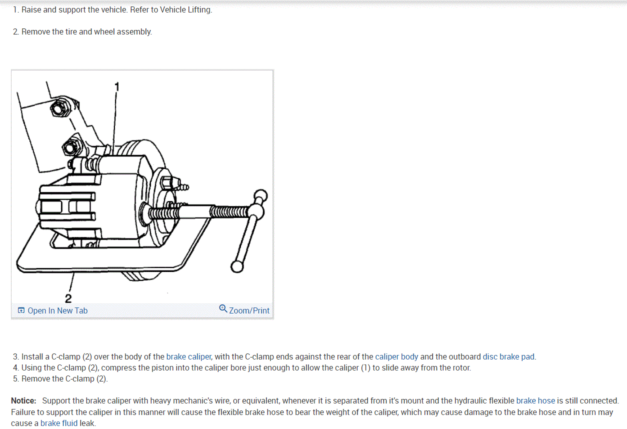

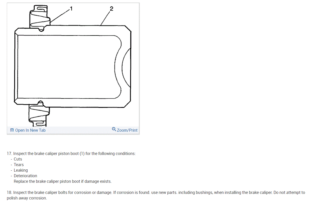

See pics below.
