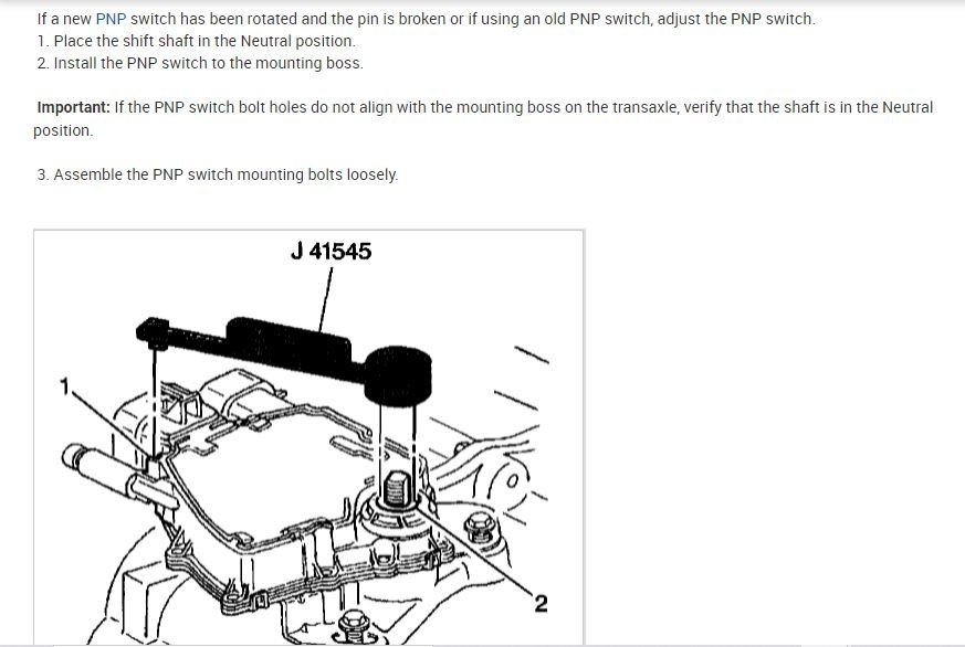

The shifter must be completed in the park in order for the key to be removed. If it is not, the key will not be able to be removed.

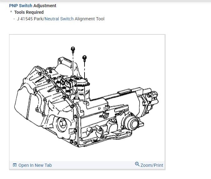

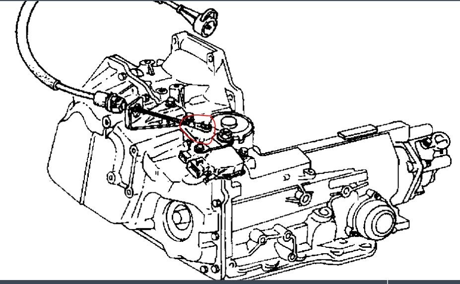

I attached some pictures below of the position switch on top of the transmission. Make sure the cable is secured. I circled the area that is common for wearing out.
I also included the procedure for adjusting the switch as well.
