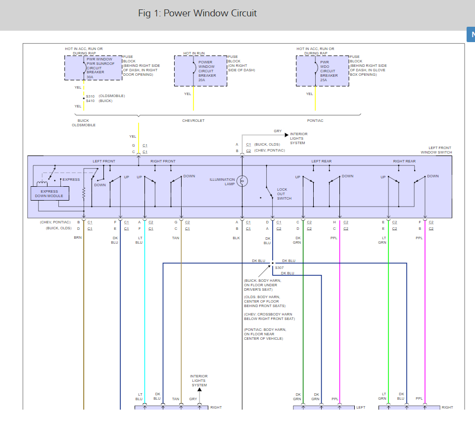

It sounds like the primary switch (driver's door) is bad. Here is a guide that can help you check it. Is there power to the switch?
https://www.2carpros.com/articles/electric-window-repair
Please let us know what you find so it will help others.

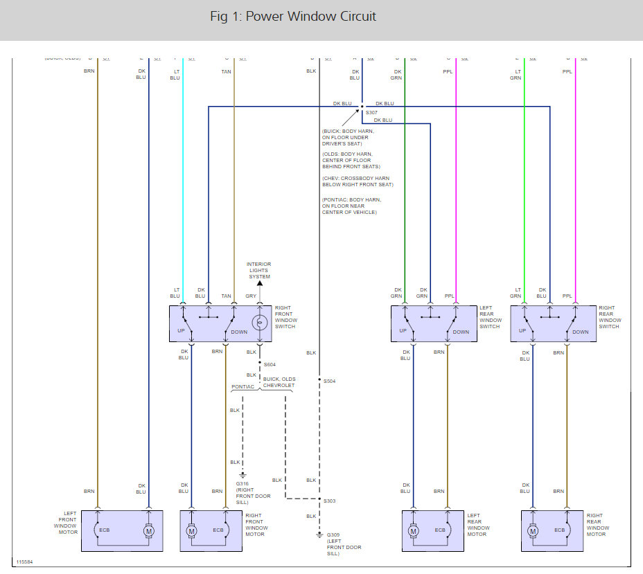

Here are the power window wiring diagrams. check for power through the circuit breakers you could have a bad one.
Please let us know what you find.

Check the power window circuit breaker, in diagram. When trying to operate the windows, is the circuit breaker hot to the touch? Also, Use voltage tester, should be hot/voltage with the key on.
Because the driver door is opened and closed so much, sometimes the wire breaks. Yellow wire is voltage, black is ground.
