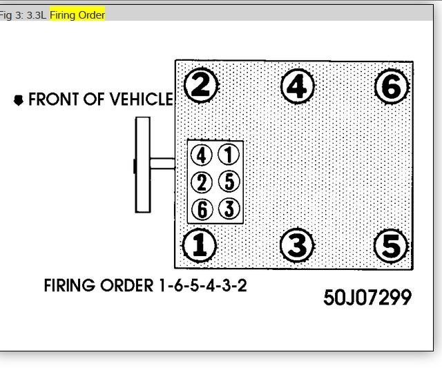

what is the proper firing order for the 3.8 liter v6
Apr 30, 2009 at 10:34 PM
RASMATAZ
  • 75,992 POSTS
https://www.2carpros.com/forum/automotive_pictures/12900_fo_51.jpg
Apr 30, 2009 at 11:44 PM

3.1L
https://www.2carpros.com/forum/automotive_pictures/55316_firingorder3100_1.jpg
3.8L
https://www.2carpros.com/forum/automotive_pictures/55316_firingorder3800_1.jpg
