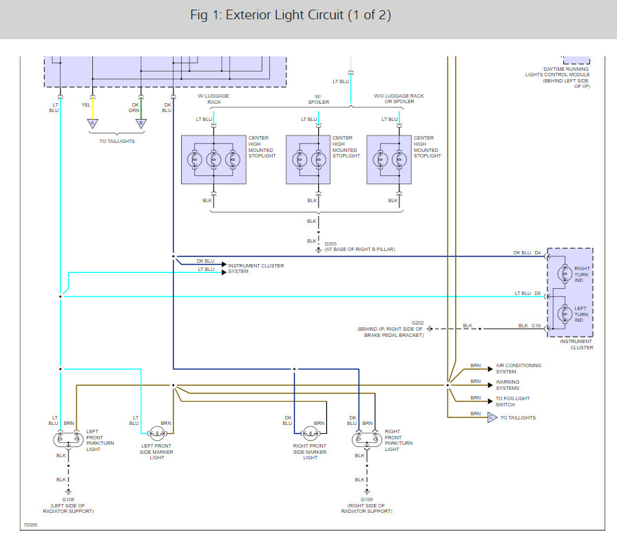

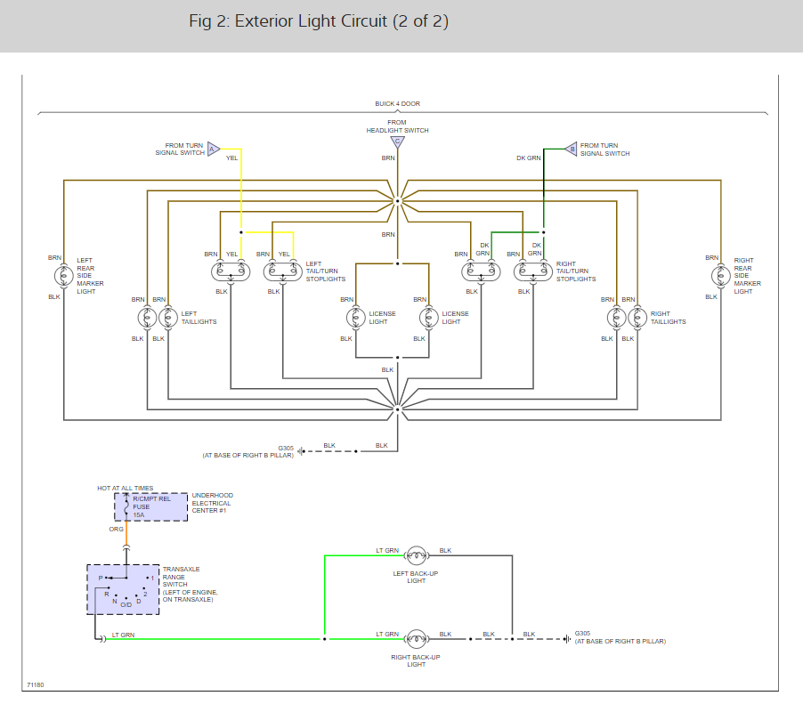

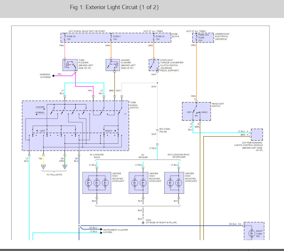

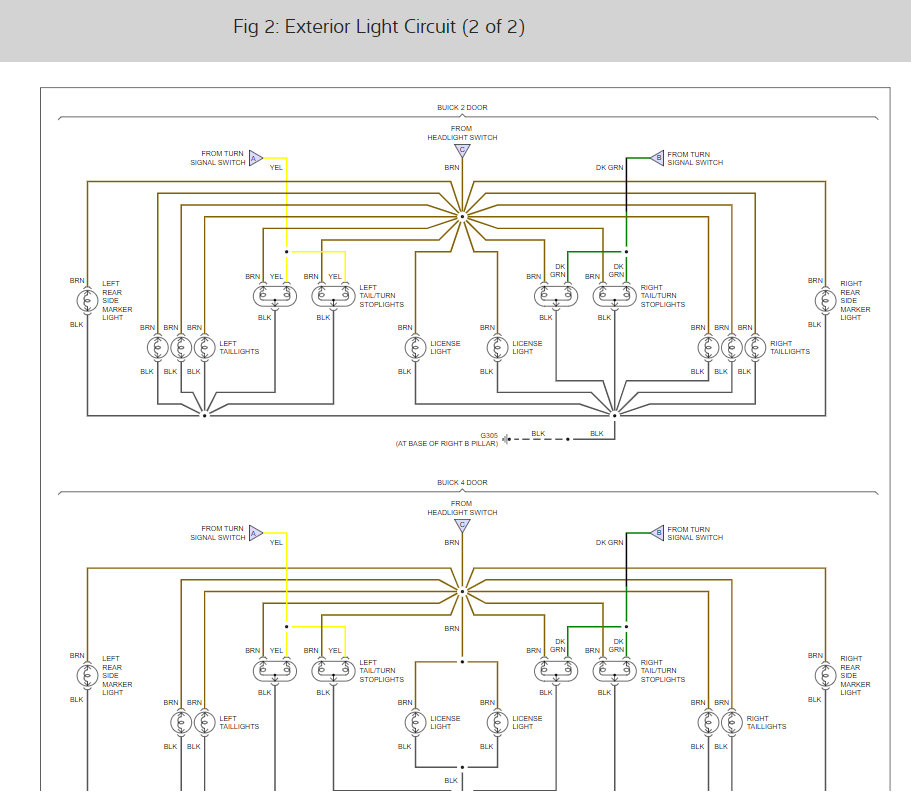

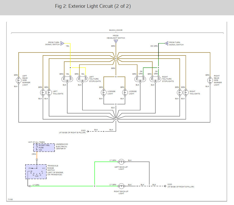

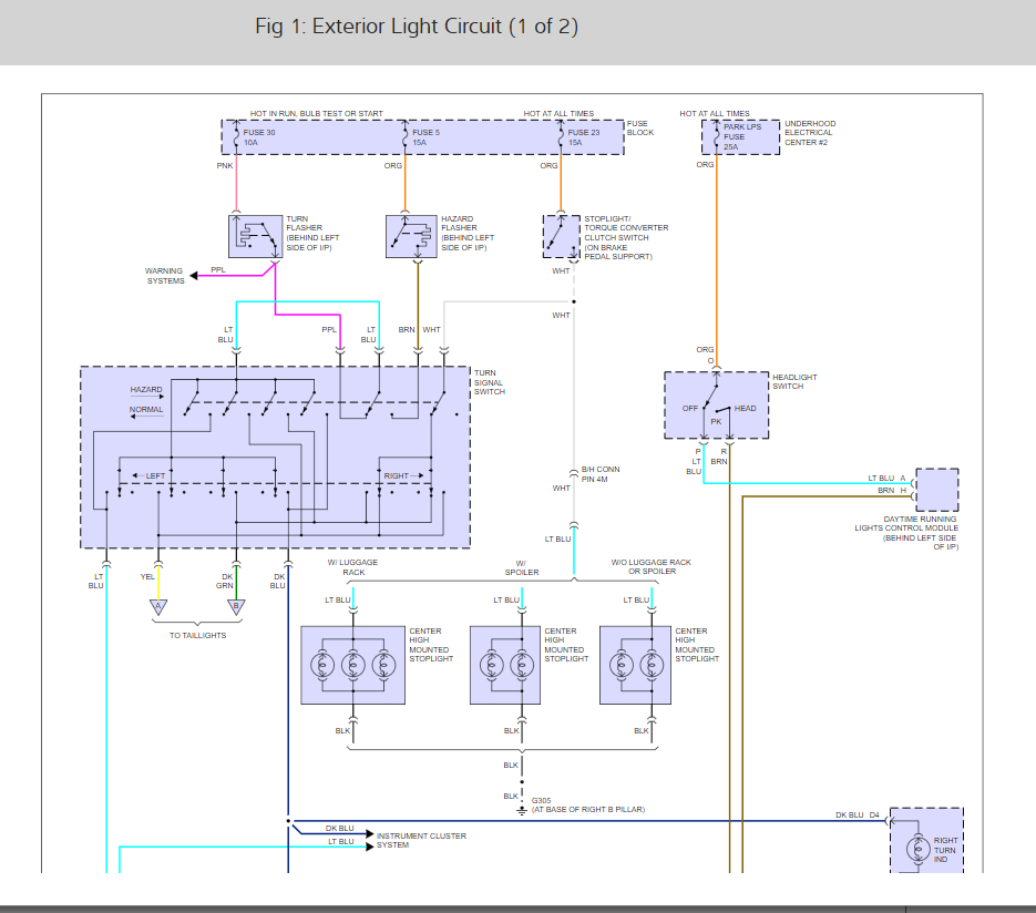

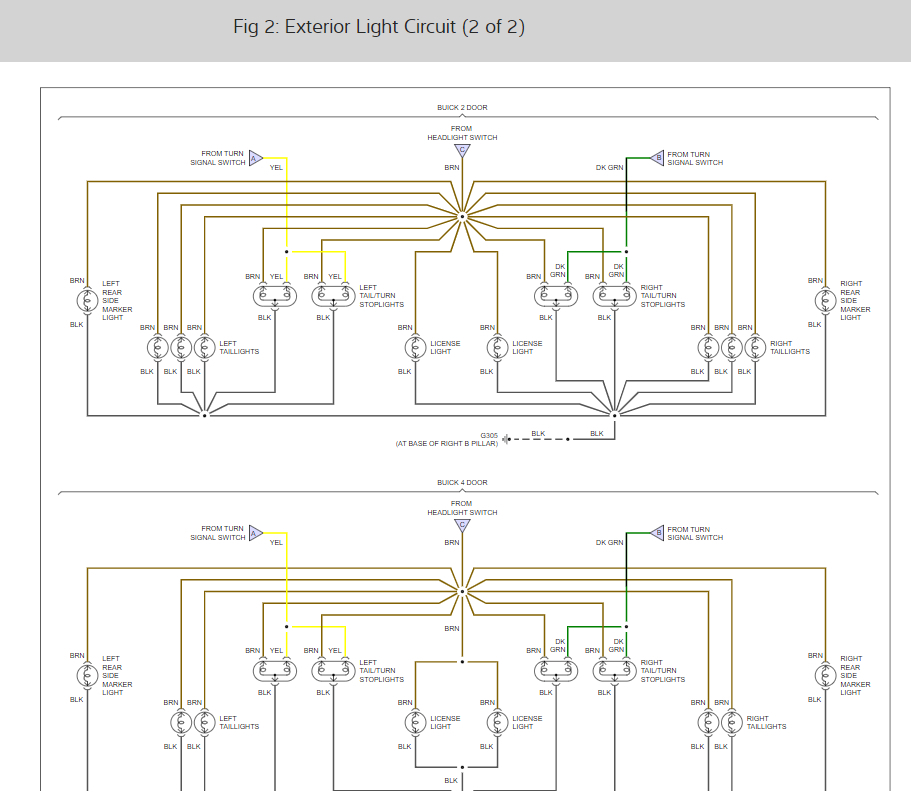

Here are the brake light wiring diagrams and a guide to help us see what's going on:
https://www.2carpros.com/articles/brake-lights-not-working
See how the brake lights work below. Check out the diagrams (below). Please let us know what you find. We are interested to see what it is.
Dec 27, 2018 at 6:54 PM
