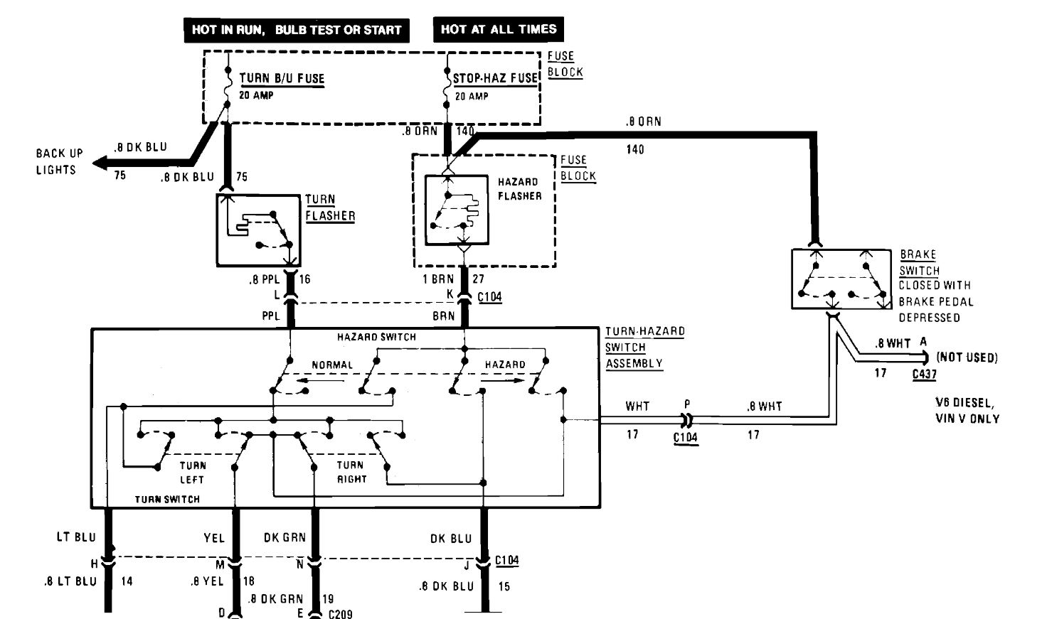

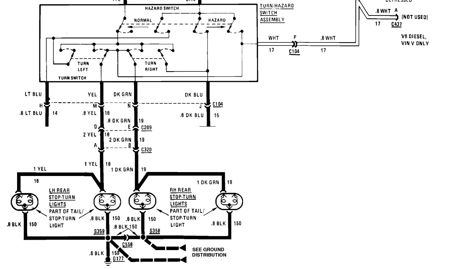

Here's your brake wiring/color does it matches yours?
The group of 2 has a yellow wire and a Gray, I think, wire. These 2 I've tested and they are the left and right lights for the turn signals and hazard lights. The turn and stop lights shares the same filament in the bulb as illustrated in the wiring diagram.
Wiring diagrams are attached below

Looking it over. Where is the break switch and wires from the connector at the fuse block?
That's where I'm going to need to jumper. The wires at the brake light/tailight bulbs are a different color than those going from the connector in the trunk to the connector at the fuse block under the dash.

Those wiring diagrams appear to have power seat and locks circuitry. mine doesn't have any of that.

Looking it over. Where is the break switch and wires from the connector at the fuse block? This one here I don't have that info. I thought you replaced the brake switch with a new one. Okay I'm getting confuse here-count the wires on the brake switch connector and give me the colors on it so I can dig for more info.
