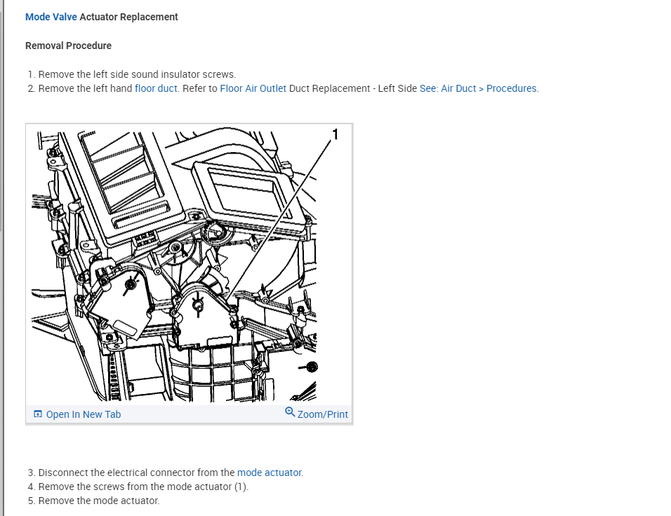

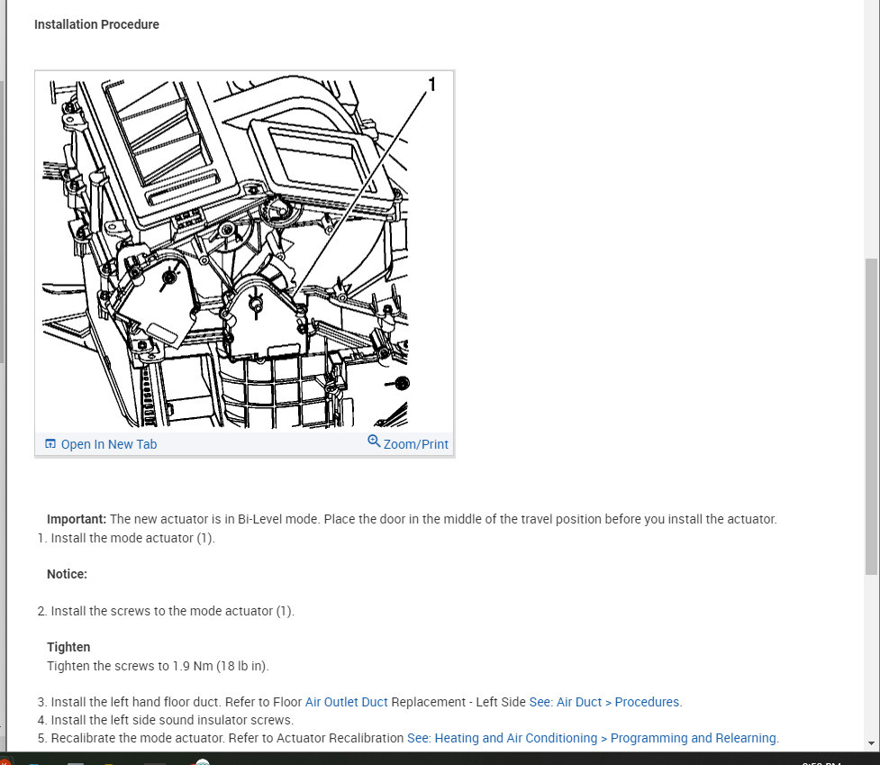

The issue with this is the mode door actuator has most likely failed.
So here is a guide that will talk about this:
https://www.2carpros.com/articles/air-vents-stay-in-the-defrost-position
I am attaching the process from the manual below on how to replace this so if it were me, I would replace this and retest the operation.

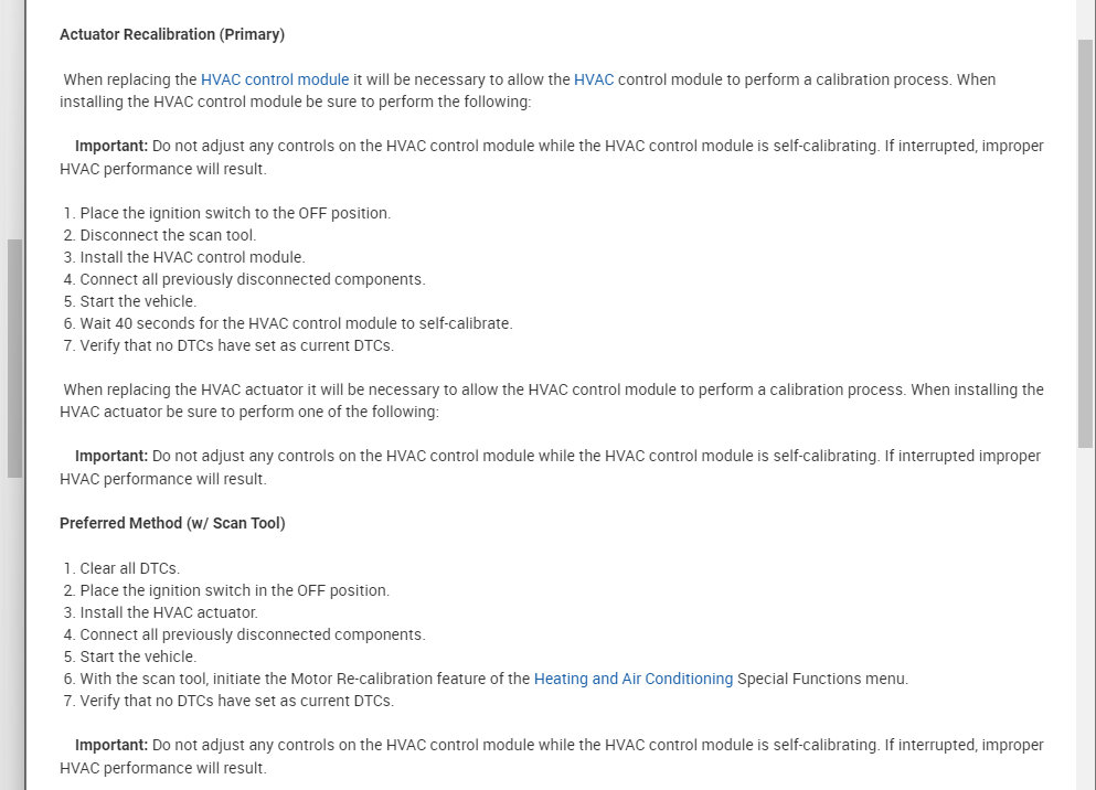

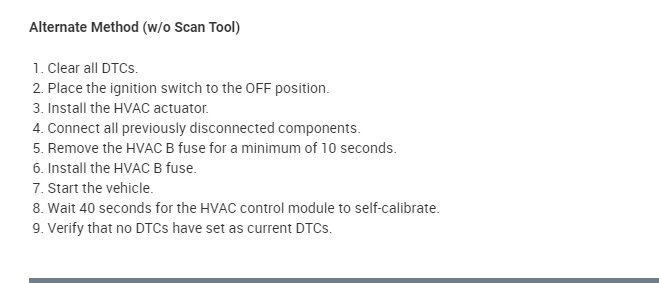

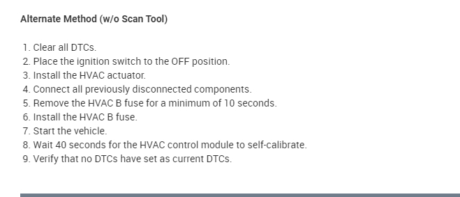

Also, I am attaching the calibration process as this will need to be completed after it is replaced.
