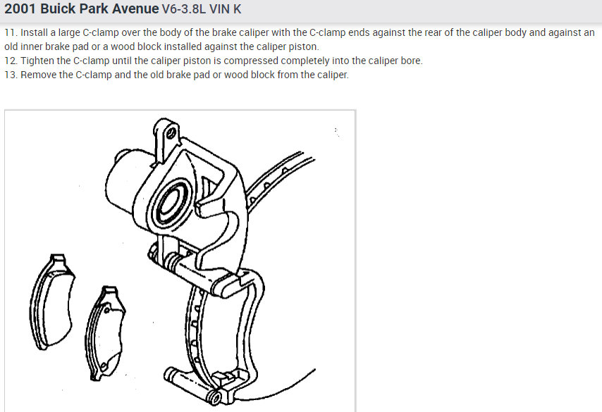

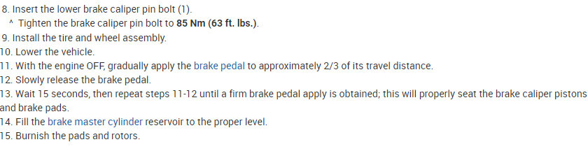

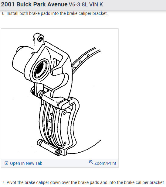

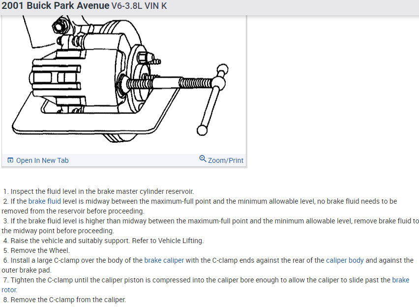

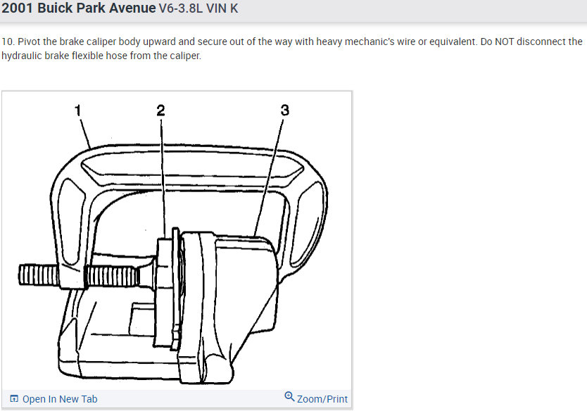

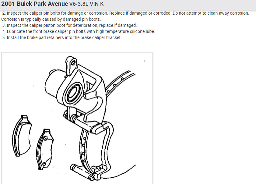

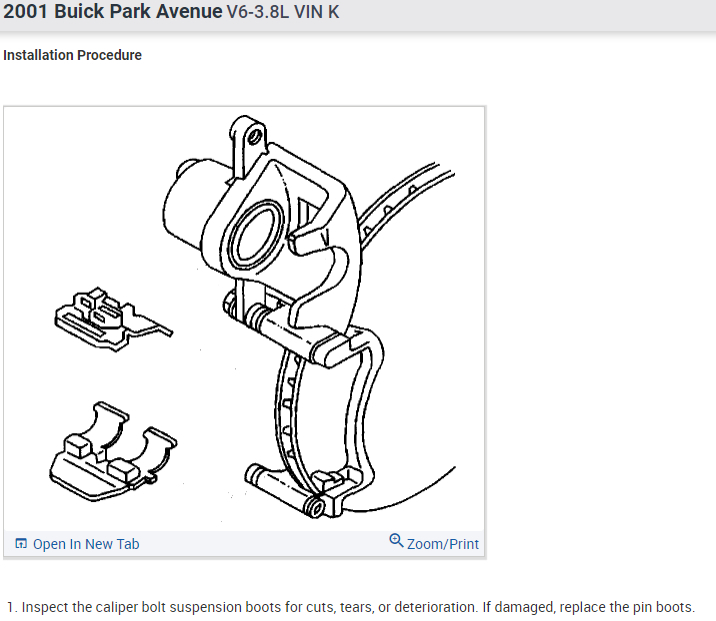

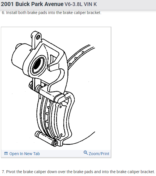

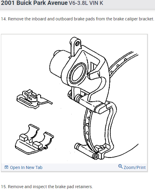

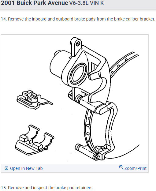

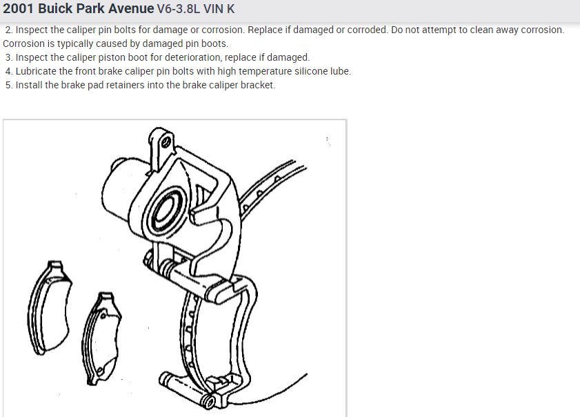

It sounds like the anti rattle clips were not installed properly and moves around when the brake is not pressed. That is the rattle you hear when going over a bump.
If you had this changed at a shop you should take it back to them to get this fixed properly.

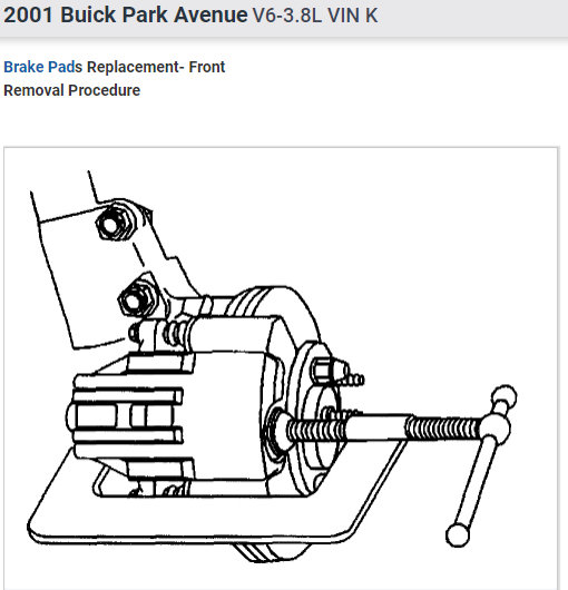

Here is a basic video of the brake pad replacement:
https://youtu.be/pv1wWJLxCtc
Let me know if you have any questions.
