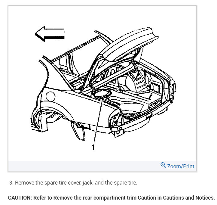

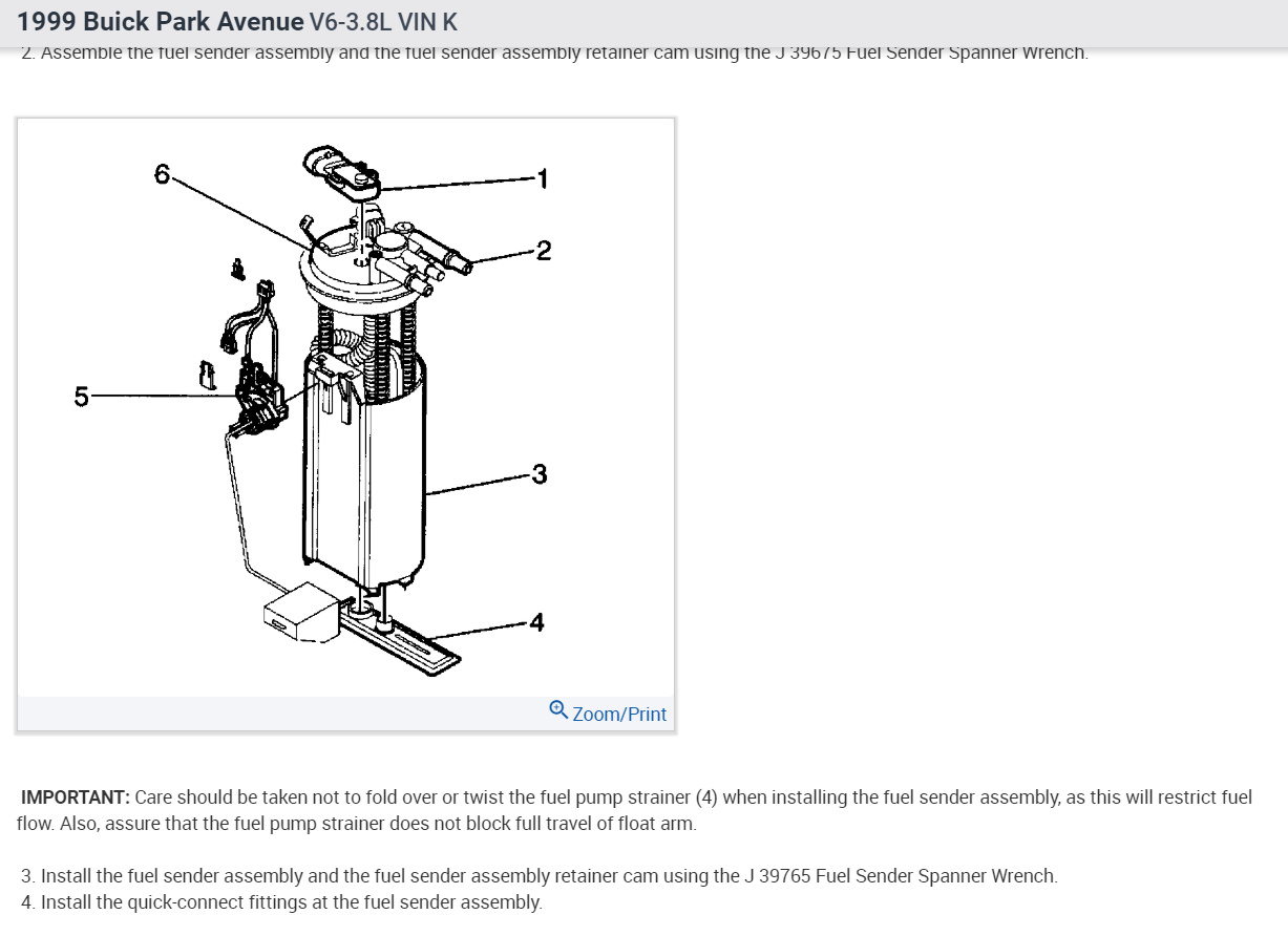

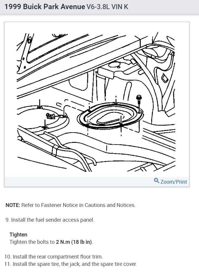

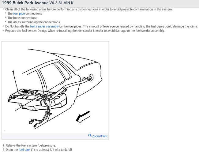

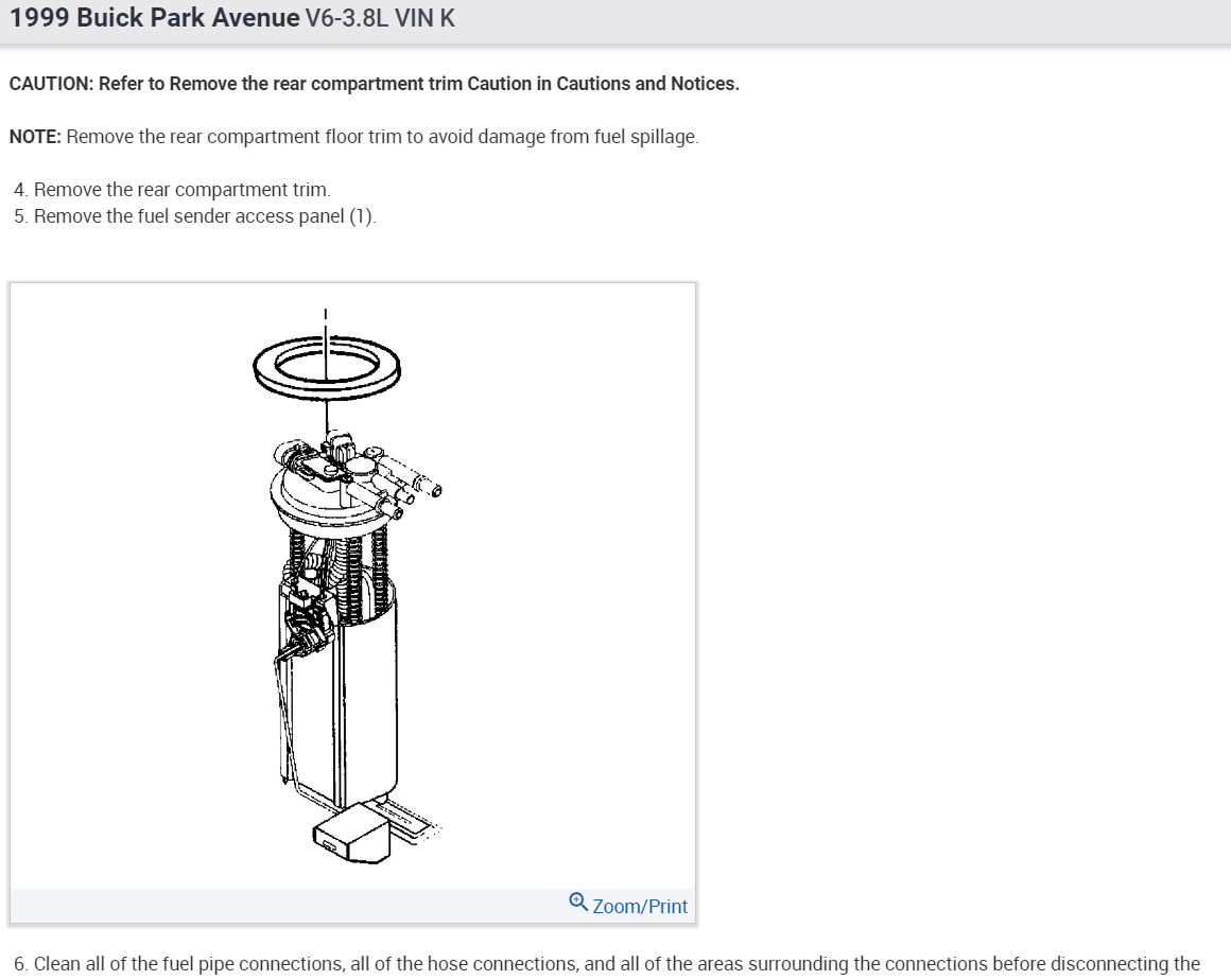

Does this car have to have the tank taken down for pump replacement or is the a cover plate for it? Thanks a bunch for any help.
Sep 23, 2010 at 5:40 PM
SATURNTECH9
CERTIFIED EXPERT
30,869 POSTS
There is an access hole under the rear seat. Here are diagrams below that show you how to do the job.
Check out the diagrams (below). Please let us know if you need anything else to get the problem fixed.
