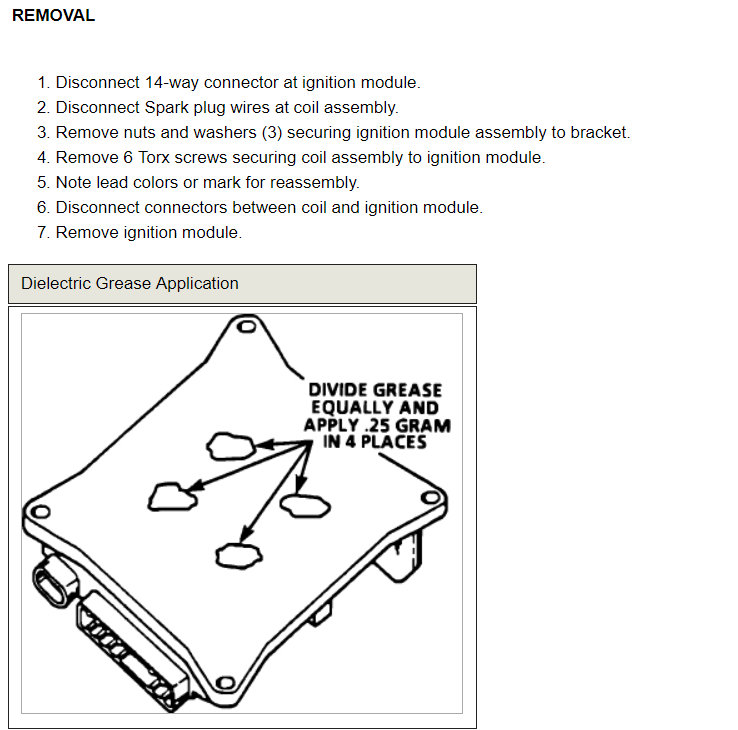

There is an ignition module that goes out on theses cars which sounds like what it happening to your car as well.
Here is a diagrams to help you change the module out.
