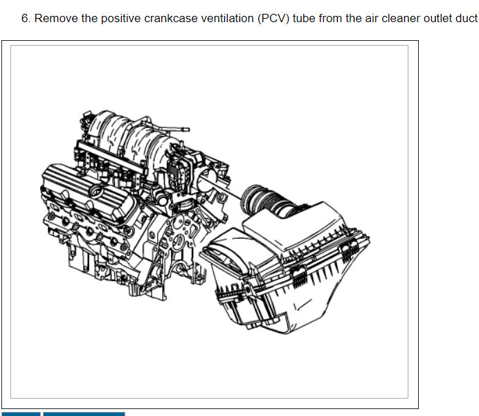

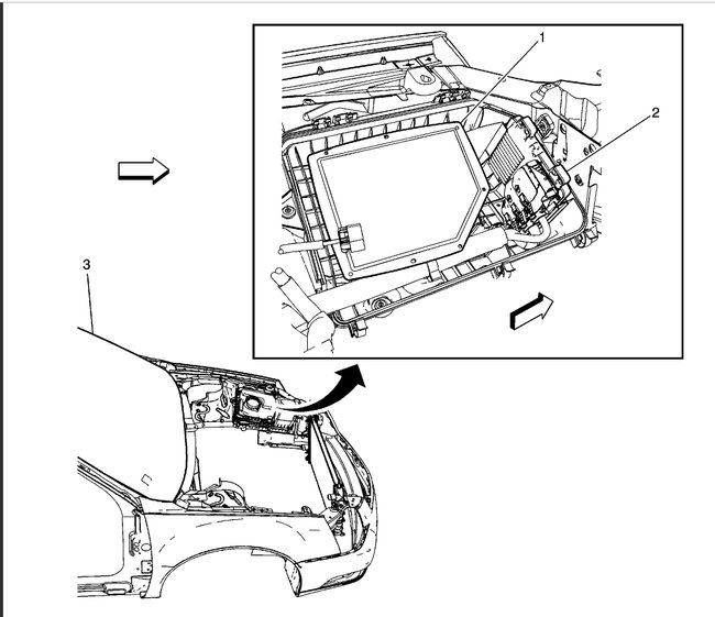

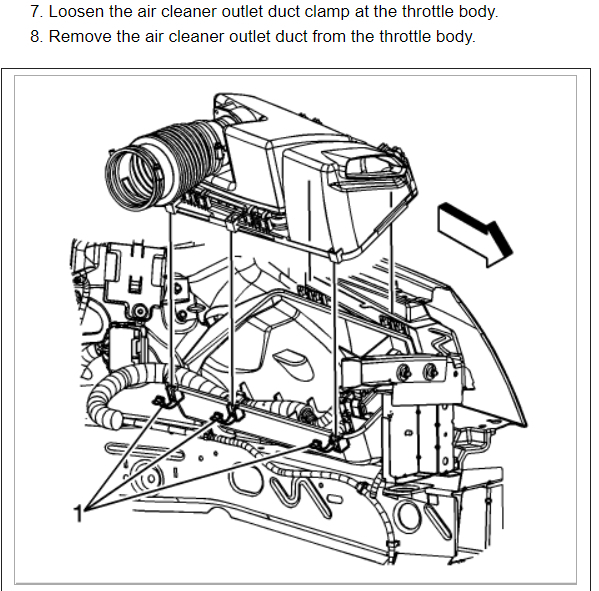

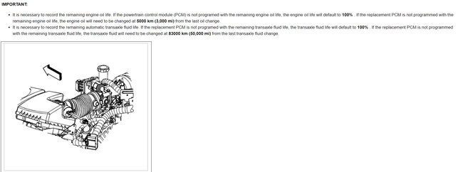

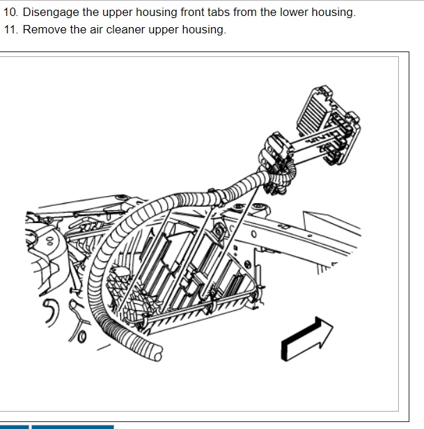

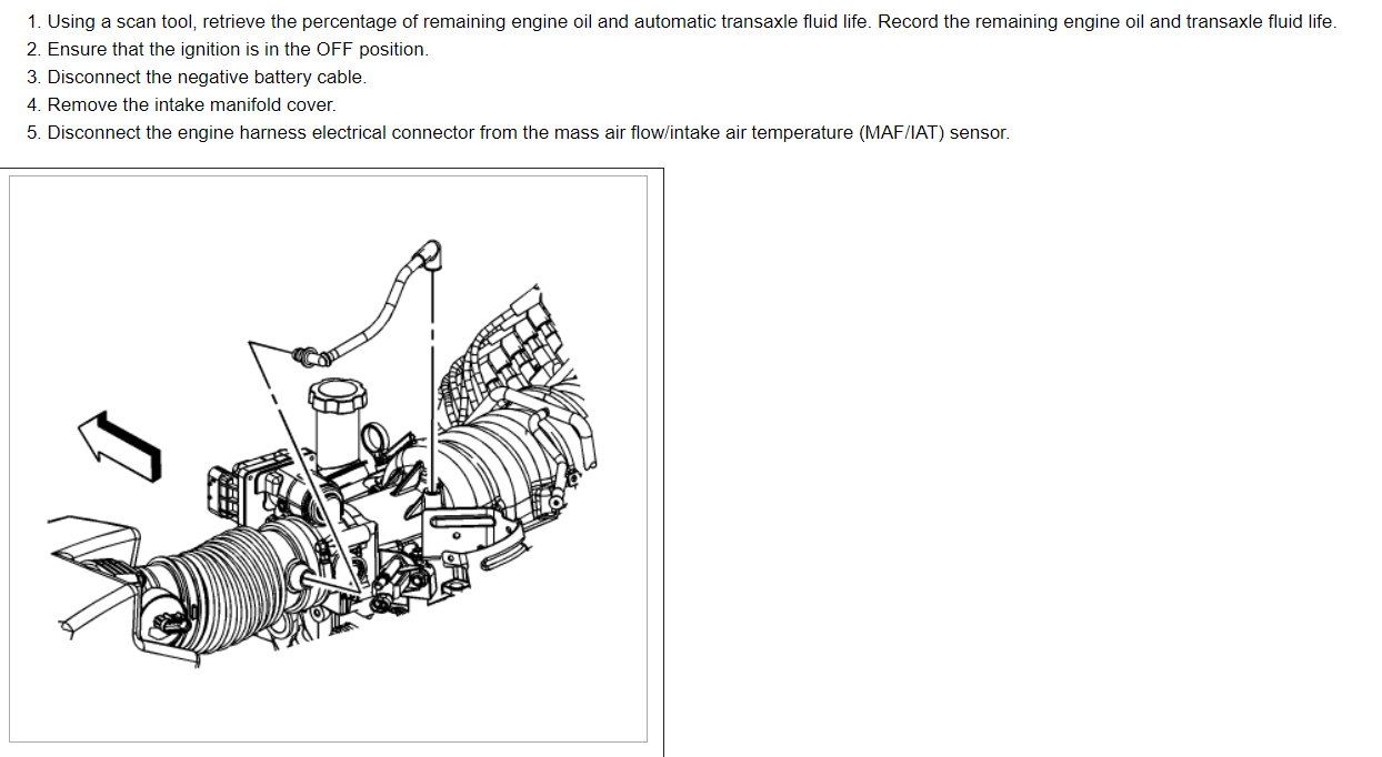

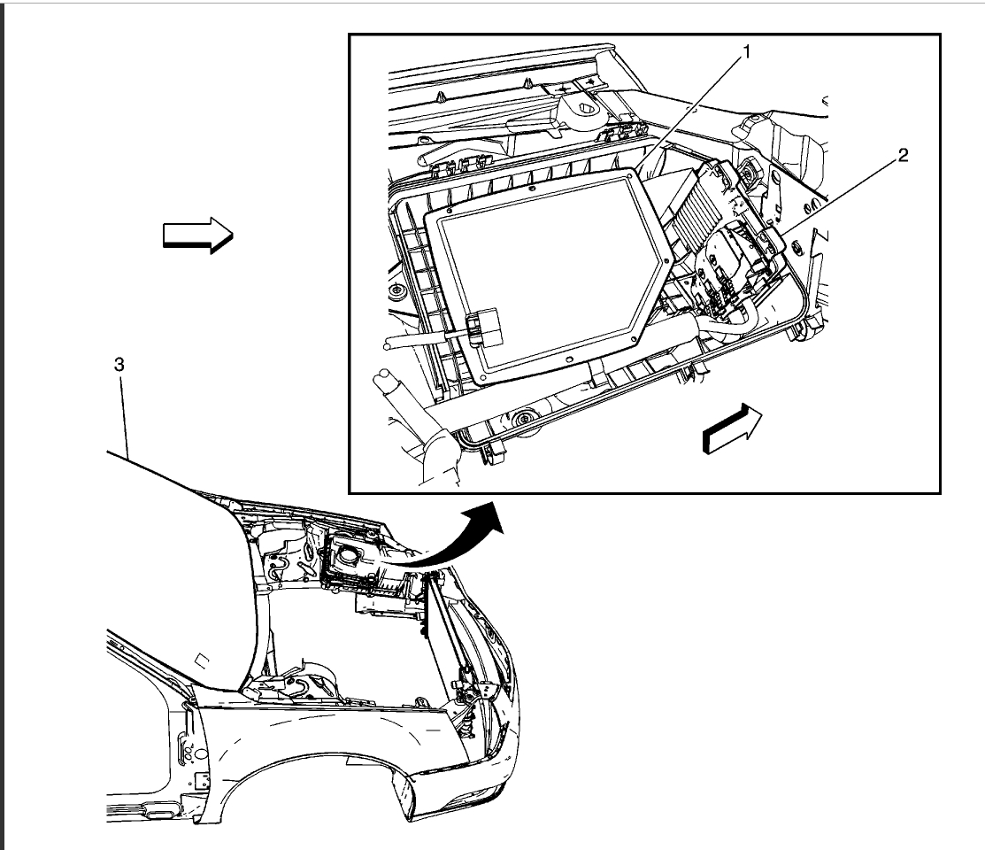

Where is the engine computer located so I can add a JetChip Module. I found the transmission but don't see the engine computer. Please help.
May 15, 2008 at 9:48 AM
2CARPRO JACK
  • 11,533 POSTS

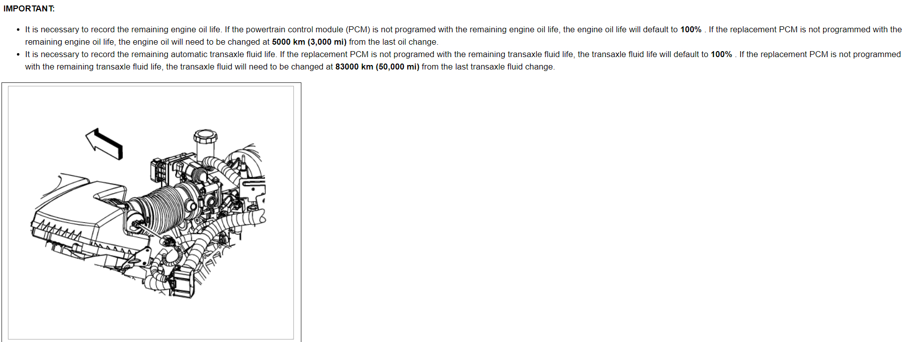

It is located on the left side of the engine compartment. here are diagrams and instructions below
