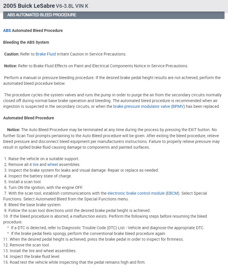

You might have to bleed the brake system again. As this vehicle with ABS requires a special brake bleeding procedure with a scan tool to communicate with the ABS module.
Without the tool it will not bleed properly and will have braking issues.
Here is a helpful video on how to bleed ABS:
https://youtu.be/nQRnKyVyMuQ
https://www.2carpros.com/articles/how-to-bleed-or-flush-a-car-brake-system
I have attached the step-by-step instructions for the ABS bleeding below.
