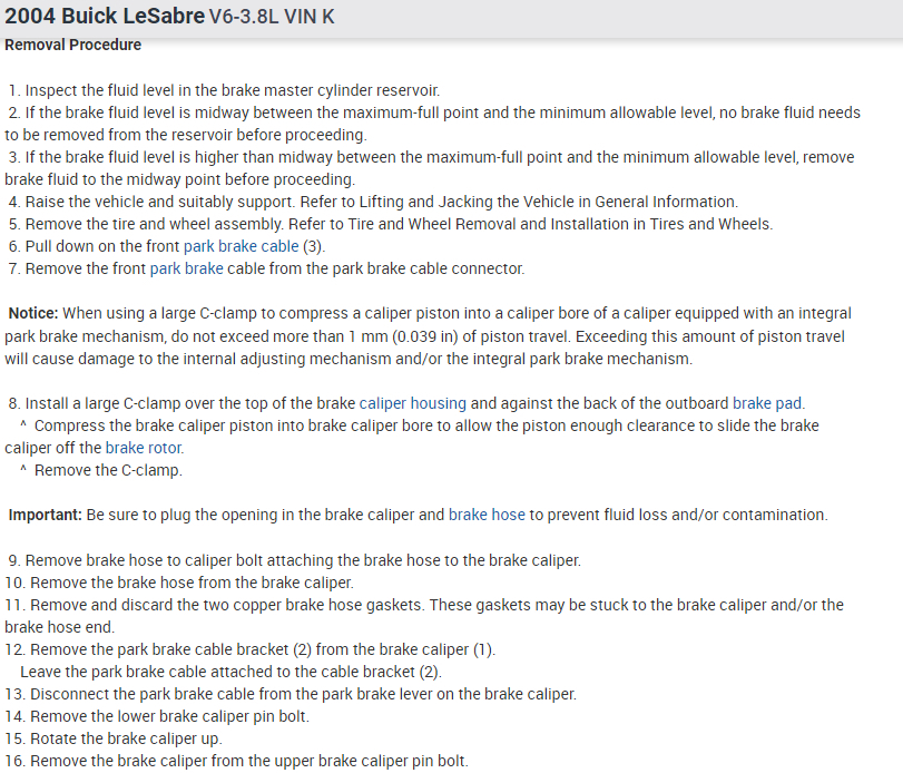

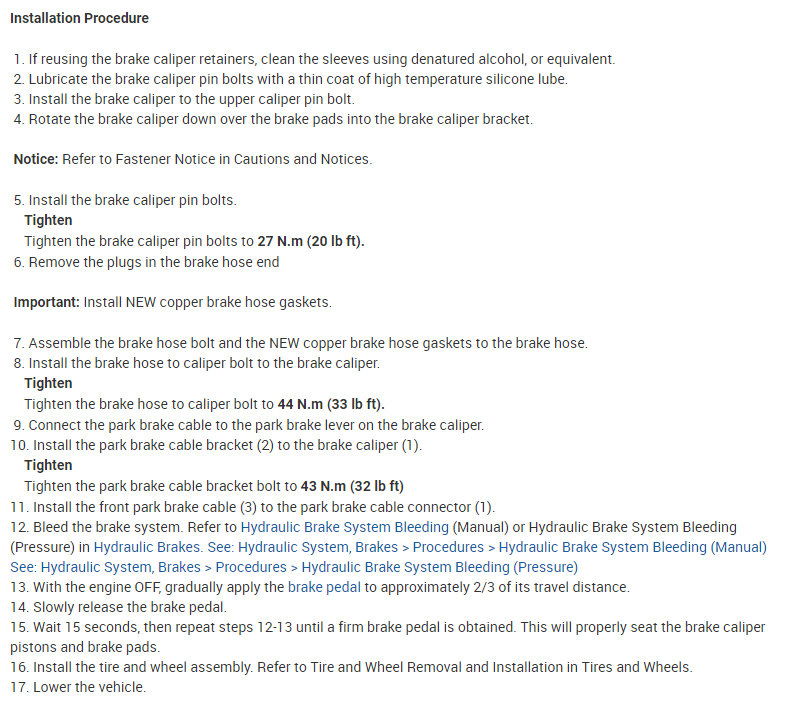

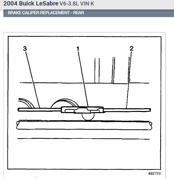

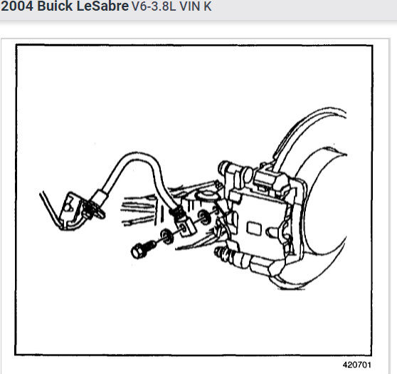

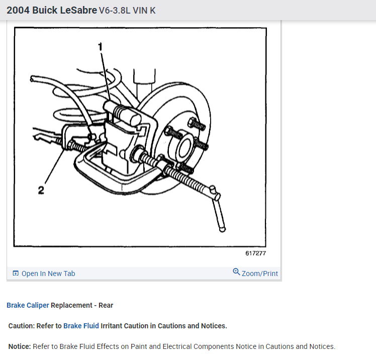

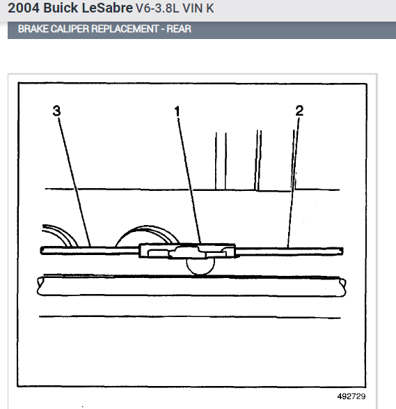

I have attached the rear caliper procedure for your reference. It has the parking brake instructions.
