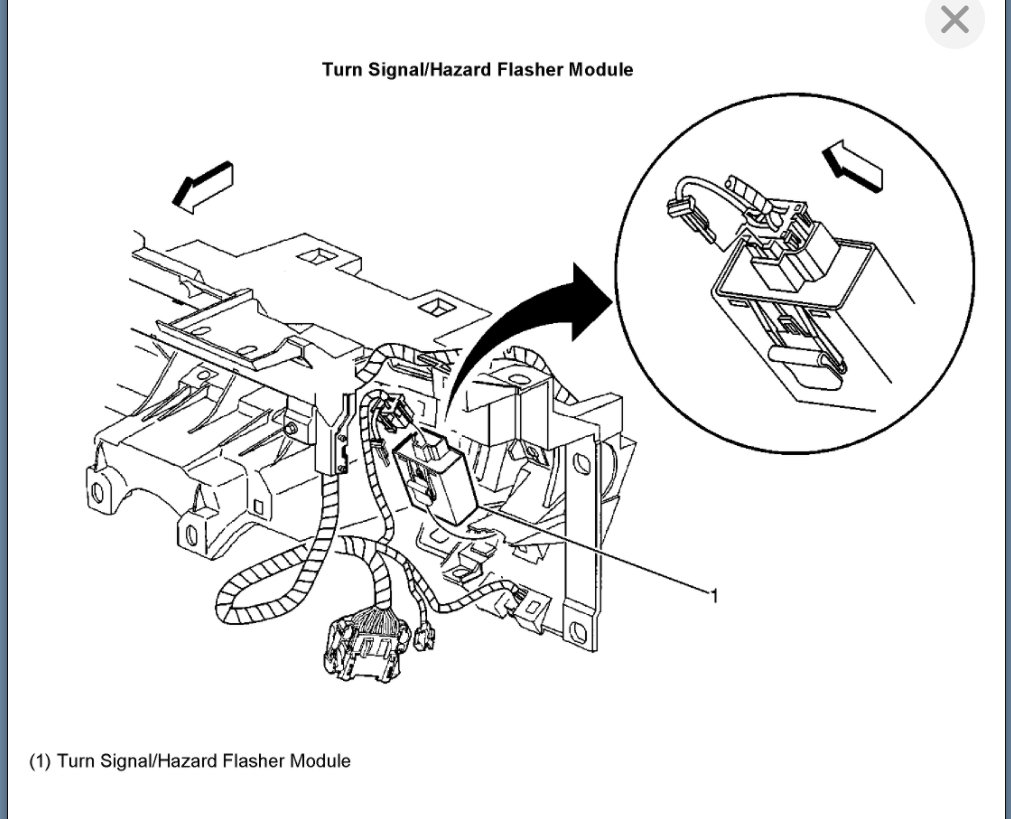

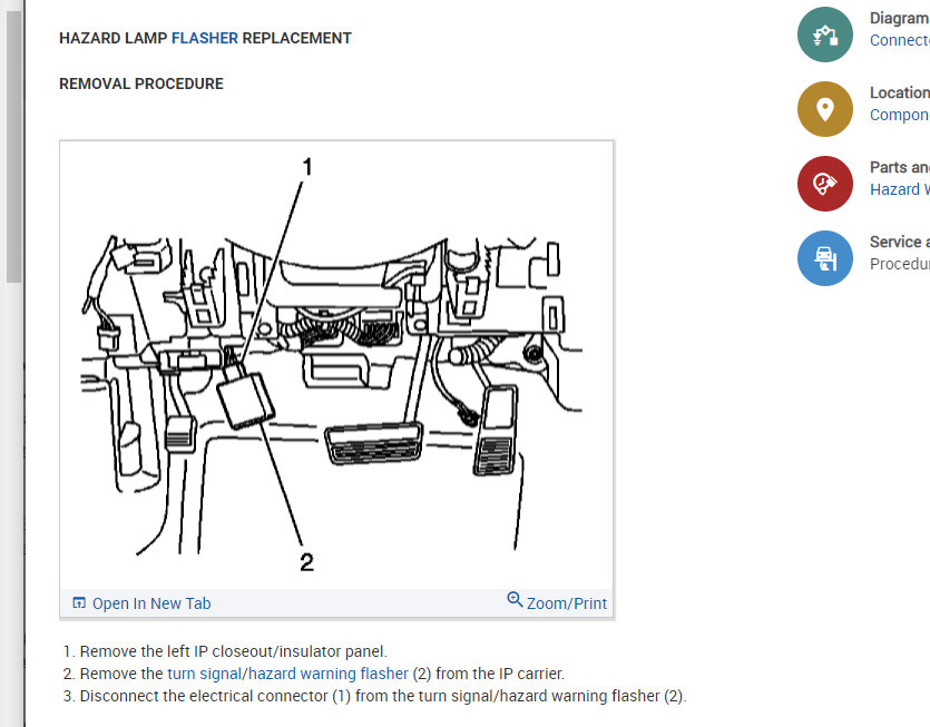

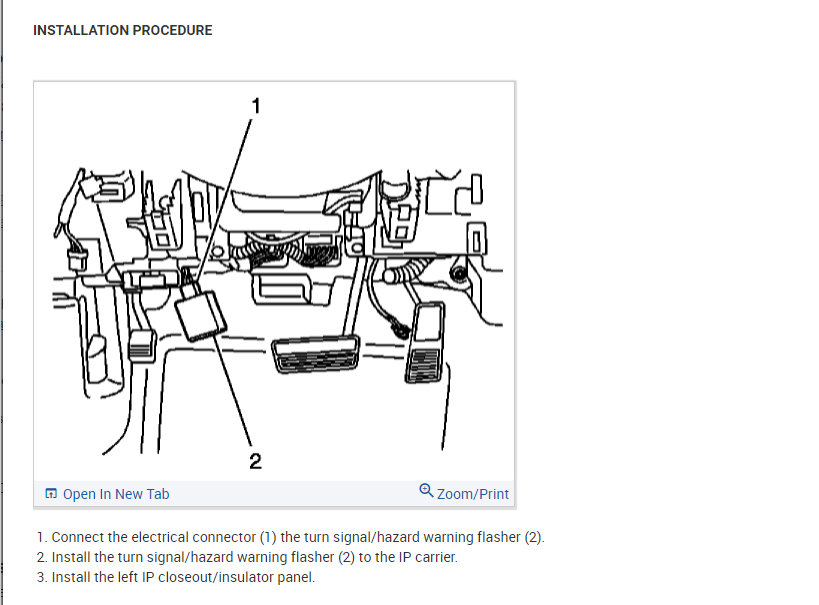

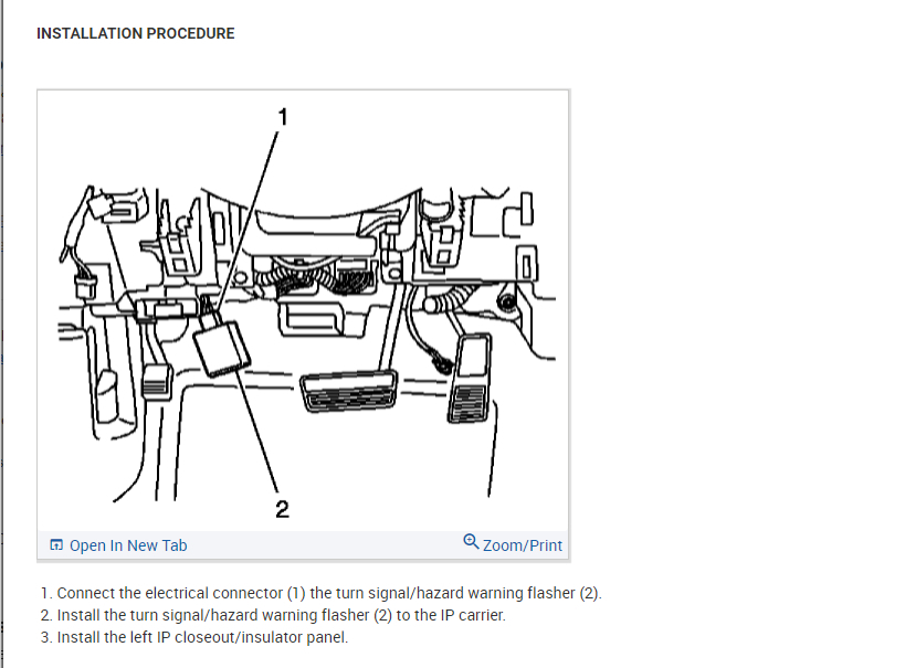

If you are having issues with the flashers, then this guide may help:
https://www.2carpros.com/articles/turn-signals-not-working-blinker
I am attaching the info below on how to replace this and where it is. Please run through this info and let us know if you have other questions. Thanks
