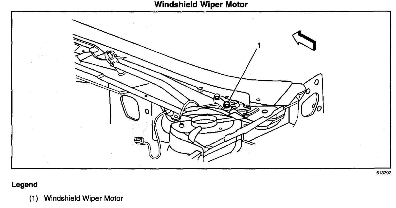

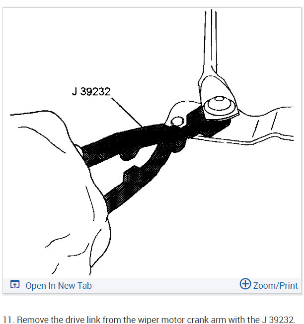

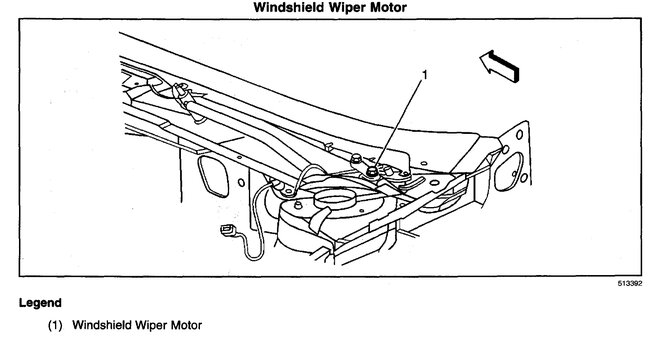

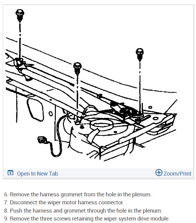

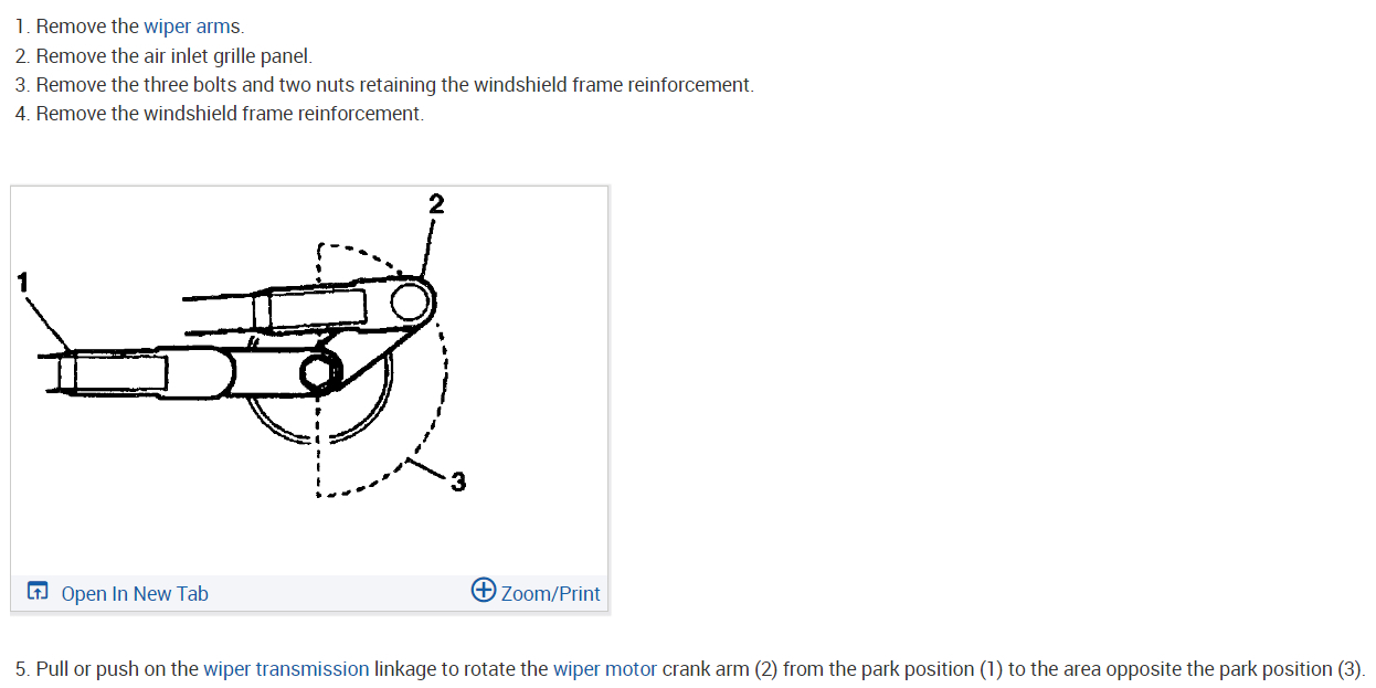

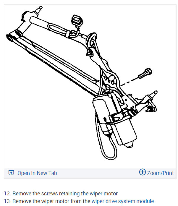

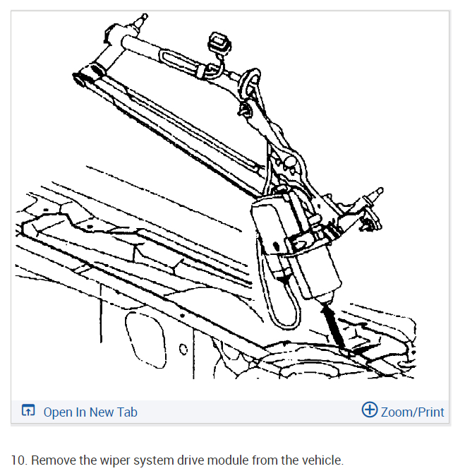

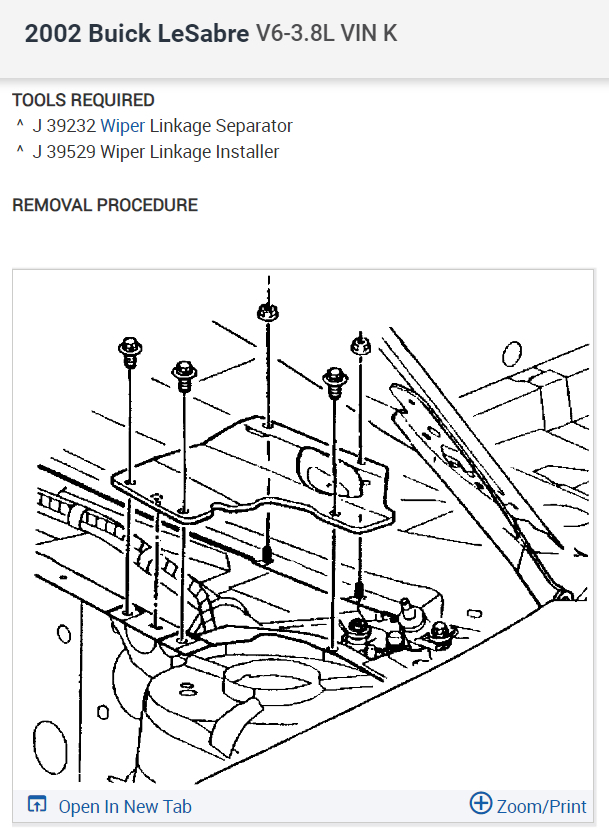

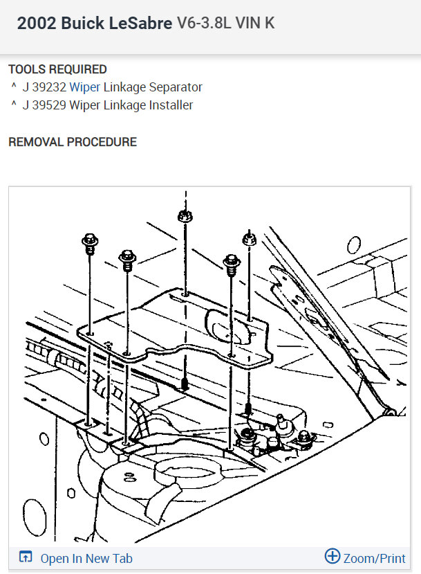

I have seen the windshield wiper control module go out and cause this issue which is inside the wiper motor, you will need to get a new new, here is how to change it out. Check out the images (below). Let us know if you need anything else.
