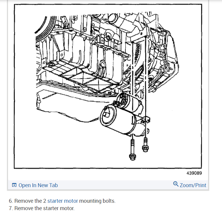

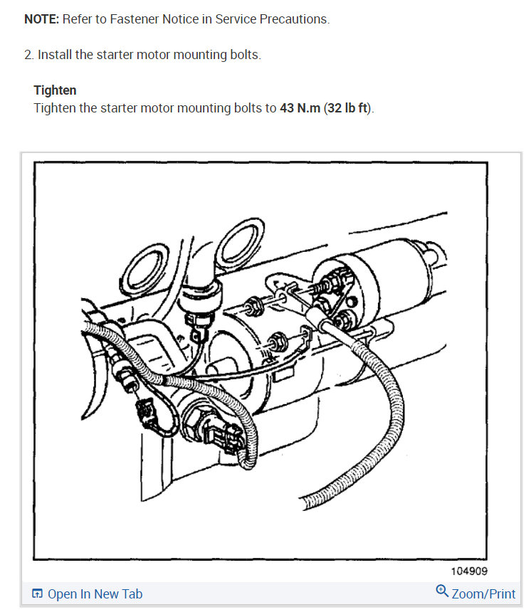

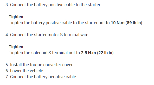

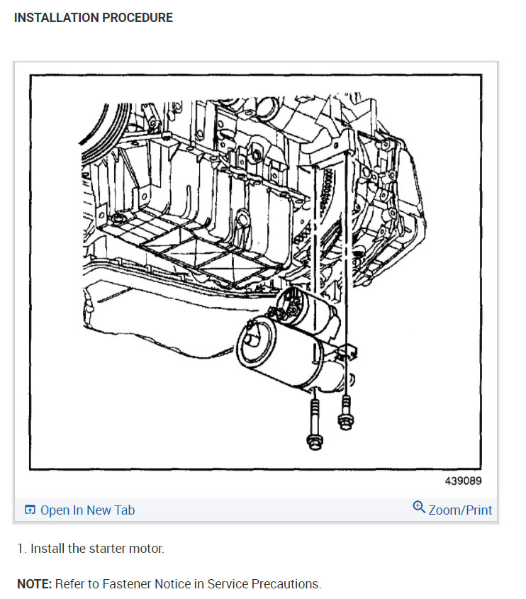

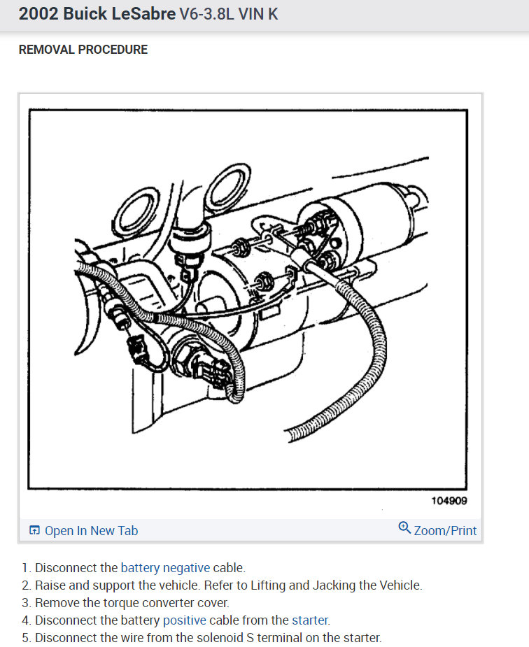

Hi Dossie Lee

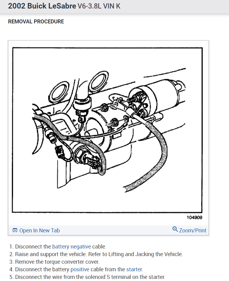

If the crankshaft is not bent, this is common if a cheap starter is used I would suggest and AC delco unit here is a guide to help walk you through the steps with the instructions in the diagrams below to help you on your car.
Check out the diagrams (Below). Please let us know what you find.

my mechanic had already checked the crankshaft and the starter I took the starter to a starter repair shop.the only signs of any wear was the gear that engages the flywheel they replaced it.still the same whine.he has about to give up on it when I handed him the AC delco unit worked perfect! thank you.

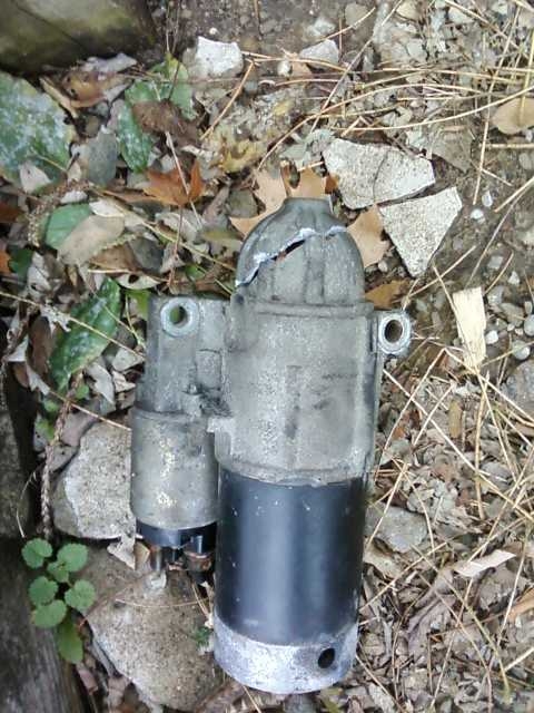

SHARONK
I just put on a starter. the last one had a broken piece on the end. then I started the car, and guess what, this 2nd one broke! help!?
Nov 18, 2020 at 8:11 AM (Merged)
Make sure the starter is fully seated and tight. If there were shims on the original starter, make sure to use them. Finally, make sure the flywheel is tight and not damaged and the engine is free to turn.
