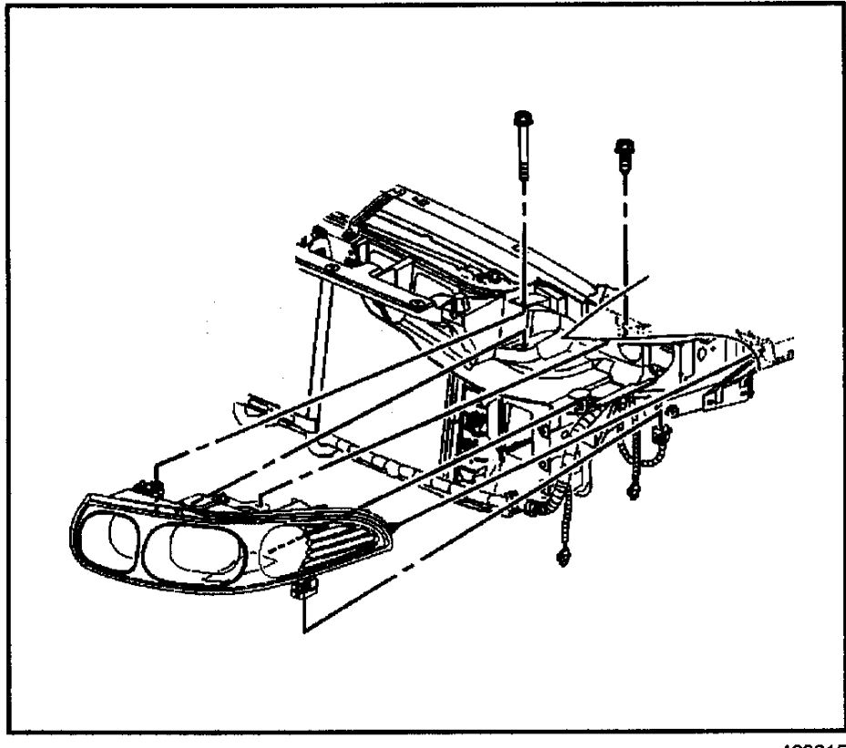

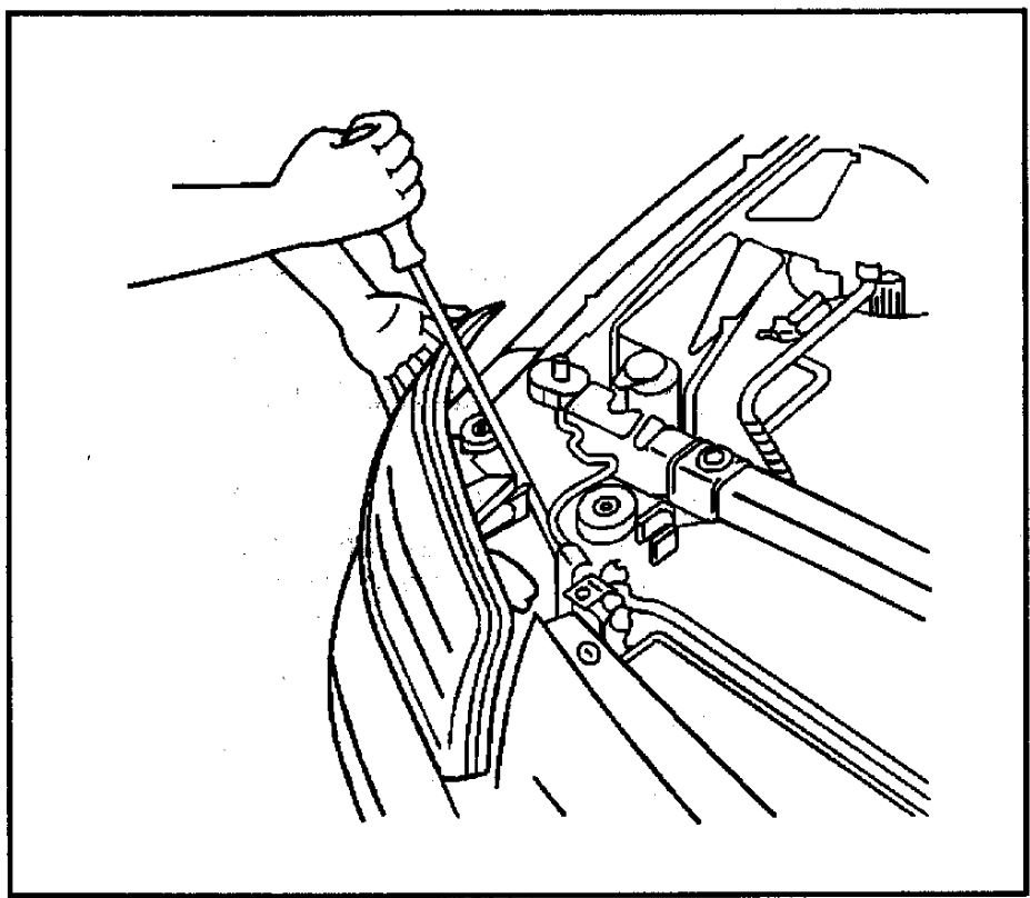

You will have to remove the headlight assemblies.. not too difficult
1. Remove the headlamp fasteners
2. Using a pry bar, gently pry in the center area of the headlamp assembly. Pry the headlamp assembly straight forward in order to unsnap the headlamp ball stud from the ball stud socket.
3. Slide the headlamp straight forward and disconnect the headlamp electrical connectors from the forward lamp wiring harness.
4. Remove the headlamp from the vehicle.
1. Install the headlamp to the vehicle.
2. Connect the electrical connectors.
3. Position the headlamp in order to align the locator pins with the headlamp mounting bracket.
4. Press the headlamp rearward in order to engage the ball stud with the ball stud socket.
NOTE: Refer to Fastener Notice in Service Precautions.
5. Install the headlamp fasteners.
Tighten
Tighten the headlamp mounting fasteners to 9 N.m (80 lb in).
See the diagrams below for fastener locations
