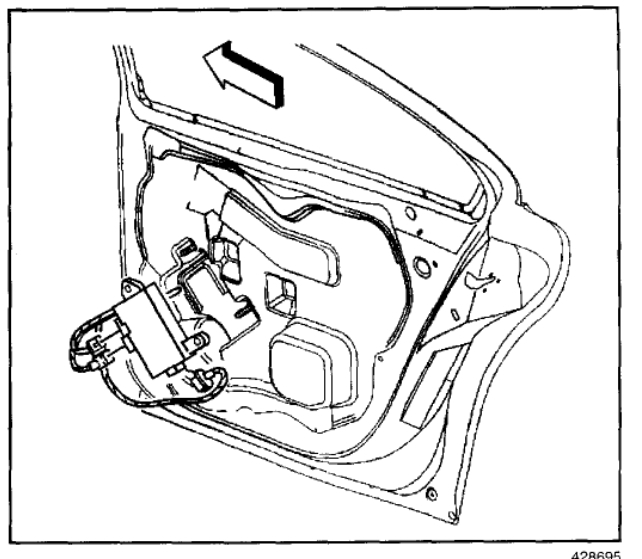

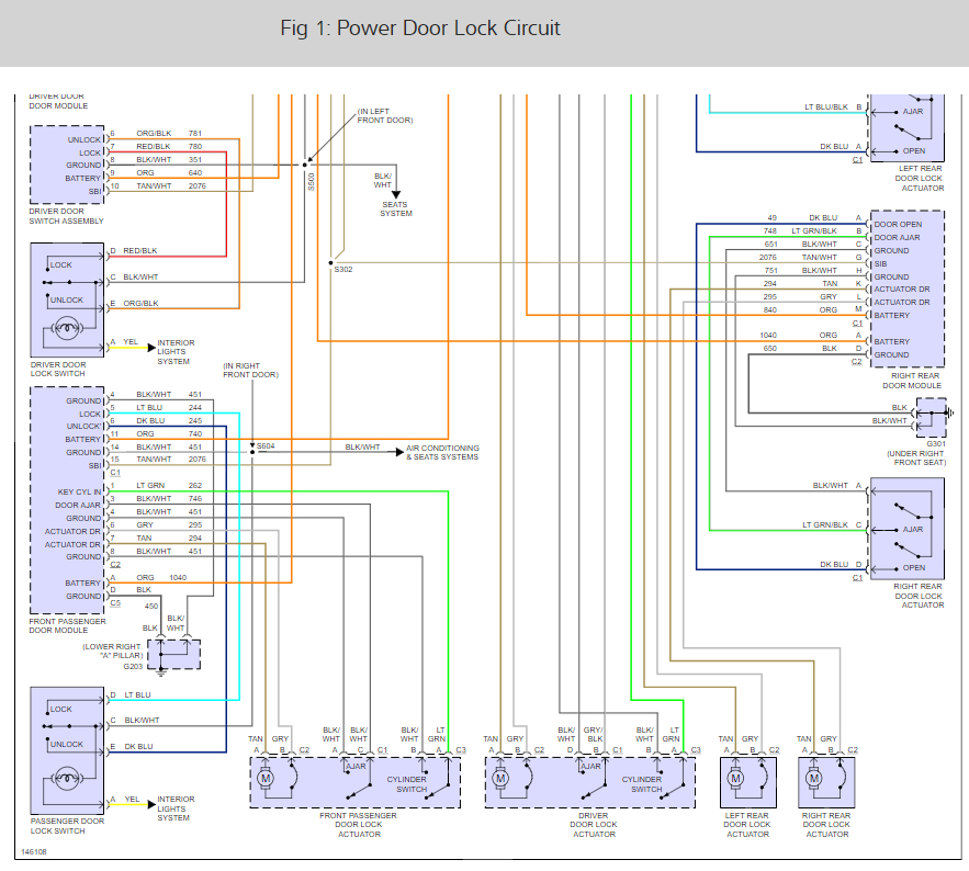

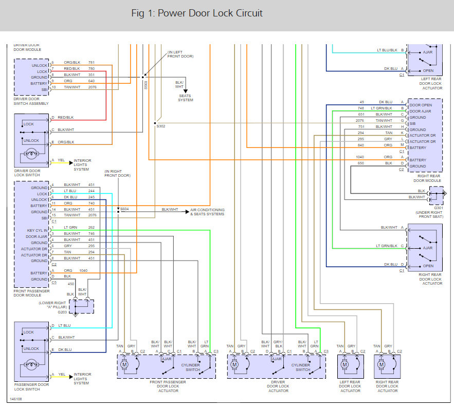

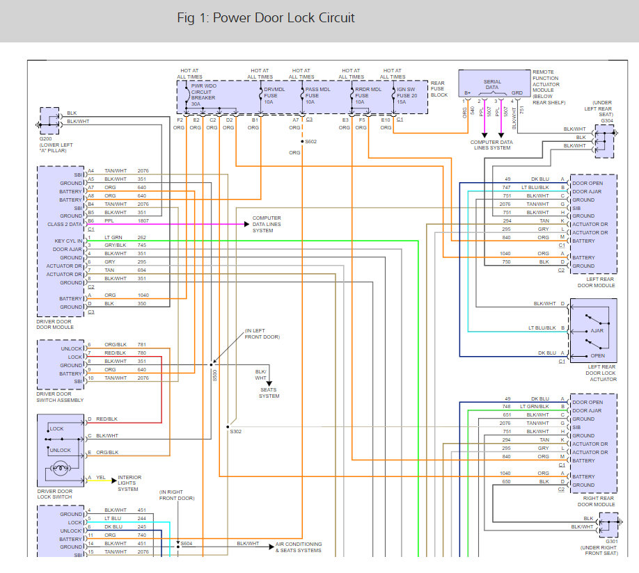

There is a driver door module that goes out on these cars. Here is a wiring diagrams for the windows so you can see how the system works.
You must remove the door panel to get to the module. Here is a guide to help you see what you are in for when doing the job.
https://www.2carpros.com/articles/door-panel-removal
