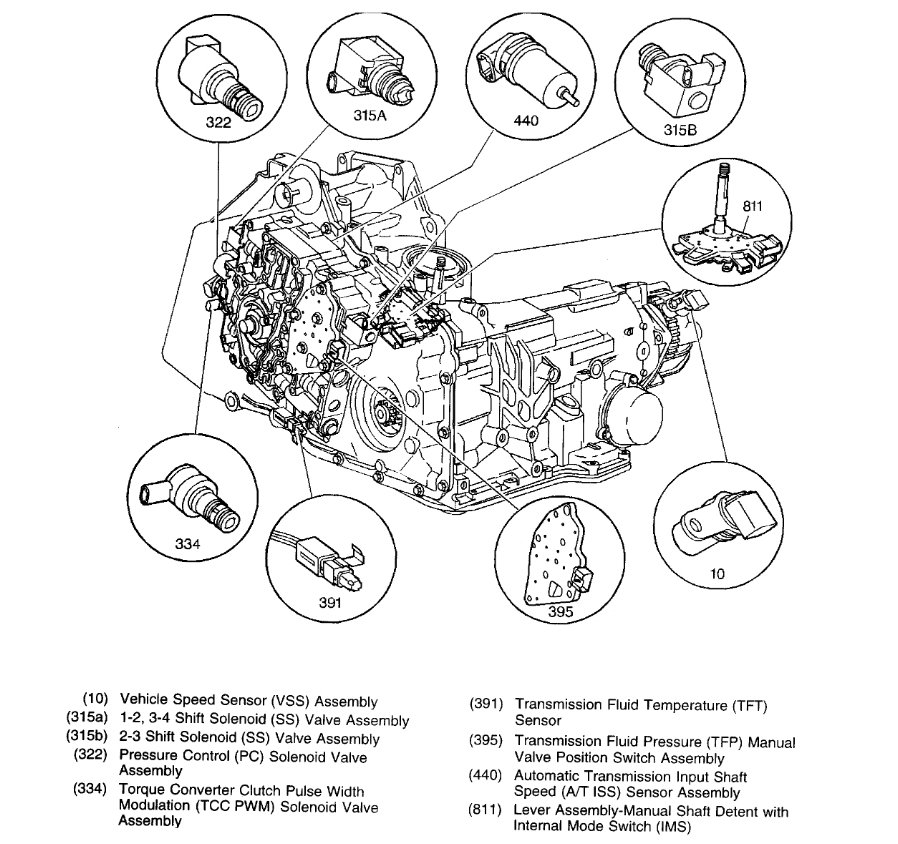

I just replaced the safety switch in my Buick and the switch only costed me $30, but i installed it my self. Check out the diagrams (Below). Please let us know if you need anything else to get the problem fixed.
