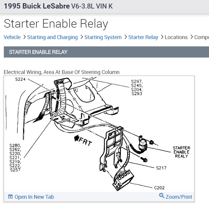

my car wont start had the starter and batttery checked all good they tell me its the starter relay the lights inside the car go dim but the head lights dont go dim
Nov 18, 2020 at 8:17 AM (Merged)
HMAC300
  • 48,601 POSTS
first if you have another key try that as the chip may be bad in your key then switch relay with a like relay to see if it's actually the relay or not.
Here is guide to help
https://www.2carpros.com/articles/starter-not-working-repair
and
Check out the diagrams (Below). Please let us know what happens.
