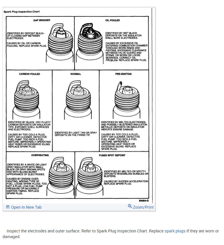

The spark plug gap should be 0.060 inch for this vehicle.
Any time the plugs get inspected be sure to set the gap and check for any oil fouling or carbon buildup.
Here is a helpful guide on spark plug replacement:
https://www.2carpros.com/articles/how-to-change-spark-plugs
I have attached the spark plug inspection chart below.
