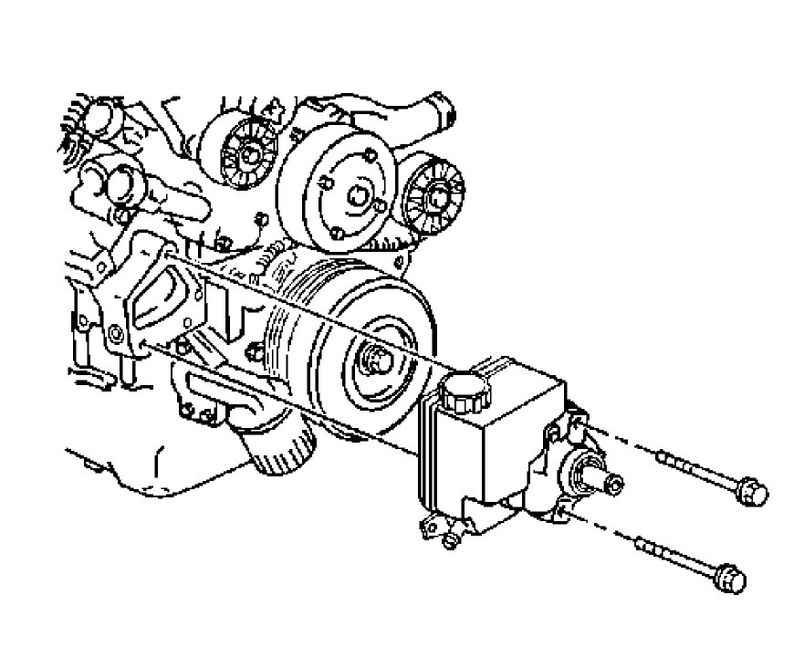

All of these things can make the noise but the most likely problem is the power steering pump. Here is a guide that help you see what you are in for when doing the job.
https://www.2carpros.com/articles/how-to-replace-a-power-steering-pump

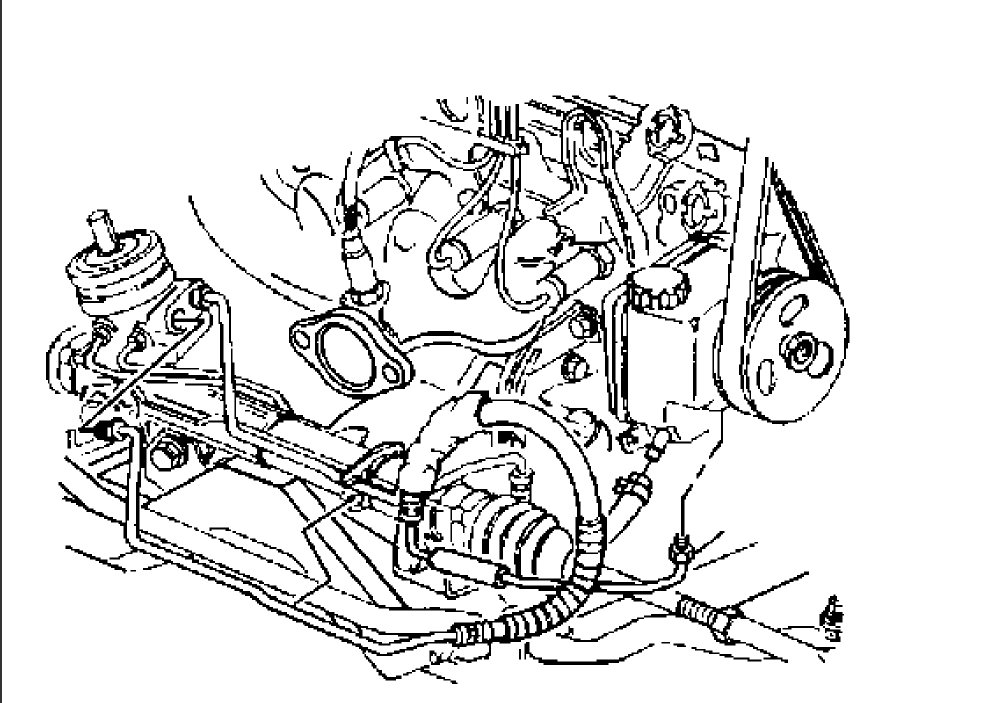

I had the same issue which is why I initially Googled this awhile back. Took my car into my local mechanic and it ended up being my rack and pinion gear box was leaking. Now my car is quiet again! Repair cost on my 2010 Lacrosse total with labor was $884.36.
