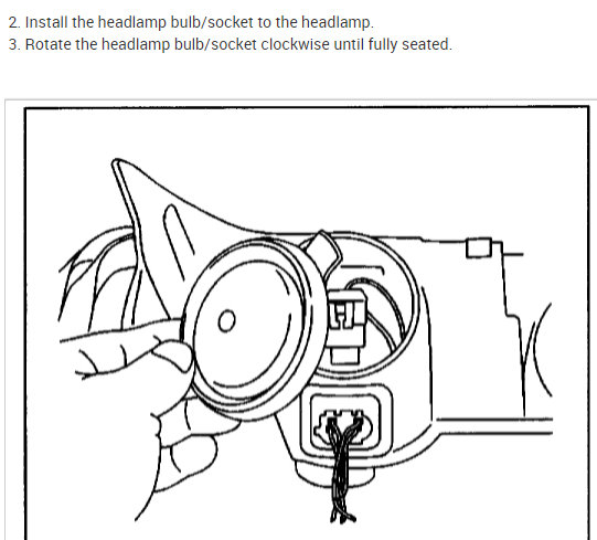

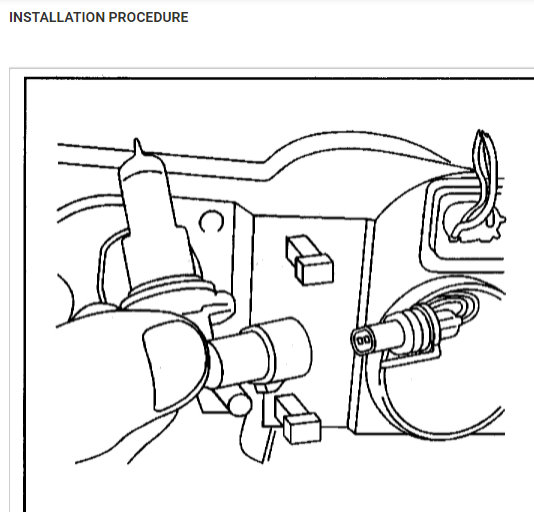

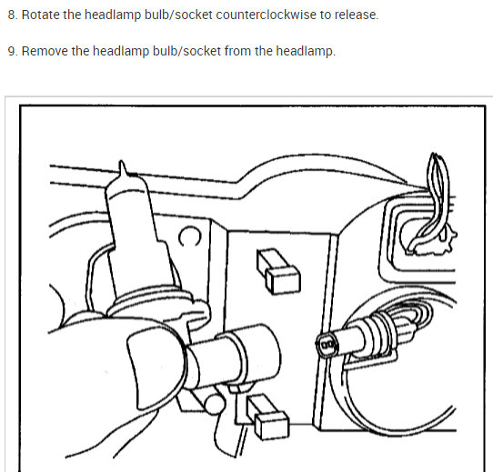

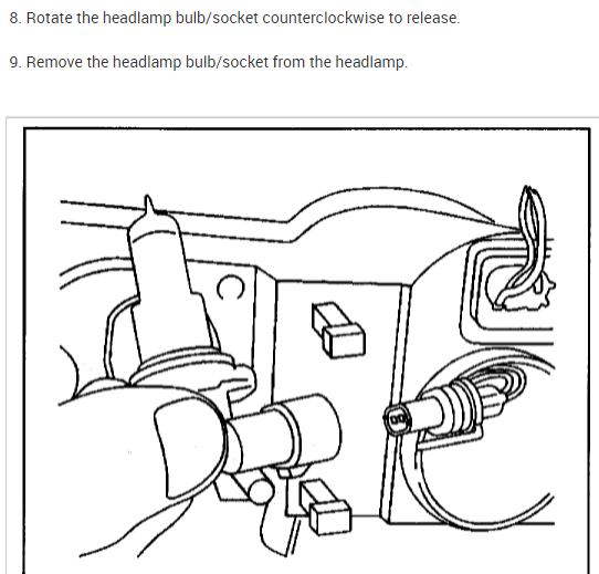

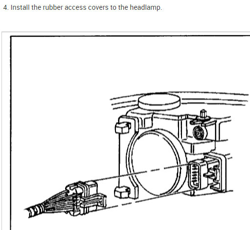

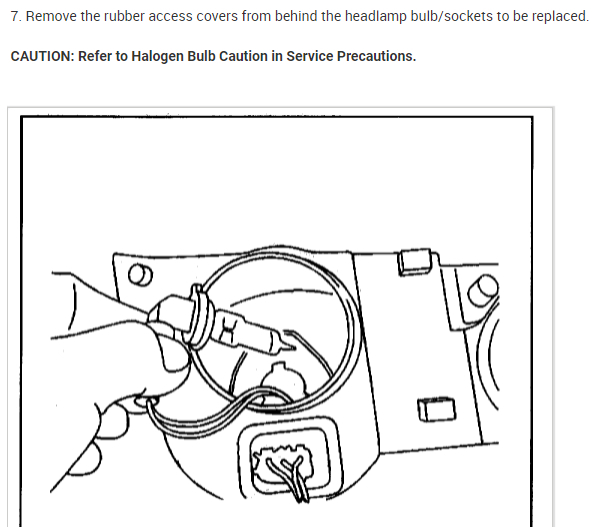

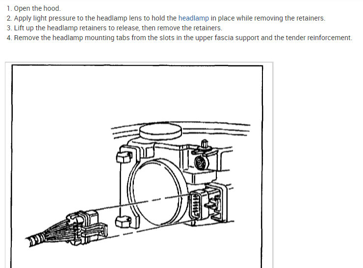

How do you change the Turn Signal bulb for the front? Thanks John Godfrey
Dec 13, 2007 at 8:08 AM
DANNY L
CERTIFIED EXPERT
5,648 POSTS
Hello, I'm Danny.

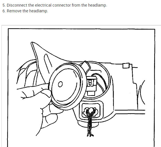

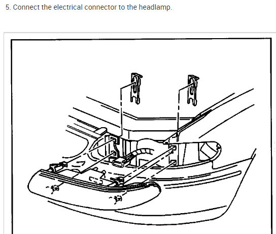

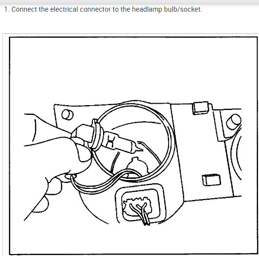

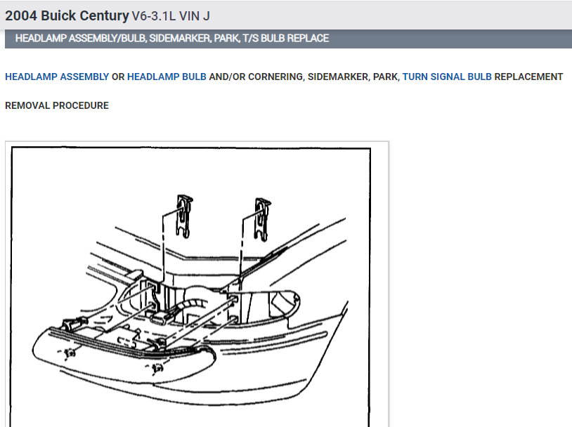

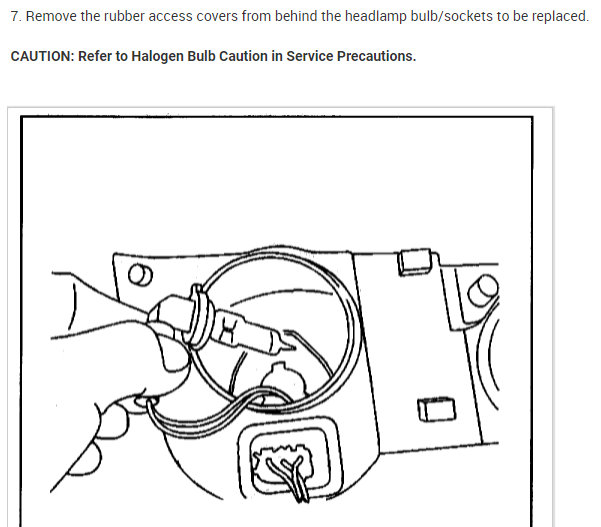

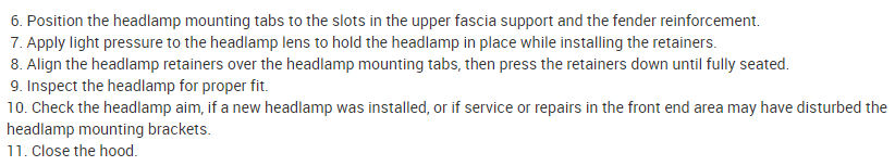

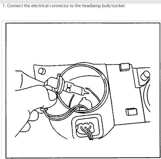

Here is the information you requested. This is a tutorial for you on how to change a turn signal bulb:
https://www.2carpros.com/articles/turn-signal-bulb-replacement
I've attached picture steps below on how to remove and replace the turn signal bulb on your car. Hope this helps and thanks for using 2CarPros.
