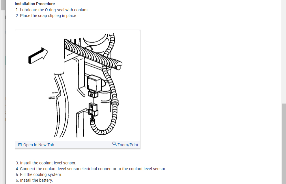

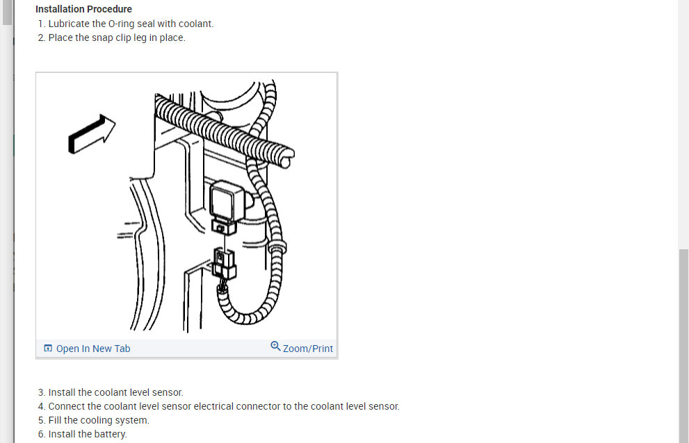

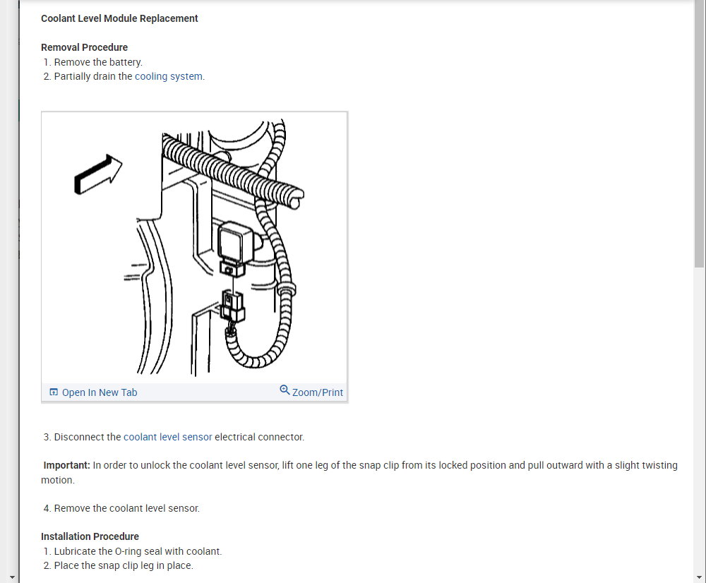

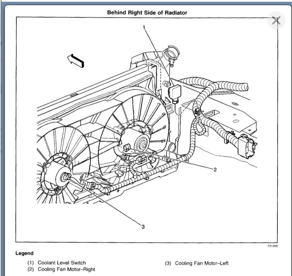

I'll take care of the coolant light issue this week coming.
