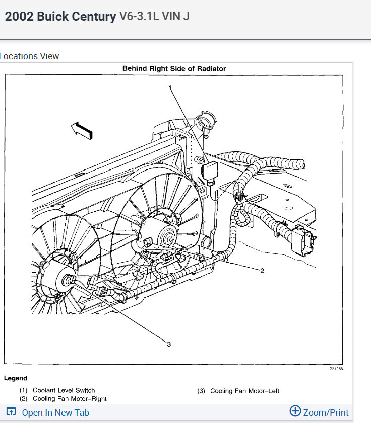

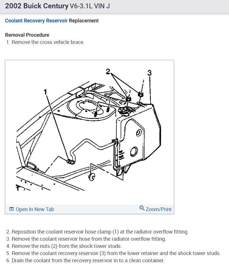

the low coolant light remains on. The coolant reservoir is full and the radiator is full. Where is the low coolant sensor located? I looked to see if it was located at the reservoir but I can't find it. The light is a big pain...

the coolant level sensor is in the reservoir here is a video on how to change it on a similar car with a diagrams below to show you on your car.

I would suspect the level indicator is causing the light to come on. The engine coolant level indicator in located on the passenger side of radiator and the only fix is replacement.

Start with the level indicator sensor my resource calls it a "engine coolant level indicator module".

It is located on the radiator just below the filler neck. Should have a three wire connector and its cliped on the radiator

The low coolant light sensor is in the right side radiator tank. Check out the images (below). Let us know if you need anything else.

suspect faulty / sticking coolant level sensor, at bottom of overflow tank.
