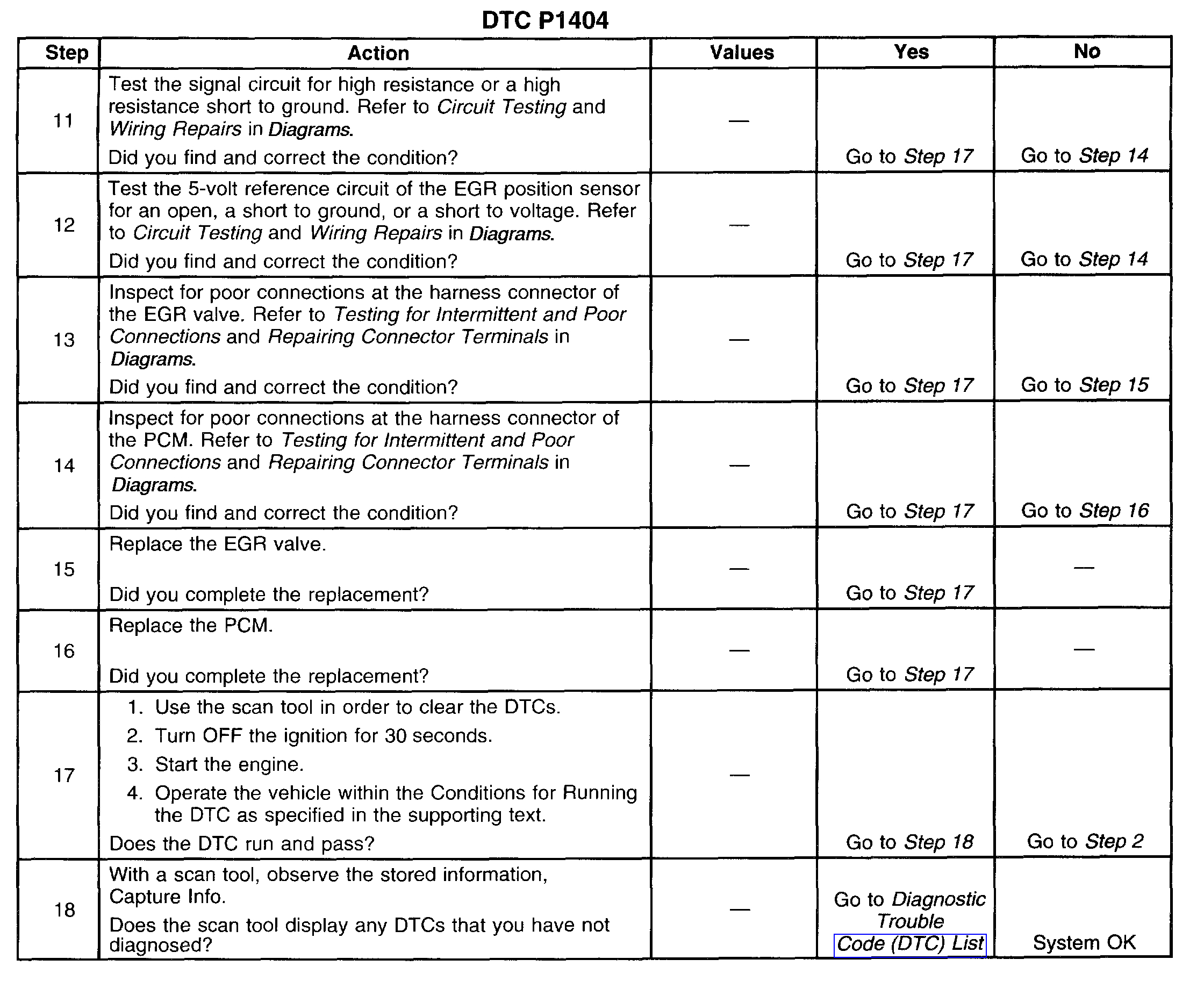

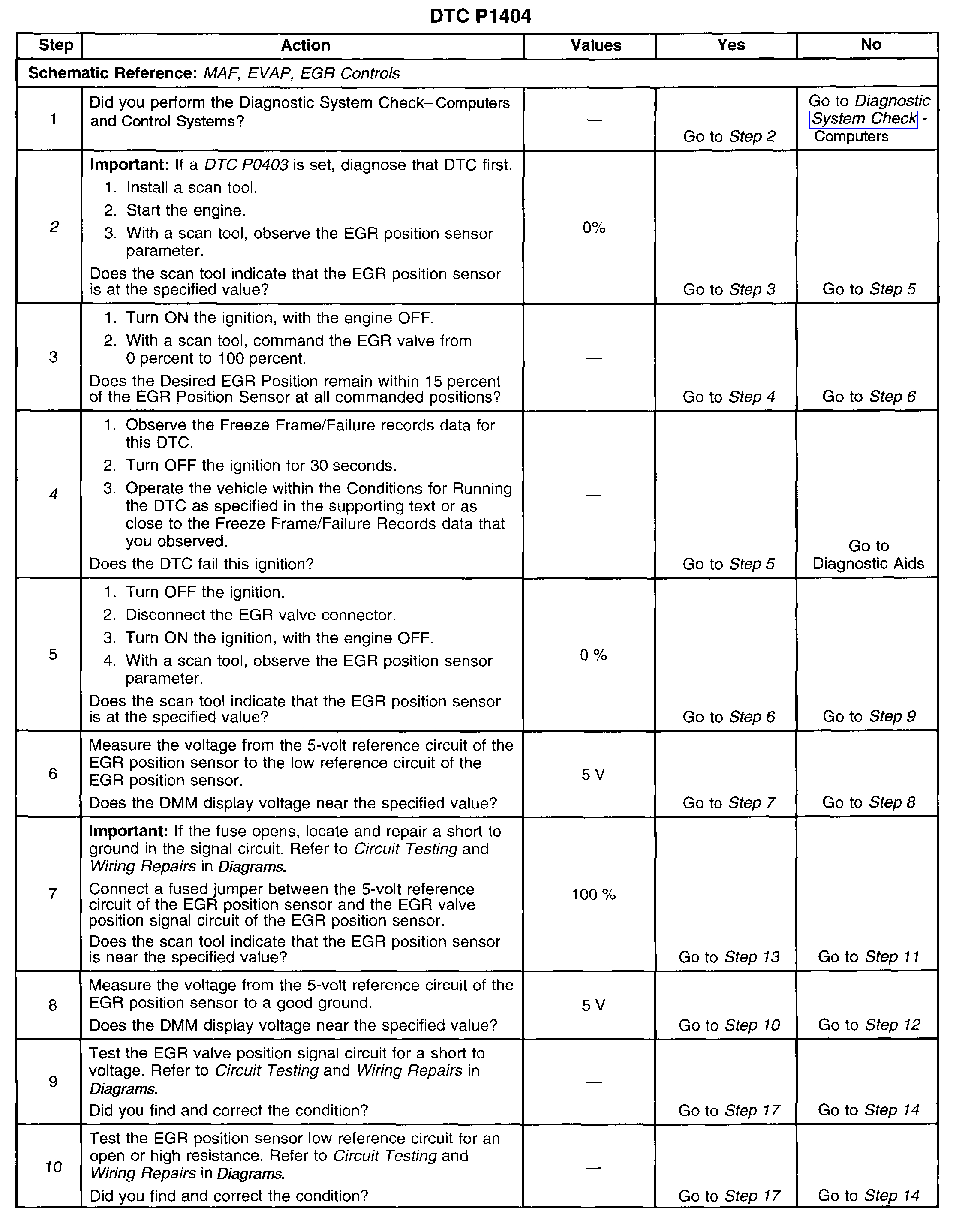

Since you already replaced the EGR and there are no carbon issues, that leads to testing. I have attached two pics below which are basically a diagnostic flow chart for determining the cause of the problem. Take a look through them and see if anything helps.
