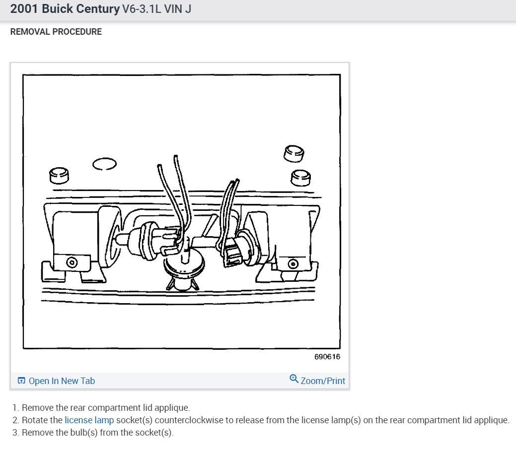

how to replace a license plate light bulb?
Oct 27, 2008 at 9:38 PM
Hi:
Here is the instructions and diagrams below to show you how to replace the license plate light bulb in your car. Check out the diagrams (Below). Please let us know if you need anything else to get the problem fixed.

How to I replace the license plate lights. On my Buick Century deluxe model?

Hello –
I am sorry – we don’t have any pics or directions to show you for this from the manufacture. If you look up under there you should see a couple of light lens covers that probable screw on. Just remove the screws and remove the bad bulbs.
If you can’t read the bulb number places like AutoZone and O’Reilly’s can look that up for you.
If you need more assistance then try to take a pic of the area and attach.
Hope that helps.

How do you replace the license plate lamps
Feb 8, 2019 at 5:51 PM (Merged)
From in the trunk, you need to remove the wing nuts holding the lens cover on the deck lid. Once they are off, you can remove the cover over the lights and access them.
SADOFSKYJ
It looks like there are about 7 larger bolts looking from underneah the trunk. Is the lens cover also covering the rear tail lights?
Actually, the len assembly will come out as a unit and the bulbs will be accessable from behind it.
