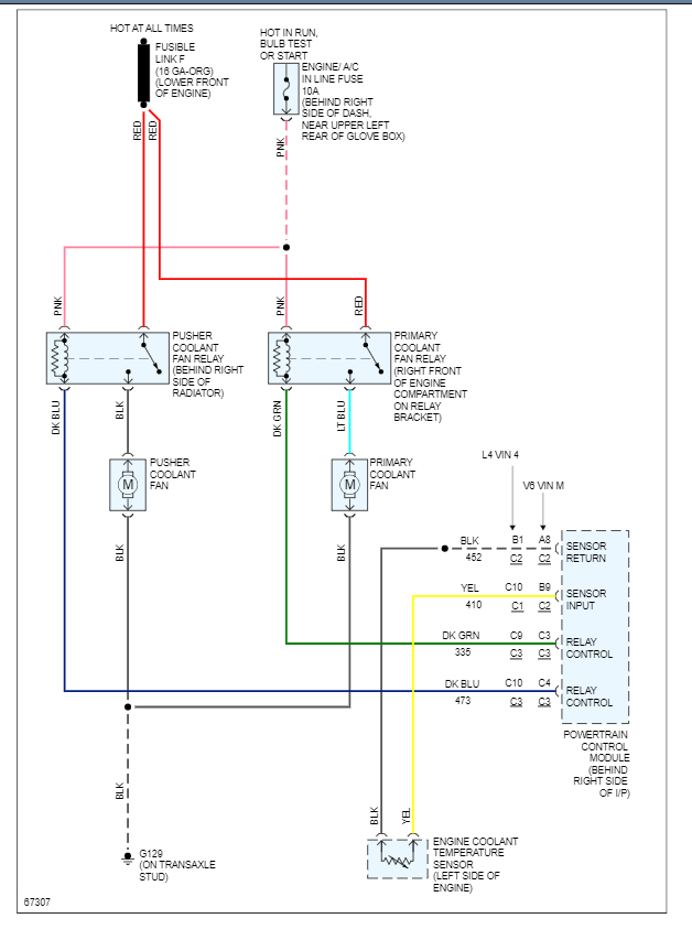

PCM controls AC comp and fan relays upon a signal from Heater-AC control head. Does blower fan work on all speeds and does mode select operate? How where relays tested?
Here is a guide to check for power and the wiring diagrams for the air conditioner systems with the pressure switch locations so you can see how to test it.

At primary fan relay locate Dark Green wire goes to PCM attach test light to batt POS. probe wire does it light when AC is requested? do same at AC comp relay Dark green/Wite wire. if no light and fans don't come when engine hot then PCM at fault. Don't know what happened but suspect PCM was back probed with high impedence devise like test light and fried something.

Interesting development. I cut the red wire on the coil of the cooling fan relay and hard wired it to(+). The cooling fan will operate when AC is on AND operate when engine gets hot. How is the "hot" side supplied to the fan relay? At least the cooling fan will operate "normally" with this fix, however that still leaves the question of what happened to the AC.

Here are the wiring diagrams for the cooling fans and a guide to help you check for power so you can see how the system works and where it is losing power.
