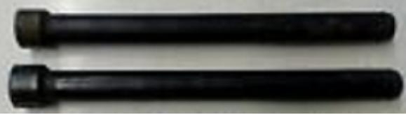

GM also uses odd lower strut bolts. The heads have just two flats for a wrench. Those have to be pounded out after the nuts are removed. There's splines under the heads, so they can't be turned or unscrewed. Chrysler used a cam bolt for their lower bolt. Those have offset heads that sit in a pocket formed into the bottom of the strut. As it is rotated, it pushes the wheel in or out making it very easy to get a very precise setting. Aftermarket struts for most GM models come with the same pocket, but you have to buy the special cam bolts. Besides making the adjustments easy, those heads help hold the adjustment in position and prevent shifting from hitting bumps and potholes. There are other bolt designs made for this purpose. You might consider talking with your alignment specialist to see what he recommends.

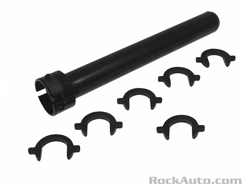

A lot of GM inner tie rod ends require a special socket with a set of different sizes of crow's foot wrenches to grab two flats on the back side of the ball and socket. Check out the first photo. You can borrow that tool from any auto parts store that rents or borrows tools. In my city, they make you buy the tool, then you get a full refund when you return it. If you choose to keep a tool, you still return it, then they order or give you a brand new one. Pick the crow's foot that fits the joint. While holding it in place, slide the socket over it so the two tabs slide into the two slots on the tube. There's a stamped steel ring to rotate that locks the wrench to the tube. Pull out gently on it to keep the wrench on the flats, then use a 1/2" ratchet to unscrew the joint. Normal threads. Turn it counterclockwise to unscrew it. Other tie rod designs require a different special socket to fit a standard hex head around the joint. Those come in two different sizes. Some of them have both sizes built into one tool. All of these are roughly 15" long to slide over the threaded shaft.
Oops, forgot to mention the accordion boot has to be removed first. There's a small spring clamp around the small end. It's common to find a squeeze band around the inner, larger end. Once the ends are snapped together, there's a section to crimp to compress and tighten that band. If you run into frustration trying to stretch them to get them off, and to squeeze them to put it together, . . . welcome to my world. Try whatever you can dream up. At worst you'll have to replace that band. In a pinch, a larger nylon tie strap will do the job. There's a special pliers to tighten the crimp when installing that band. It has a shoe in the middle to push the crimp down. That's mainly for use on CV joints where that crimp could stick up high enough to hit something as the shaft rotates. If you have the room and can fit that pliers in there, it can be used to loosen the band too. Grab the crimped section loosely, then twist the pliers left and right to tug on the crimp. That will stretch it, sometimes enough to allow the band to be unsnapped.
Be aware there's a small metal tube plugged into both of the boots. That just transfers air in them back and forth as you steer. Nothing has to be sealed, but don't forget to pop that back in when the boot is reinstalled.

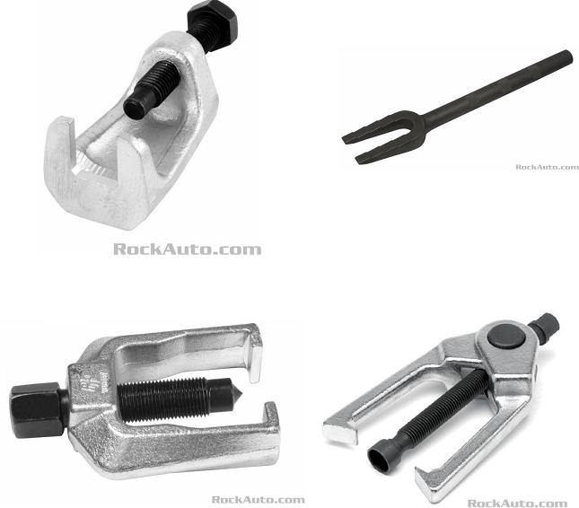

The third photo shows some tools for removing the outer tie rod's tapered stud from the steering arm. An alternative trick is to bang on the side of the arm next to the stud once the nut is removed. The shock is often enough to break the taper.

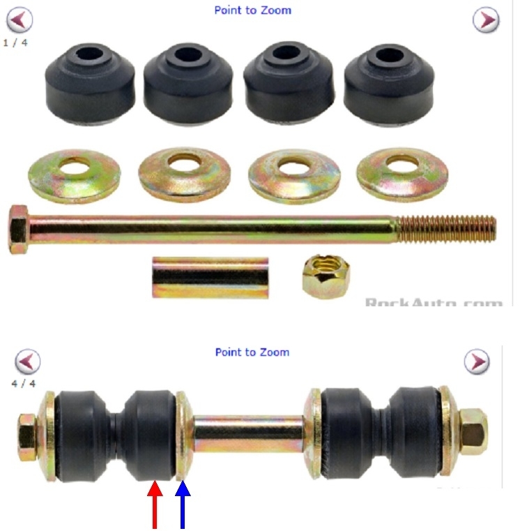

Your model uses the most common anti-sway bar link design. It has been around since forever. See the fourth photo. The top shows the pieces you get in the kit for one link. When these fail, they sound like a tambourine on bumpy roads. Getting the old ones off usually requires an air-powered cutoff tool or an angle grinder. The nuts get rusted tight and commonly round off. The big secret to these is you do not fully tighten the nut when installing them. Rather, run the nut down until the rubbers expand to exactly the same diameter as the steel washers, as shown in the fourth photo, (red and blue arrows), at the bottom. GM used to use shock absorbers with a threaded stud on top, and two rubbers like those shown here. The same applies. When tightening the nut, do so just until the rubbers expand to the same diameter as the metal washers. If those are over-tightened, they'll bind or pinch when that stud needs to tip and swivel a little as the vehicle bounces up and down.
