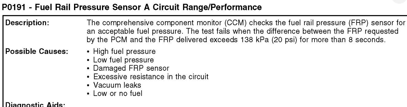

Bought a "project" SUV listed above XLT. So far I've replaced the fuel rail pressure sensor, the Mass air flow sensor, and the fuel pressure regulator mounted on the frame rail. I'm still getting a P0191 code, with the transmission-like bucking and kicking under a load (or climbing a hill).
Also, in the last two weeks, I've done a complete throttle body cleaning and replaced a missing 20A fuse from F1.34 in the fuse box that reportedly signals the MAF sensor. (It was completely missing)
