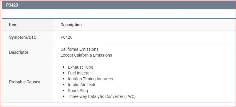

It is a CTV transmission. AWD. Sorry i should've put it in the description. Another note, I took it to AutoZone to pull codes, and the same code came up three times in a row. P0420 catalytic converter system below threshold. Thanks for any input.

Okay. There are three major things that this could be.
1. Due to the DTC P0420, it could be a misfire that is damaging the converter causing it to not reduce the emission like it should and it sets this code. However, this code could be set due to a faulty o2 sensor as well so we need to diagnose this by monitoring the short term fuel trim and see if the exhaust has excessive fuel in it. This would point to a misfire causing the issue.
Let me know if you have replaced the sensor and what the short term fuel trim is and we can go from there.

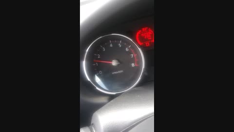

Okay thank you for the information. I'm not sure if a video posted with my original question, but I'll upload a video of the rpm gauge to better show you how it "bounces".

Thanks Amber. I did not see that before. That is not very drastic but if the jerking sensation corresponds with this then I think you are at the beginning of the belt slipping. Before, you condemn it we should have the other two theories tested because they will be pretty definitive if they are the cause.
Again, I am not seeing anything to make me think it is not the steel belt slipping but it is the most intrusive thing so we need to leave it to last.
