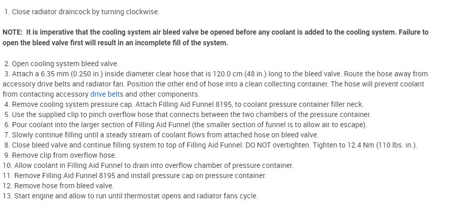

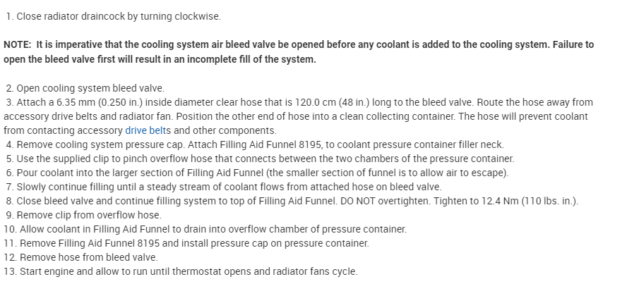

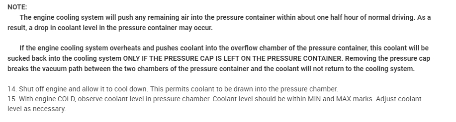

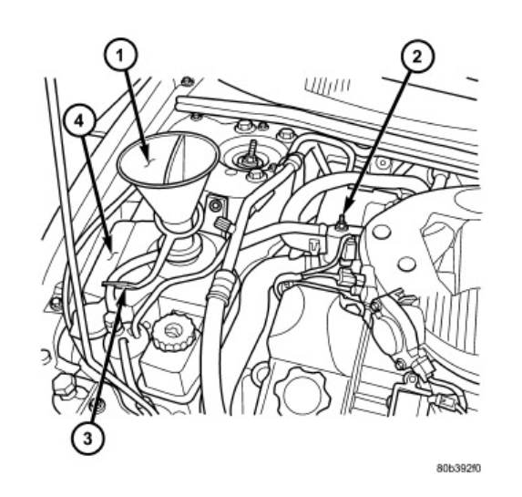

See pic 1. Number 2 is the bleed valve. Follow the directions in pics 2 and 3 to make sure you have all air from the system.

Hi again, we have just tried the above suggestion. We kept pouring coolant in the water reservoir, but it became full of coolant so could not add more and did not get to the point where it was overflowing in a constant stream. And now the coolant seems to be just sitting there as well and not going anywhere.
Dec 4, 2022 at 12:11 AM
If air continued coming from the bleeder, I feel this was the problem. Close the bleeder and start the engine to see if we now have heat. Also, if the reservoir is over full, try to remove some to get it to the full mark. Don't laugh, but I use a turkey baster. LOL

I forgot to mention that we took the bleeder screw completely out and only then did we see the constant flow but as soon as we put the screw in again it stopped. Thanks for your time.
