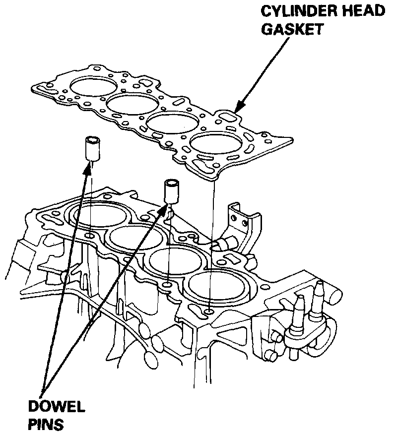

If the gasket hasn't been replaced yet, you should do it. Here are the install directions once you have the engine apart. It indicates torque specs and how to put it back together.
INSTALLATION
Install the cylinder head in the reverse order of removal:
NOTE:
- Always use a new head gasket.
- Cylinder head and cylinder block surface must be clean.

1. Cylinder head dowel pins must be aligned.
2. Position the camshaft correctly.

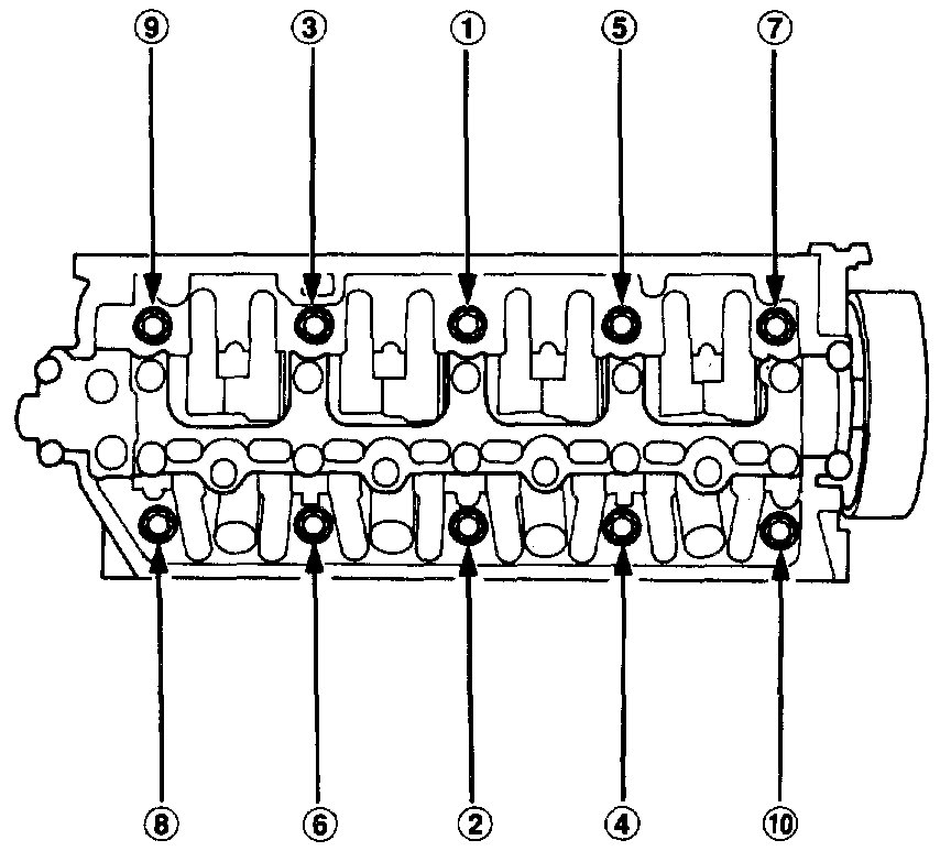

3. Tighten the cylinder head bolts sequentially in four steps.
1st step: (1) - (10) 20 Nm (2.0 kgs.cm, 14 ft.lbs.)
2nd step: (1) - (10) Nm (5.0 kgs.cm, 36 ft.lbs.)
3rd step: (1) - (10) Nm (6.8 kgs.cm, 49 ft.lbs.)
4th step: (1), (2) Nm (6.8 kgs.cm, 49 ft.lbs.)
See picture 2
CYLINDER HEAD BOLTS TORQUE SEQUENCE:

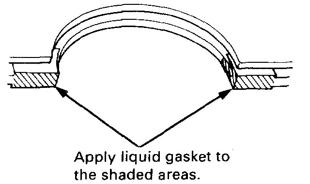

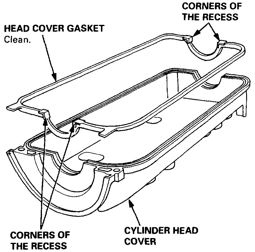

9. Install the head cover gasket in the groove of the cylinder head cover. Seat the recesses for the camshaft first, then work it into the groove around the outside edges.
Note:
- Before installing the head cover gasket, thoroughly clean the seal and the groove.
- When installing, make sure the head cover gasket is seated securely in the corners of the recesses with no gap.
See picture 4
10. Apply liquid gasket to the head cover gasket at the four corners of the recesses.

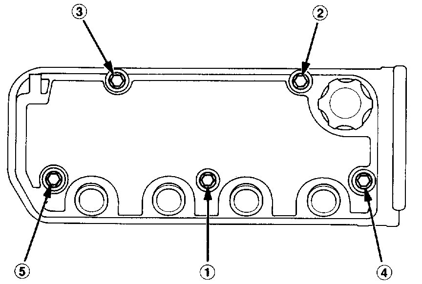

See picture 5

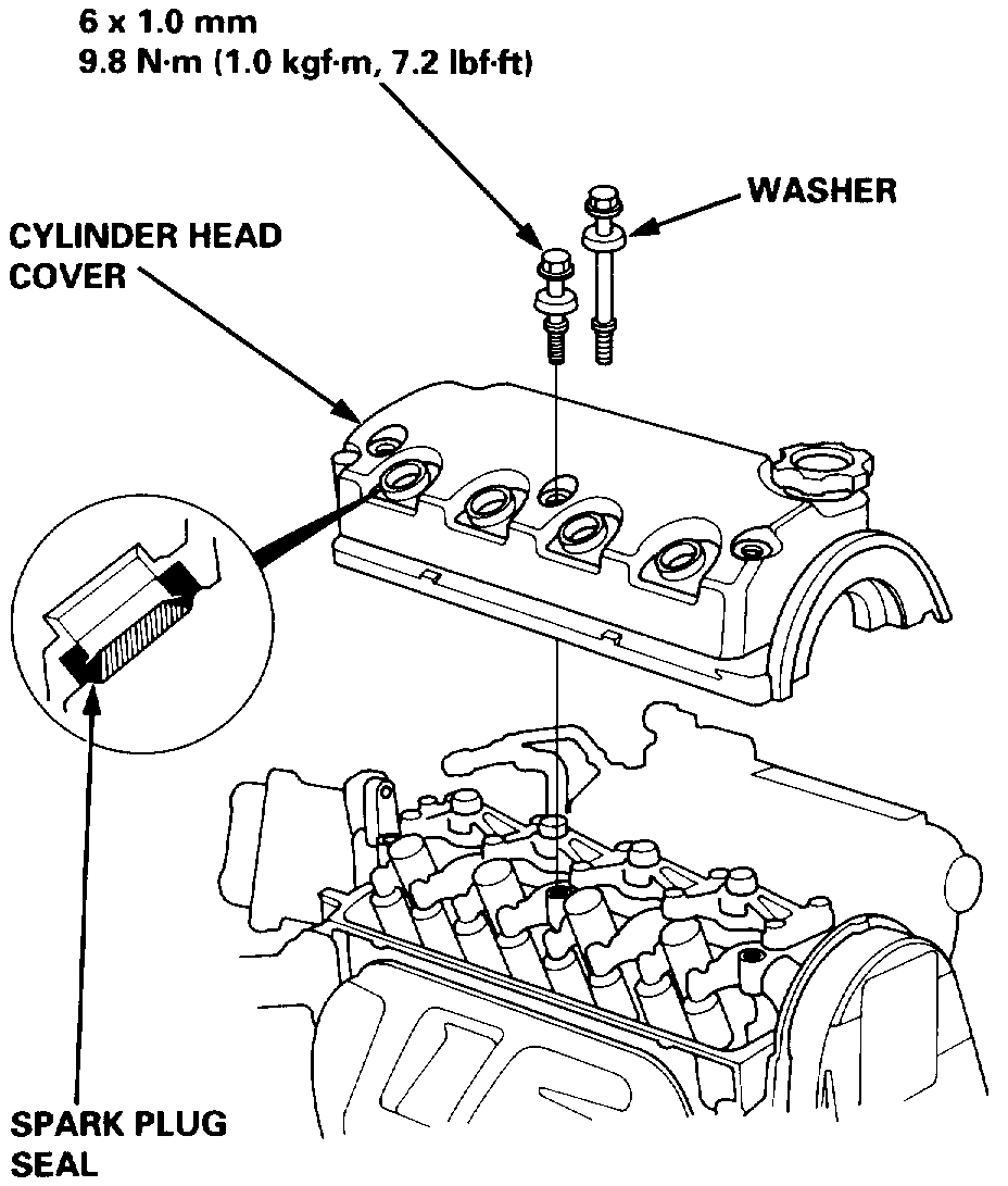

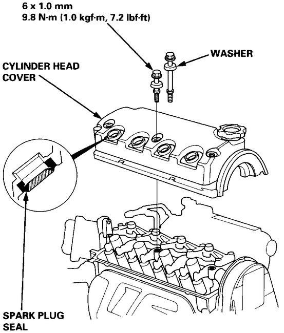

11. When installing the cylinder head cover, hold the head cover gasket in the groove by placing your fingers on the camshaft holder contacting surfaces (top of the semicircles).
Set the spark plug seal on the spark plug tube.
Once the cylinder head cover is on the cylinder head, slide the cover slightly back and forth to seat the head cover gasket.
Note:
- Before installing the cylinder head cover, clean the cylinder head contacting surfaces with a shop towel.
- Do not touch the parts where liquid gasket was applied.
- Take care not to damage the spark plug seals when installing the cylinder head cover.
- Visually check the spark plug seals for damage.
- Replace any washer that is damaged or deteriorated.

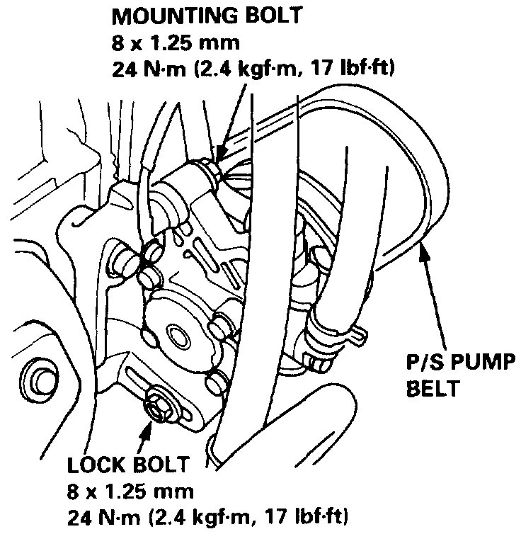

2. Loosen the mounting bolt and lock bolt, then remove the Power Steering (P/S) pump belt and pump.
3. Loosen the idler pulley center nut and adjusting bolt, then remove the Air conditioning (A/C) compressor belt.

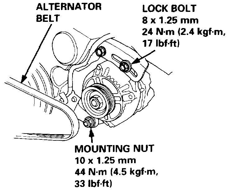

4. Loosen the mounting nut and lock bolt, then remove the alternator belt.
See picture 9

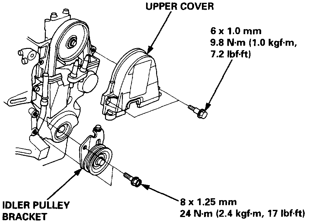

5. Remove the dipstick, then remove the upper cover and idler pulley bracket.
Note: Do not use the upper cover to store removed items.

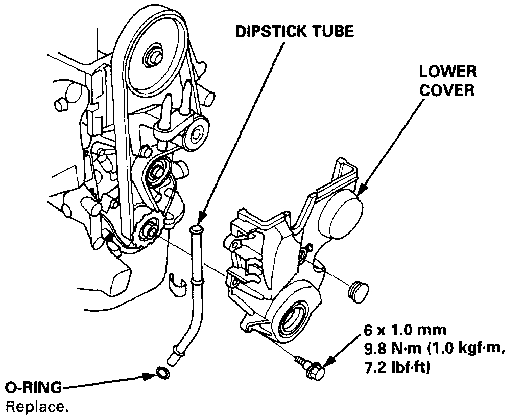

8. Remove the lower cover and dipstick tube.
NOTE: Do not use the lower cover to store removed items.
See picture 11

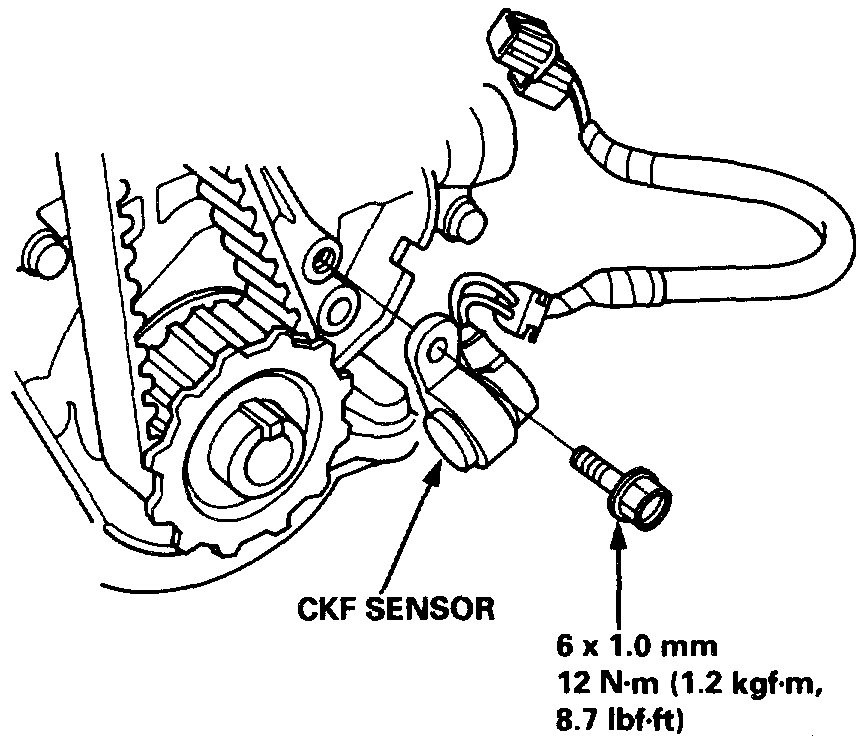

9. Remove the CKF sensor from the oil pump.
See picture 12

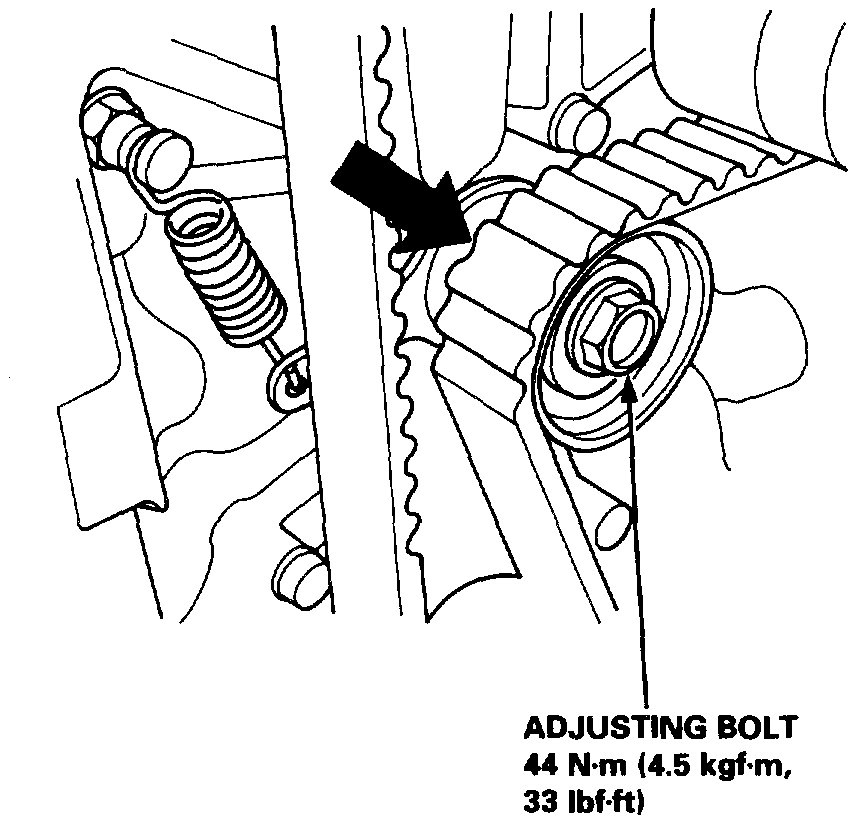

10. Loosen the adjusting bolt 180°. Push the tensioner to remove tension from the timing belt, then re-tighten the adjusting bolt.

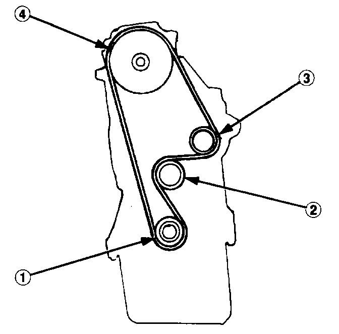

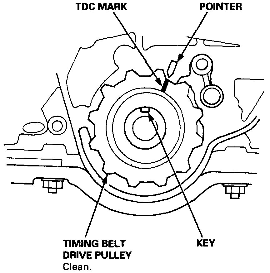

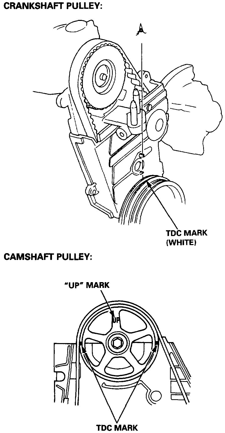

1. Set the timing belt drive pulley so that the No. 1 piston is at Top Dead Center (TDC). Align the groove on the timing belt drive pulley to the pointer on the oil pump.
See picture 14

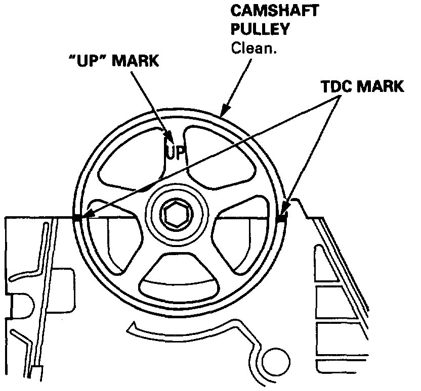

2. Set the camshaft pulley to TDC. Align the TDC marks on the camshaft pulley to the cylinder head surface.
3. Install the timing belt tightly in the sequence shown. (1) Timing belt drive pulley (crankshaft) -> (2) Adjusting pulley -> (3) Water pump pulley -> (4) Camshaft pulley.
Note: Make sure the timing belt drive pulley and camshaft pulley are at TDC.
See picture 15
4. Loosen and re-tighten the adjusting bolt to tension the timing belt.

9. Check that the crankshaft pulley and camshaft pulley are both at TDC.
10. If the camshaft and crankshaft pulleys are not positioned at TDC, remove the timing belt and adjust the position. Then reinstall the timing belt.

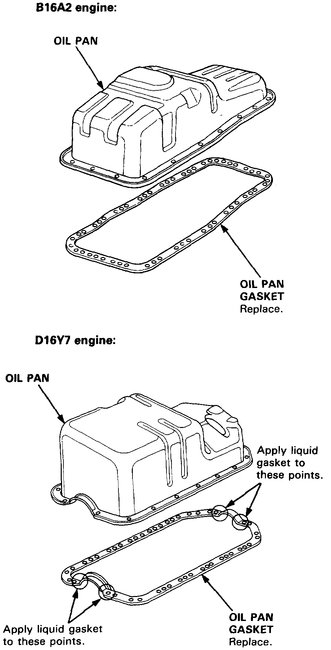

OIL PAN INSTALLATION
B16A2, D16Y7 Engines:
Picture 1

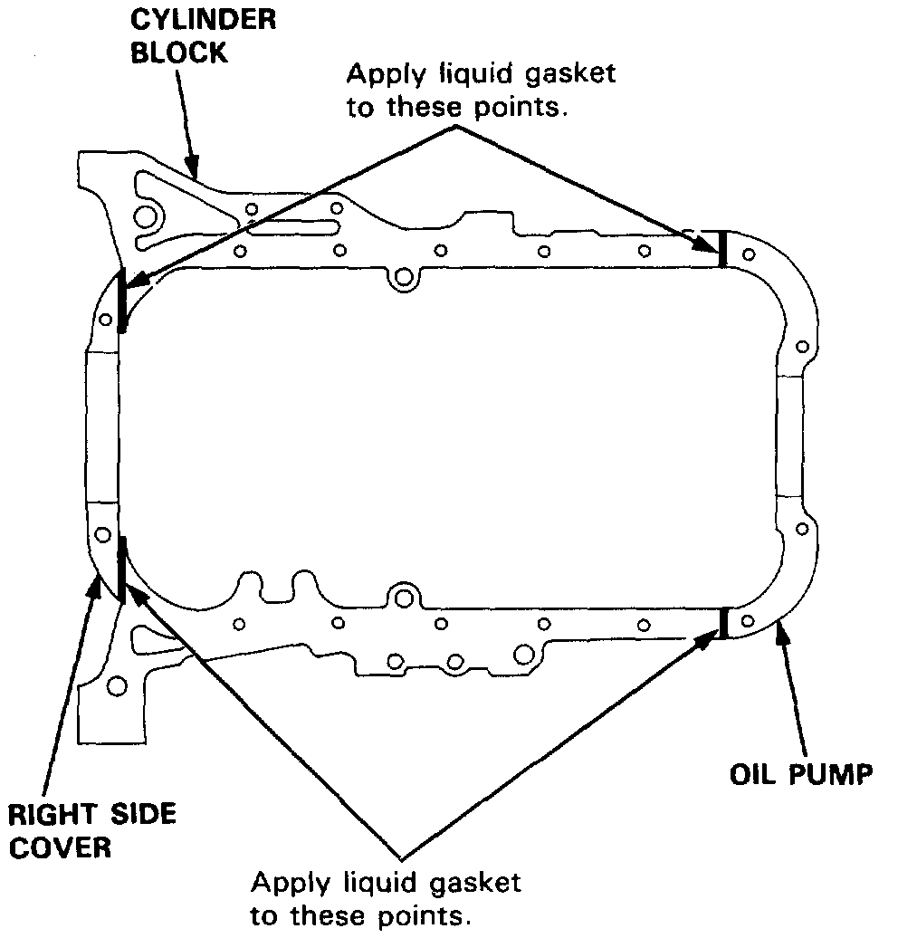

1. Apply liquid gasket on the oil pump and right side cover mating areas as shown below.
NOTE:
- Use liquid gasket, part No. 08718-0001 or 08718-0003.
- Check that the mating surfaces are clean and dry before applying liquid gasket.
- Apply liquid gasket as an even bead, centered between the edges of the mating surface.
- To prevent oil leakage, apply liquid gasket to the inner threads of the bolt holes.
- Do not install the parts if five minutes or more have elapsed since applying the liquid gasket. Instead, reapply liquid gasket after removing the old residue.
- After assembly, wait at least 30 minutes before filling the engine with oil.
Picture 2

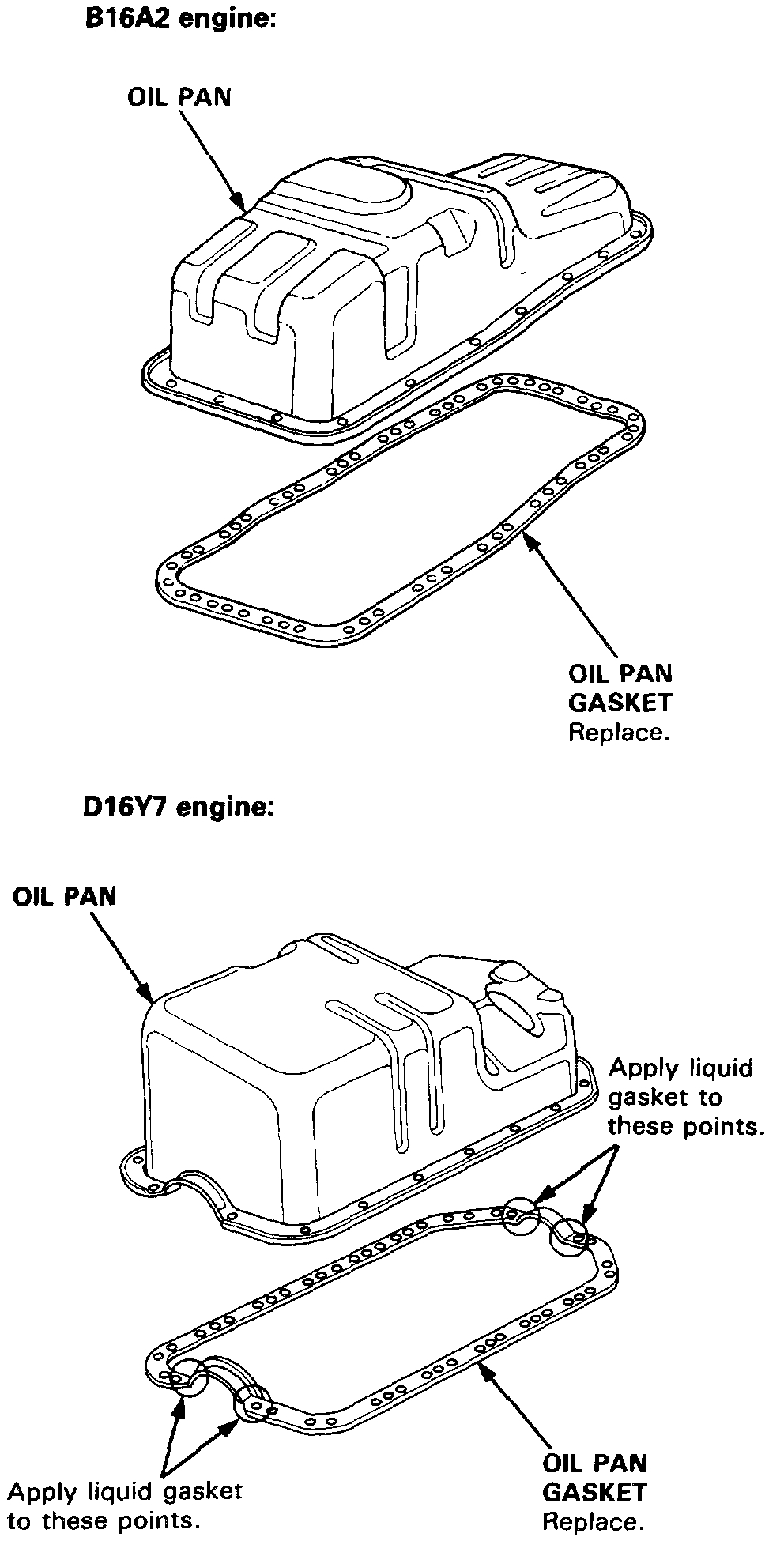

2. Install the oil pan gasket and oil pan.
NOTE:
- Use a new oil pan gasket.
- Install the oil pan no more than five minutes after applying liquid gasket.

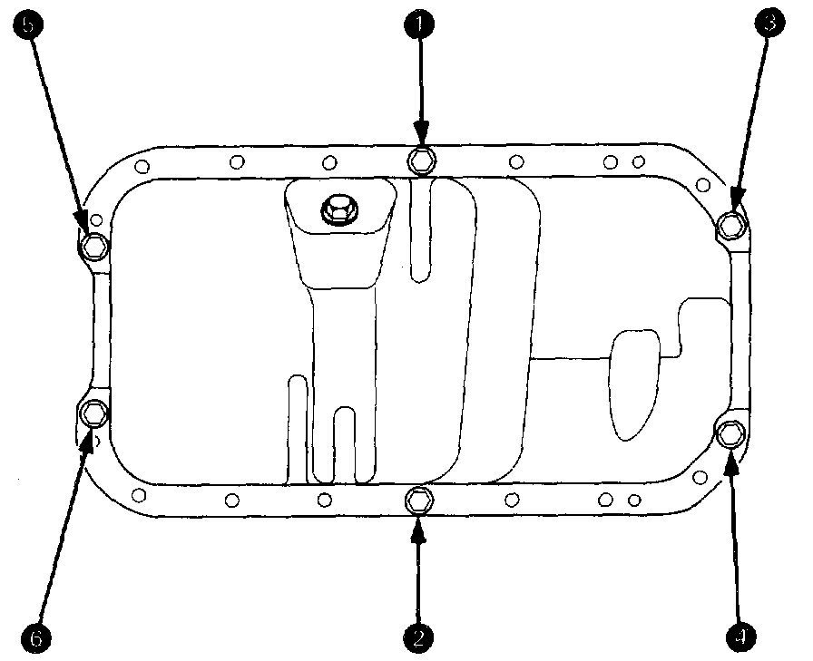

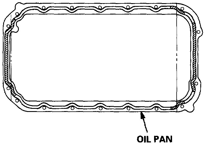

Picture 3

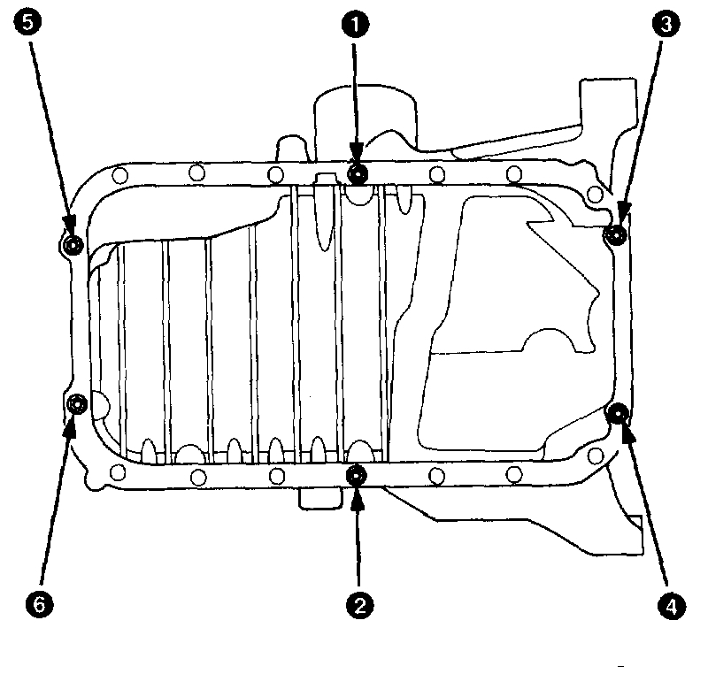

3. Tighten the bolts and nuts finger tight at six points as shown below.
4. Tighten all bolts and nuts, starting from nut (1), clock wise in three steps.
NOTE: Excessive tightening can cause distortion of the oil pan gasket and oil leakage.
Torque: 12 Nm 11.2 kgs.cm, 8.7 ft.lbs.)

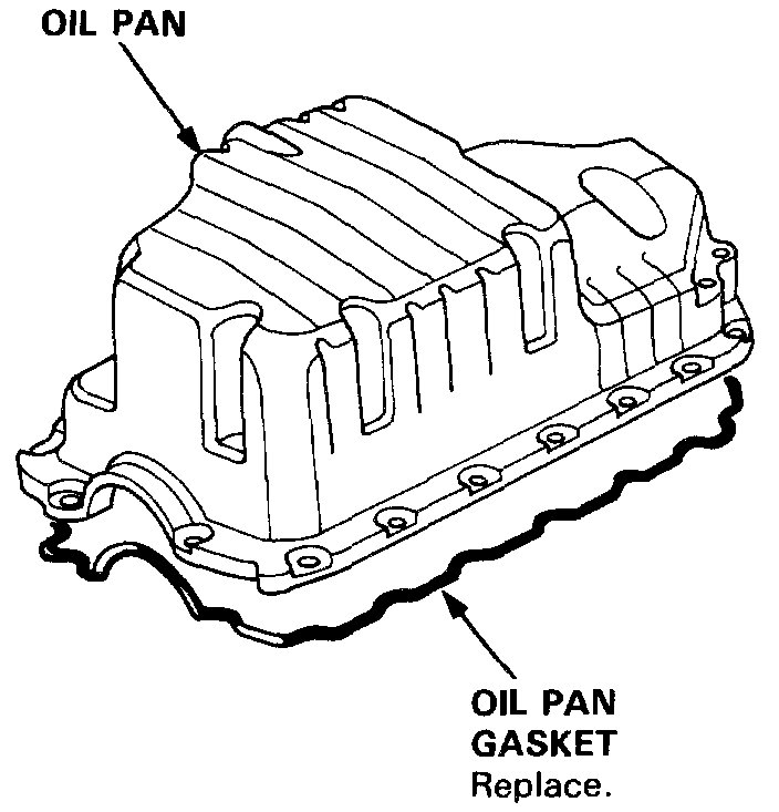

D16Y5, D16Y8 Engines:
Picture 4
1. Install the oil pan gasket on the oil pan.
2. Apply liquid gasket to the block mating surfaces of the oil pan, then install it. Apply liquid gasket to the shaded areas.
NOTE:
- Use liquid gasket part No. 08718-0001 or 08718-0003.
- To prevent leakage of oil, apply liquid gasket to the inner threads of the bolt holes.
Picture 5
3. Tighten nuts finger-tight at six points as shown.
Picture 6
4. Tighten all bolts and nuts, starting from nut (1), clockwise in three steps.
Torque: 12 Nm (1.2 kgs.cm, 8.7 ft.lbs.)
