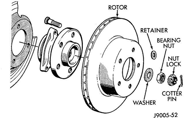

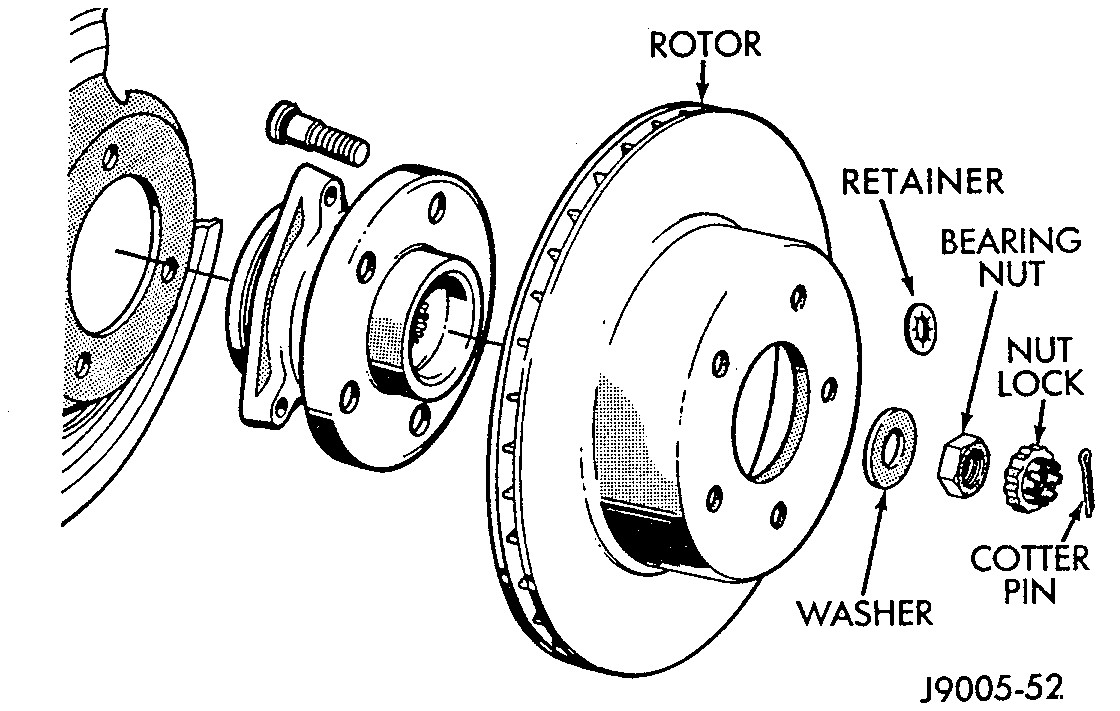

I have attached a picture for you to see. It is for replacing a front brake rotor, but it shows a stud and how it goes through the rear of the hub assembly. When you do this, you will need to remove the brake caliper and rotor. Then the hub is exposed. At that point, if the broken stud is still attached in the hub, take a hammer and punch and knock it out of the assembly.
Install the new stud through the rear of the hub. Now, it has to be fully seated which takes a good bit of pressure to pull it through. What I do is this. Pull it through as far as you can by hand. Next, place a flat washer on it and a small amount of grease on the flat washer. Then I use an air impact gun to tighten the lug nut against the lubricated flat washer which pulls the stud through the hub. You can do this with a wrench if you don't have the impact gun.
If the rear wheel is the problem, remove the brake drum and follow the same procedure. I will tell you it is difficult to position the new stud into the hub because of space, but it can be done.
