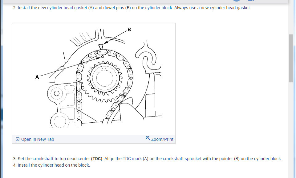

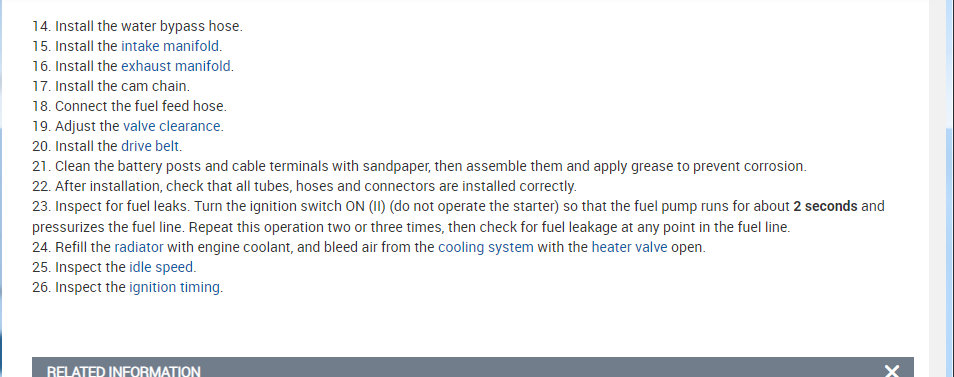

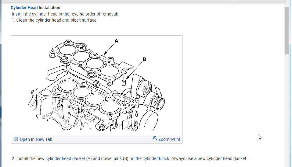

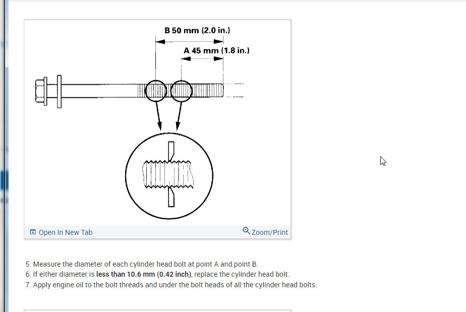

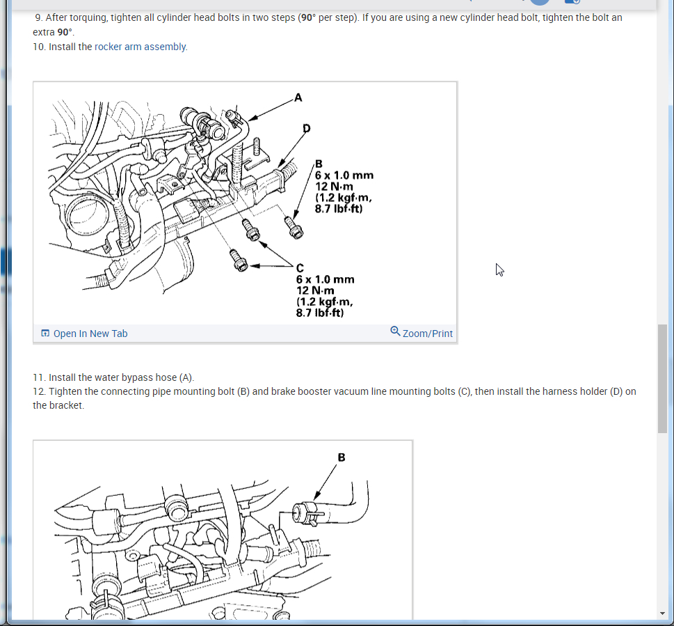

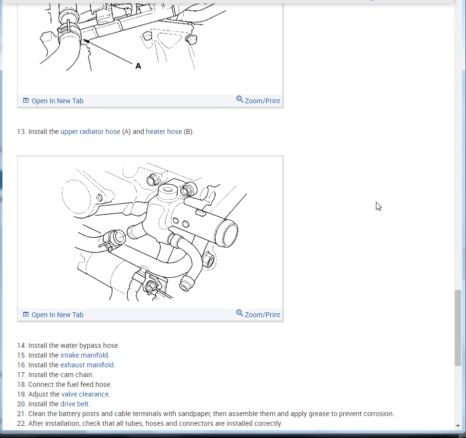

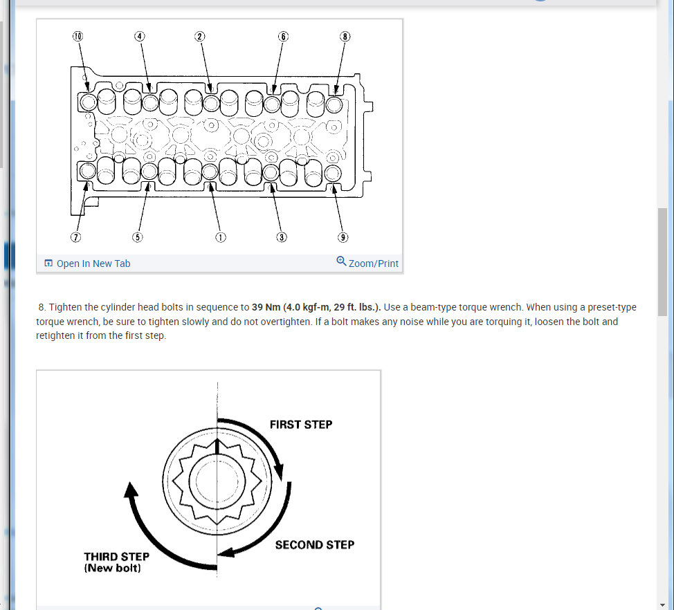

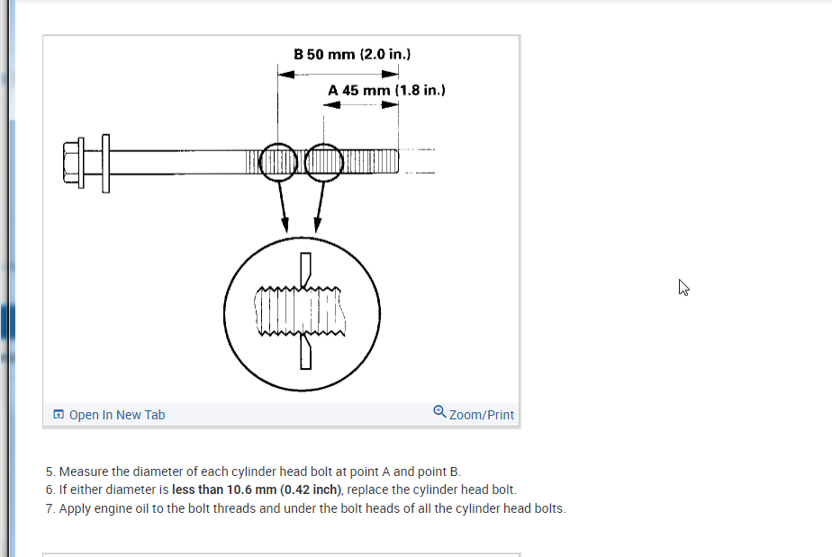

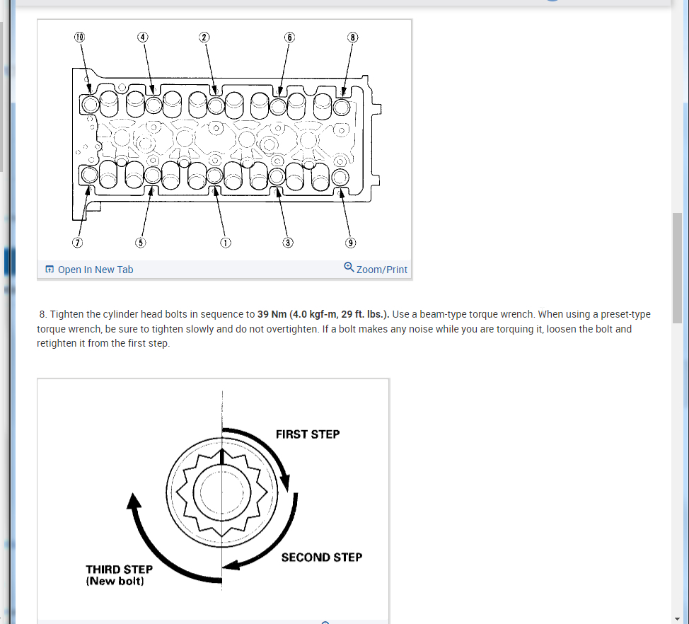

Here are the instructions for this but here is a guide that will help with how to test the head gasket in case you or someone else needs that in the future:
https://www.youtube.com/watch?v=5zpNjYmmiYY
Below is the process from the manual that will help as well.
Please let us know if you have other questions. Thanks
