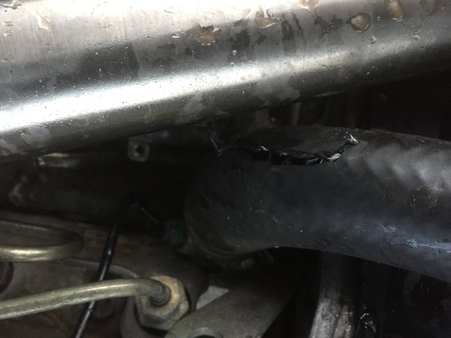

Was driving alone when a bang and smoke and it stalled on me to a stop. upon checking I have a four inch split in the top radiator pipe.

Replace both of the radiator hoses, then run a pressure check on the cooling system to be sure nothing else is leaking. The hose may have simply failed from age and the constant pressure in the system. The pressure test will show if there is another problem.
Dec 25, 2016 at 5:10 PM
JOHNNY G.JR
  • 320 POSTS
Check both heater hoses also, Have radiator cap pressure tested it might be faulty. A dye can be placed in cooling system and hard to find leaks can be detected with a black light, head gasket ,hose connections, heater core, radiator etc.

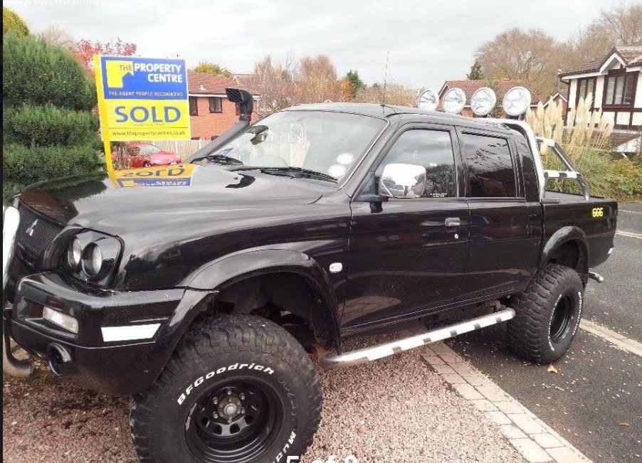

Nice truck. Hope it all works out.
