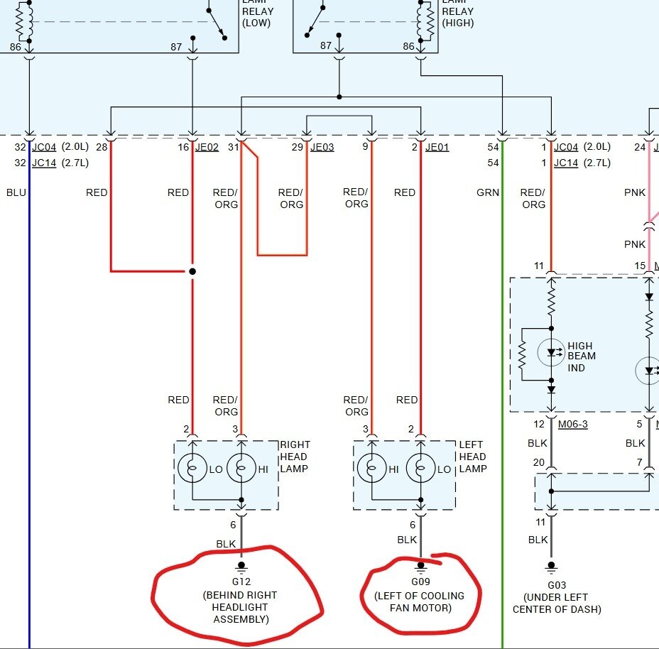

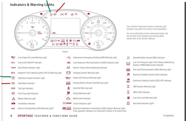

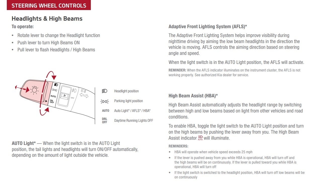

Could you verify which light and what position the light switch is in. That vehicle may have the automatic high beams and if it sees oncoming vehicles or excess light from street or reflected light it will dim them. There could be an issue in that system. When it happens do you know of any pattern, like it only happens when passing this building or it only happens if I lay a hat on the dash or anything like that?

Does this car have the automatic light option or DRLs? I don't see much that would cause this, unless one of the front lights were to have a bad or corroded ground circuit. That would try to turn on all the bulbs at the same time and light the high beam lamp in the dash as the current tried to find a path to ground. I would look at the black ground wires and where they are attached to the car body.

I would suspect the grounds more but both of those add extra pieces. The DRL especially could cause a similar issue.
