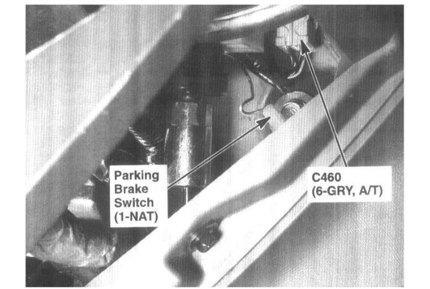

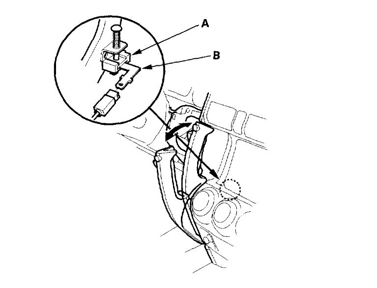

I attached a couple of pictures of the switch location.
The best way to test if the switch is bad is to disconnect the wire from the switch and see if it goes out.
