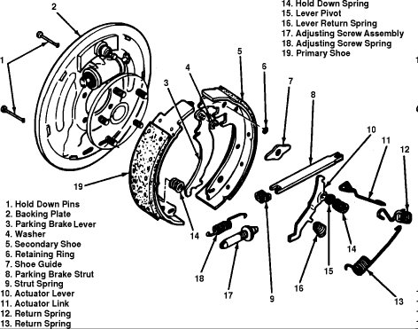

Here are specific directions for your vehicle. Additionally, I attached an exploded view of the brake system as a guide.

I hope this helps. If you find this is not the problem, there are no leaks, and everything is working properly, I would suspect the master cylinder has gone bad again. The air noise you hear can be normal due to increased pedal travel or you could have one of the following:
Leaking vacuum line.
Leaking vacuum booster diaphragm.
Damaged gasket silencer.
Master cylinder going bad allowing brake fluid to enter the booster.
I hope this helps. Let me know if you have other questions.
