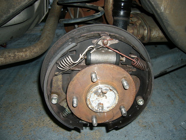

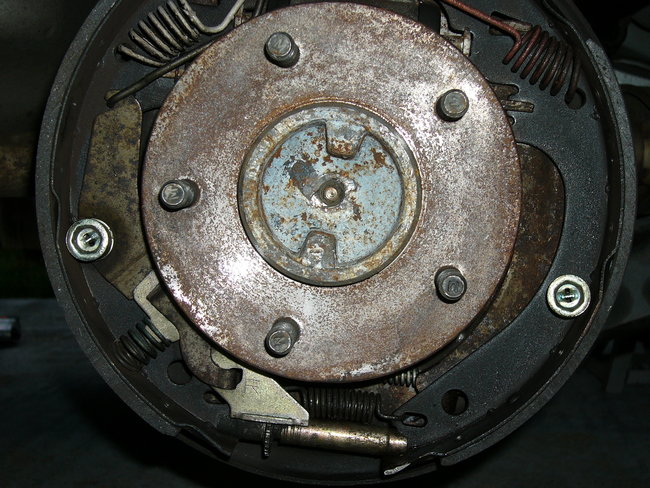

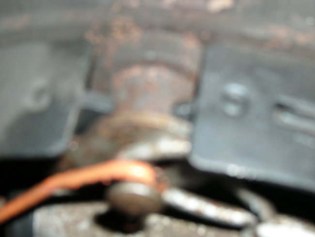

Ok, it finally stopped raining for a bit. Jacked up car and first thing i noticed taking off rear right hub is a lot of brake dust in the drum! It is the second brand new one and only has about 20 miles on it. Next inspected for leaks, all is dry. Both shoes are pulled up nicely against top pin, and yes there is some slack in that E-brake cross bar, rattle spring nice and solid and seated good. Had helper press parking brake and then release. Was interesting to watch, all worked and released. Now i pulled it apart and the rub points all appear to have been making contact, initially and now regreased with CRC brake grease. I also moved the brake cables in and out by hand with out any issues noted, felt free and smooth. FYI, for first 17 years car was a garage queen and only accumulated 32k miles. When i was doing the bleeding, fluid was very clear, slight gold tint to it and came out nice and strong.

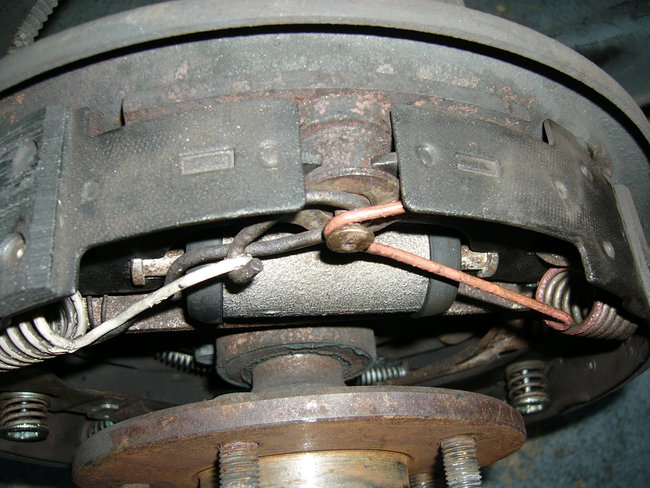

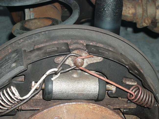

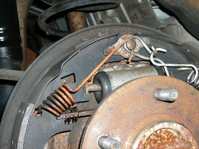

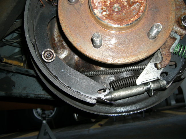

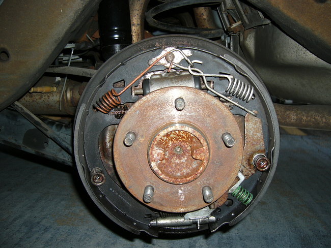

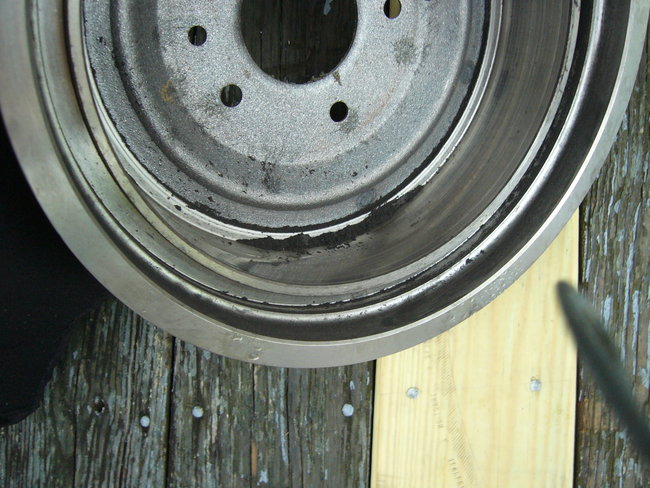

Starting to rain again, so here are some pics, maybe a "pic CAN be worth a 1000 words". 1-4 are left rear, 5-8 RR, and 9 is amount of brake dust from less than 20 miles, both sides are like this.

CARADIODOC
  • 34,306 POSTS
I don't see anything obvious. There's only two other things I can think of. The first is since you replaced the wheel cylinders, did you buy the correct diameter? Did you look at one of the old ones or go by what the person looked up at the auto parts store? On the old one the diameter is molded onto the inside of each rubber lip seal.

Fixed; I did have the original pistons to compare to however the two replacements are the same diameter. With that said, looking at the new shoes that I had just put on, both L and R sides seem to be falling apart as well as destroying the drums! best I can describe it is, have you ever seen a board drug across smooth dirt, but when it hits a rock, it creates a gouge that gets progressively worse until something gives. Well this was happening all over these shoes. Took them back and went with a different store and brand as well as another spring kit (although there was nothing wrong with the tension of the these ones I had just put on! lol). These new shoes do not have as much material on them and kind of resemble several layers of stacked hard pressed gray cardboard but, its been three days now, they have adjusted out and all is fine again.
I hate to throw names out there but the bad ones were: O'Reilly's BrakeBest Select Brake Shoes #462. the replacements are from Advance Auto, Wearever Brake Shoe #S462.
Thought this was funny, when returning them I showed the guy and he said "oh yea, they are shredding on you". I asked if this was a common thing, "no, never seen that before". Okay, never seen that before but you know what it is and you have a name for it, hummm.
