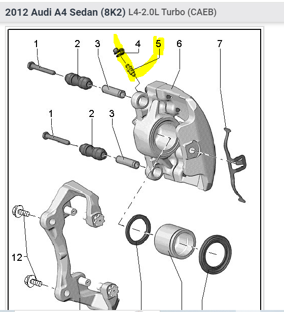

If you are getting excessive heat from the front right, do this:
Lift that wheel off the ground so you can turn it. Have a helper apply the brakes so it locks up. Have them release the brake pedal and see if you are able to turn the wheel. If you can't, open the bleeder on the brake caliper to see if the wheel can be turned. If it is, replace the rubber brake hose to the caliper. If there is no change, chances are it is a caliper issue.
I attached a pic below showing the bleeder location. Also, when you do this, just open it for a couple of seconds and then retighten it.
Let me know what you find.
See pic below.
