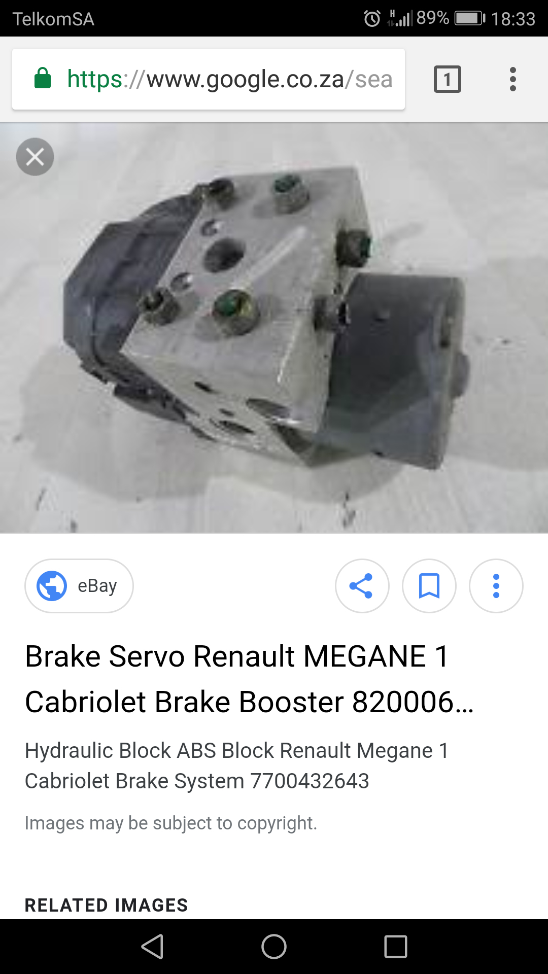

Hi, when I press my brake the car pulls to the left, upon inspection of the right front caliper I noted that the brake fluid has no pressure at the bleeder valve. I checked the rubber hose that is fine. I even checked the metal brake pipe that is clear. What I did was trace the metal pipe to the abs module what I did notice is that when I open the metal pipe from the ABS unit the brake fluid drips out. There is no pressure only for the right front all the other three work fine What can I do to resolve this issue? is there a way to bleed the module? I suspect a sticker valve or air in the unit. Will a complete brake flush. help.

The bleed will not help if there is no pressure. Can I ask you to run one test? Crack the brake line loose right before the flex line on the right front. Then have someone push the pedal down to see if anything comes out.
