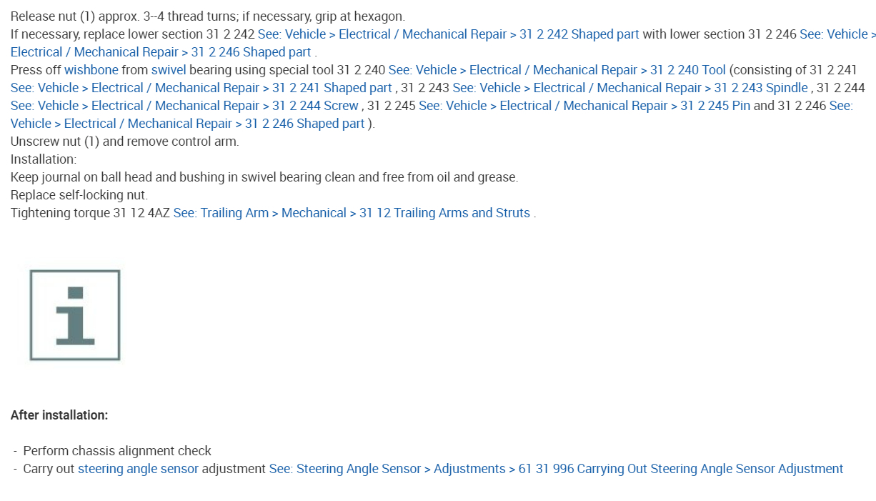

I bought this car with minor rust on it and it has been parked for a while. All rotors have rust on them and when you press the brakes there is a slight pull similar to when a lower control arm is bad. Changed front brakes/rotors on both front and lower control arm on one side. The noise from rotors is way less but the car goes to the right when I push the brakes. I greased all the pins in front. Can the rear cause such a pull?
