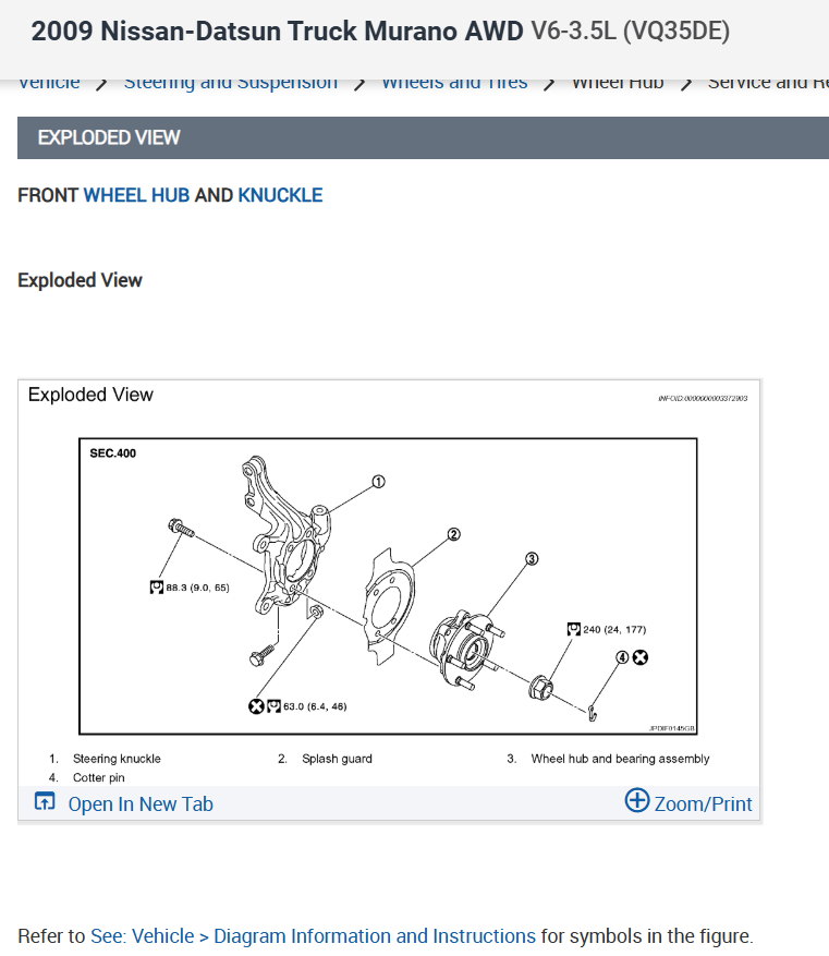

Every time I go in reverse and also i hear some grinding from the front left tire as I make a turn and it's scratcheing my rotor up badly.
Feb 20, 2025 at 8:20 PM
Okay, let's raise the front of the car to check the bearing hub, grasp the tire and try to move it back and forth, up and down to see if there is play in the bearing. If so, here is the part that needs to be replaced.
Check out the images (below). Let us know what you find.
