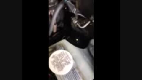

Here is a video. Over the shingles, woohoo.

Ken is who ask for a video to listen and see the brake system.
We returned the defective accumulator and yesterday received the replacement. It was installed yesterday and the brakes still will not pump up.
Seems like everything is working but pumping the brakes for pressure.
Maybe the attached video will give you an idea of what we need to do. Brake lines have been bled. We even opened the calipers on the rear brakes and let them drip for 15 mins and then did the same on the front, keeping the reservoir full at all times.
Help if you can. Is there a code that needs to be changed or maybe a check valve or something we missed?

Does this car have ABS? if so you will need a scan tool to open the ABS valve while bleeding to remove the air from the system. This guide should help:
https://www.2carpros.com/articles/brake-pedal-goes-to-the-floor
